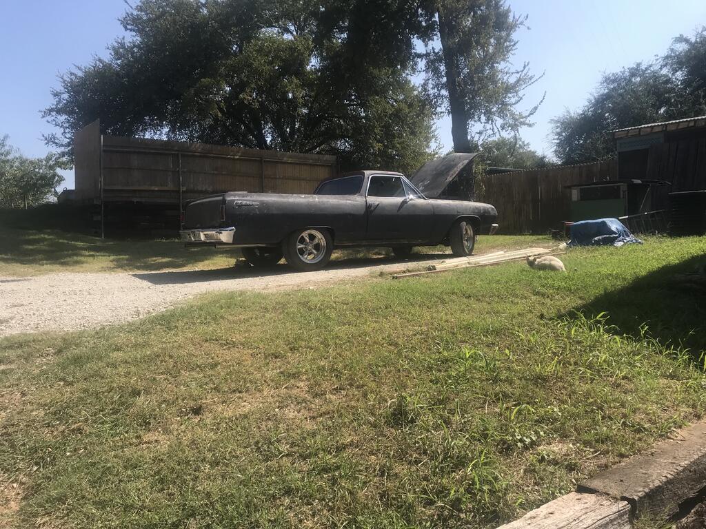

ZXT 2,402 #155 Posted October 5, 2020 Took the El Camino on its maiden voyage today. Was having hell getting the drive by wire throttle working. Pedal tested out good, as did the throttle control module, and throttle body/TPS. Still no throttle. Went to the local salvage yard that i frequent and got another pedal and throttle control module. No change. He didn't have another throttle body, and I was at my wits end so I bit the bullet and went to oreillys and bought a new throttle position sensor. Bolted it on the throttle body and all is good! Drove it down to my family's river place, about 15 miles each way as a shakedown run. Did great! Way more power than the 350 that came out of it was making! Now I just need to do something about the body.. 2 3 2 Share this post Link to post Share on other sites

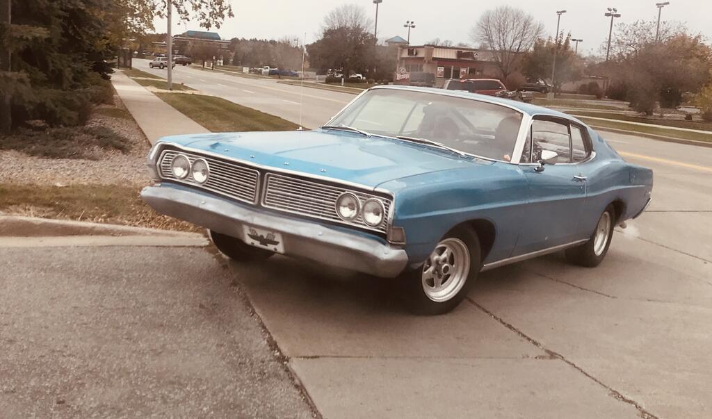

PeacemakerJack 11,059 #156 Posted October 19, 2020 Unfortunately we have reached the end of the hot rod season here in east central WI however, there are a few guys still getting a last run or two before putting their babies to sleep for the season. i saw this beauty on a run to the local lumberyard... whatcha think my blue oval buddies? 5 Share this post Link to post Share on other sites

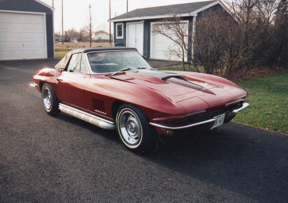

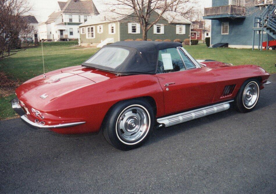

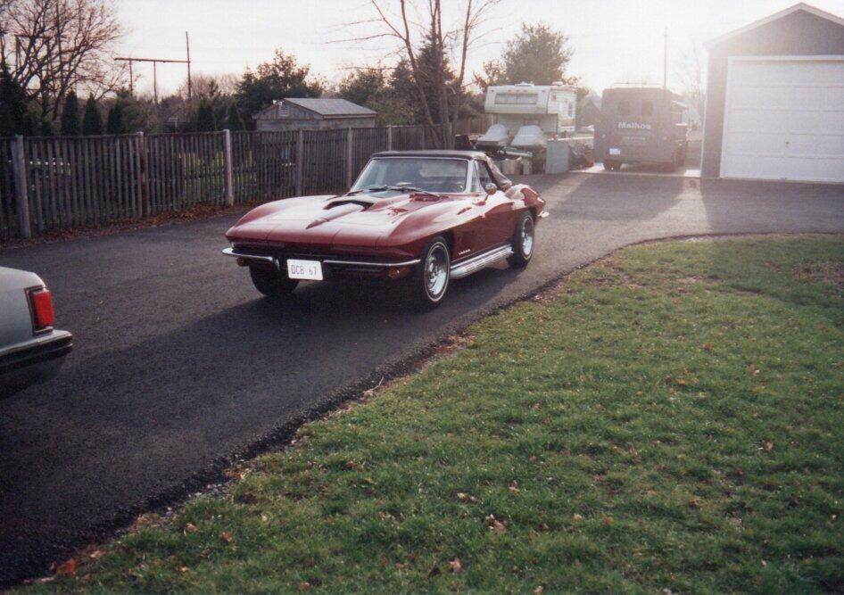

JCM 11,415 #158 Posted December 5, 2020 First picture is my old 70 SS with a good friends Restored 1958 Corvette and another friends Restored 1967 Corvette 427 that received a NCRS Top Flight Award in Carlisle PA meet in August of 1995. 4 Share this post Link to post Share on other sites

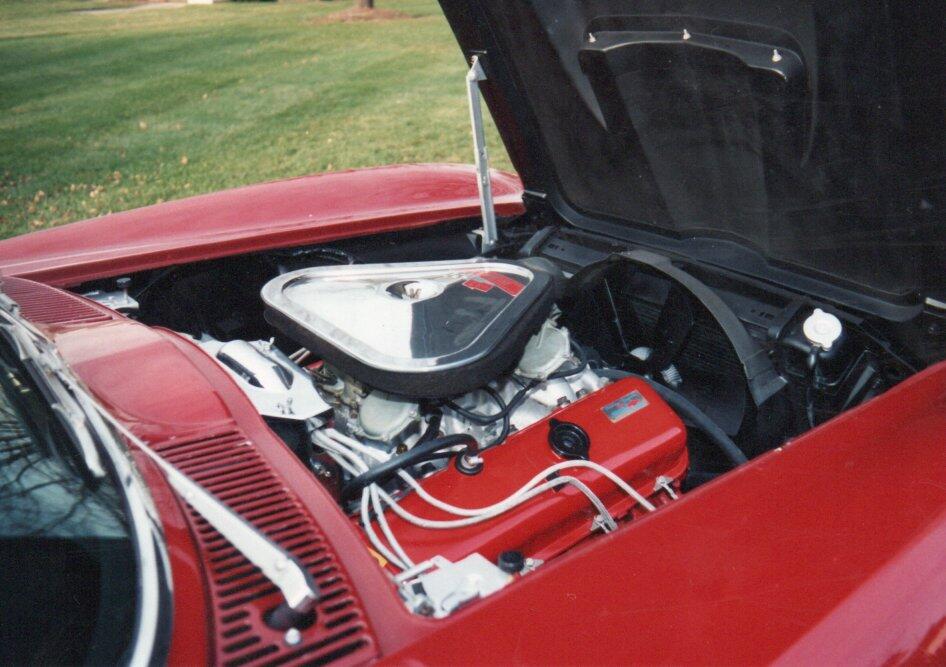

ebinmaine 80,507 #159 Posted December 5, 2020 Something about a 427 Tri-power.... 1 Share this post Link to post Share on other sites
JCM 11,415 #160 Posted December 5, 2020 (edited) No Tri power on that one Eric, single 4 bbl = RPO L36 427 Hydraulic lifters 390 HP. I had the chance to drive that after resto. NICE. It does look like 2 4 barrels but I do not remember it having 2. Edited December 5, 2020 by JCM Share this post Link to post Share on other sites

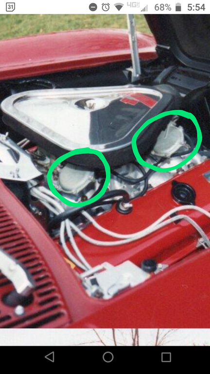

ebinmaine 80,507 #161 Posted December 5, 2020 9 minutes ago, JCM said: No Tri power on that one Eric, single 4 bbl = RPO L36 427 Hydraulic lifters 390 HP. I had the chance to drive that after resto. NICE. It does look like 2 4 barrels but I do not remember it having 2. I'm thinking the circled items are the vacuum valves to open the outside (2+2) barrels/carbs ..... No? Sure does look like a carb colored item right at the back of the air cleaner close to the distributor. Share this post Link to post Share on other sites
JCM 11,415 #162 Posted December 5, 2020 I'm thinking when he bought this car it had the single round air cleaner and then when he decided to have NCRS judge it they may have found it needed the tri power set up and corrected it upon full restoration. I agree with the vaccum and air cleaner set up. This pic was taken around 1990. 1 Share this post Link to post Share on other sites
ebinmaine 80,507 #163 Posted December 5, 2020 4 minutes ago, JCM said: I'm thinking when he bought this car it had the single round air cleaner and then when he decided to have NCRS judge it they may have found it needed the tri power set up and corrected it upon full restoration. I agree with the vaccum and air cleaner set up. This pic was taken around 1990. Think that engine'd fit a C-series chassis?? Wheelhorse C 4350. 1 1 Share this post Link to post Share on other sites

tom2p 2,396 #165 Posted December 8, 2020 On 12/4/2020 at 10:35 PM, JCM said: First picture is my old 70 SS with a good friends Restored 1958 Corvette and another friends Restored 1967 Corvette 427 that received a NCRS Top Flight Award in Carlisle PA meet in August of 1995. had a friend with a similar looking 66 or 67 Corvette - his was maroon in color and a 427 tri-power a neighbor and owner of an area Esso / Exxon service station I worked at had a 60 Corvette conv he restored ... it was powder blue with white ... 283 3 speed ... can't recall a manual trans / shifter that shifted as easy as that car did - you could almost flick the shifter ball with the end of your finger to shift into a gear ... that Corvette was one of my fav cars of all time ; not overly fast - just a blast to drive and simple (especially compared to the next generation) 70 SS Chevelle was prob my fav muscle cars to drive ... great looking car inside and out - great feel and they actually handled decent for a car that size back in the day ... I had two - both dark green .. low/med horse big blocks with a 4 speed ... one with bench seat and the other with buckets, factory console and gauges, etc 1 1 Share this post Link to post Share on other sites

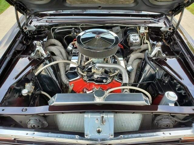

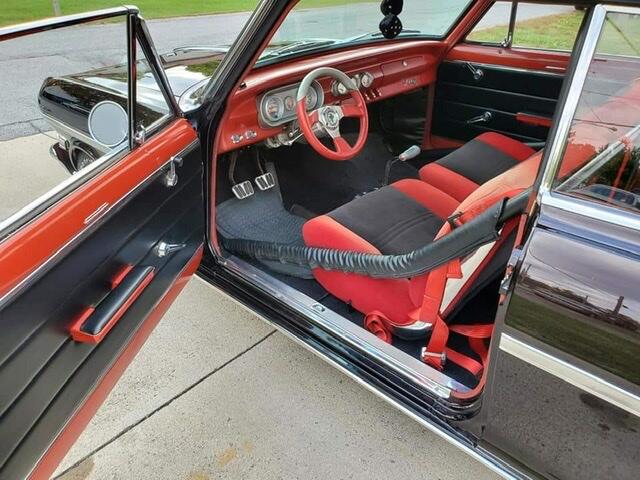

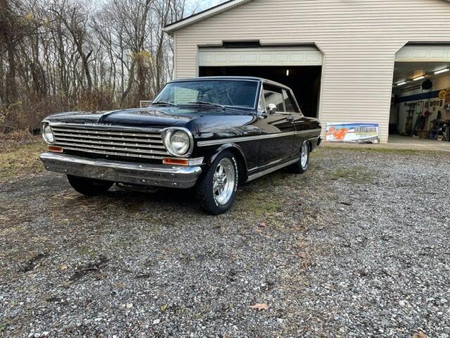

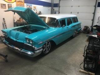

tom2p 2,396 #166 Posted December 8, 2020 On 5/1/2020 at 1:09 AM, tom2p said: neighbor replaced old rod with the wagon my neighbor traded the wagon for a Nova / Chevy II 2 1 Share this post Link to post Share on other sites
tom2p 2,396 #167 Posted December 8, 2020 (edited) 8 minutes ago, tom2p said: my neighbor traded the wagon for a Nova / Chevy II he's already ripping it apart - transforming it into a gasser with a tube axle Edited December 8, 2020 by tom2p 1 1 Share this post Link to post Share on other sites

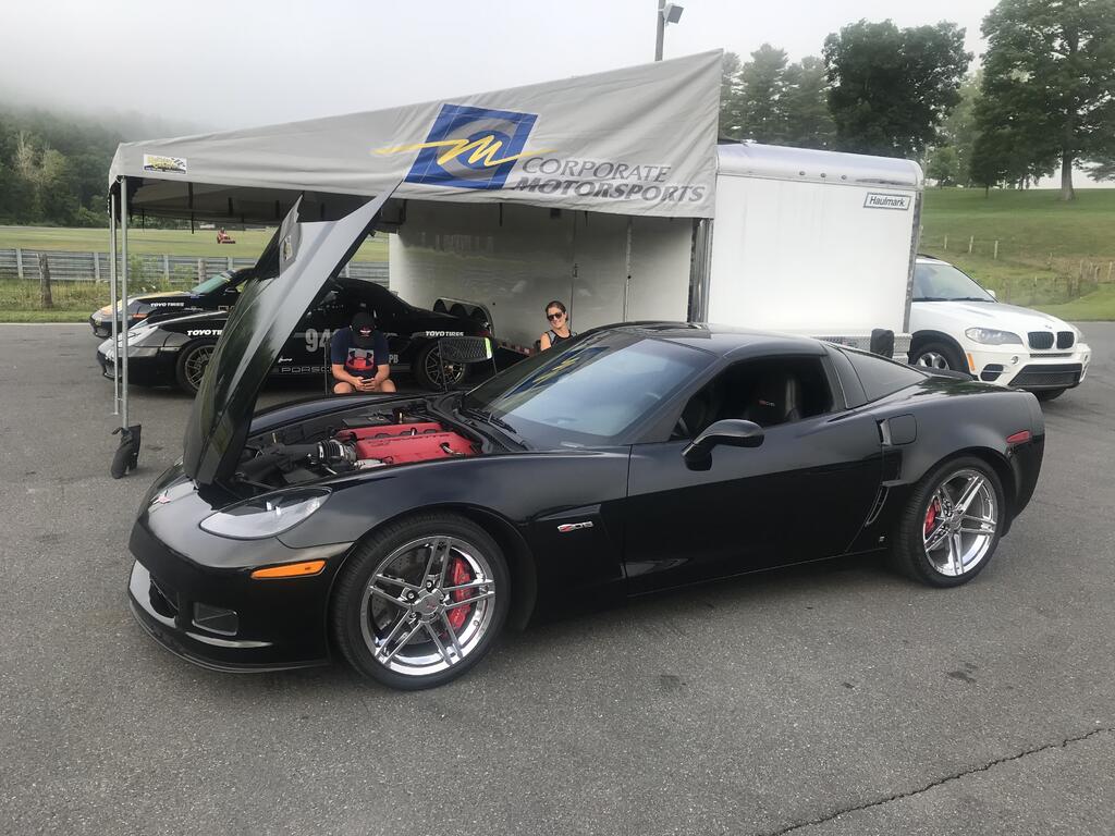

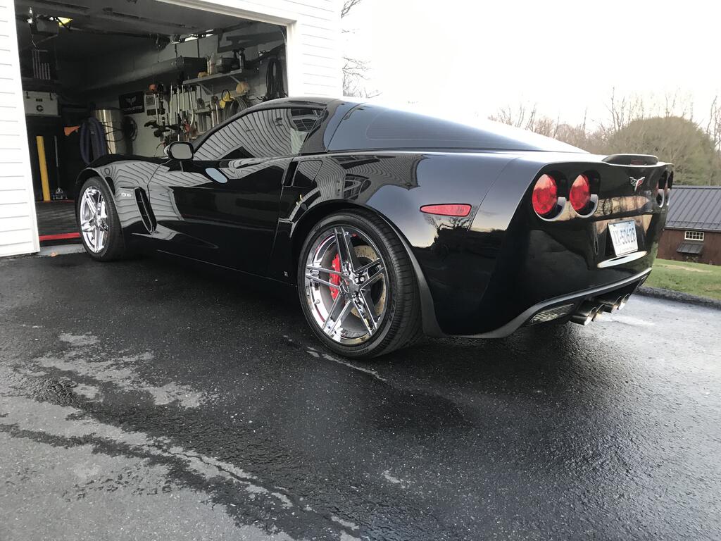

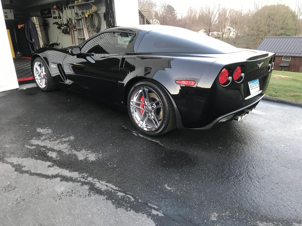

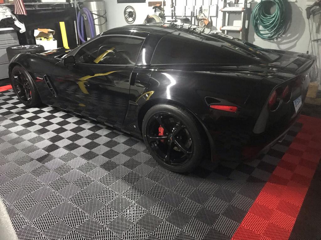

stevebo-(Moderator) 8,742 #168 Posted December 8, 2020 This is my hot rod. 505hp bone stock!! 5 1 Share this post Link to post Share on other sites

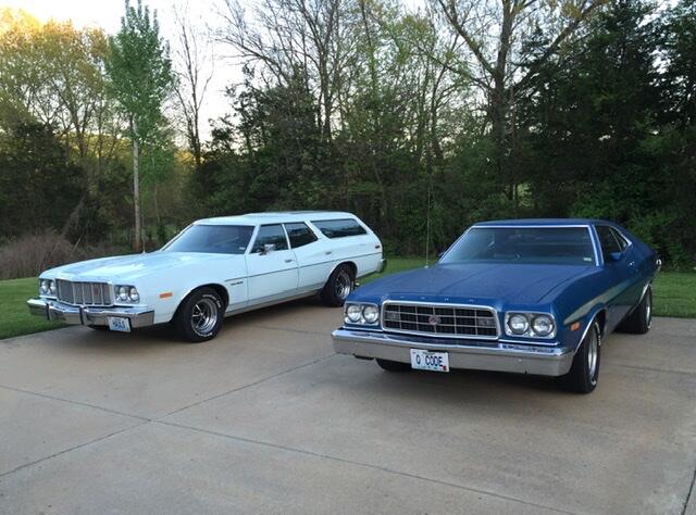

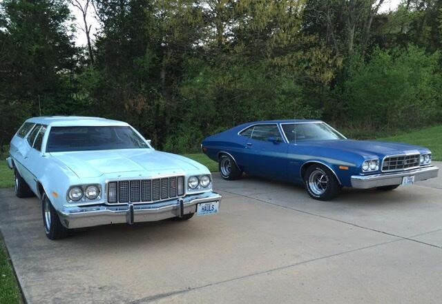

cschannuth 3,821 #169 Posted December 8, 2020 (edited) I’m a Ford guy but thought old mustangs were dime a dozen. One of my buddies had these two Torino‘s for years and when it was time to sell, he gave me first crack at them. He was asking a ridiculously low price so my wife actually agreed. The fastback is a four-speed bench seat car with the 351 Cleveland cobra jet. The wagon also had a tamed version of the 351 Cleveland in it. They were both too big and heavy to be very fast but they were tons of fun to drive. I had them for about 15 years when somebody in one of my Torino forums saw some pictures of them both and had to have them. I really wasn’t interested in selling them so I shot him an outrageous number and the crazy dude said OK and so now they are his. About the same time my neighbor bought his wife a brand new Mustang GT with a six speed in it. She never got along with it so they decided to sell it a couple years later and buy her one with an automatic. I also sold the police interceptor that I bought for cheap and fixed up a bit. Between that and the Torino money I was able to buy my neighbors pristine mustang GT with 4000 miles on it. Sometimes even a blind squirrel finds a nut. Edited December 8, 2020 by cschannuth 6 3 Share this post Link to post Share on other sites

Pullstart 71,186 #175 Posted December 12, 2020 On 12/7/2020 at 9:49 PM, stevebo said: This is my hot rod. 505hp bone stock!! What a difference a set of wheels will do for a car... I like the black ones the most, but sweet ride either way 1 Share this post Link to post Share on other sites
