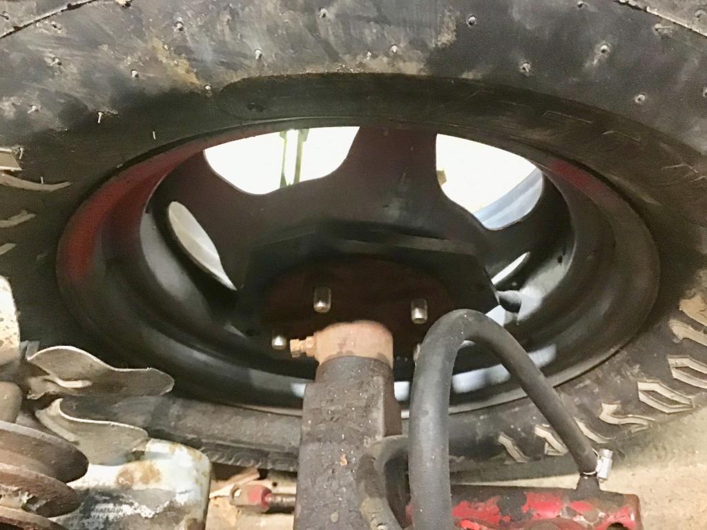

Pullstart 71,561 #318 Posted February 7, 2020 Ok, here’s where I’m at as far as parts on hand go. I have an entire ‘96 Subaru Outback Impreza for brakes if needed. I plan to pull the engine, transmission and wiring harness, then scrap the rest. The wheels measure roughly 5 on 4”, so my guess is 5 on 100mm. I could likely chuck them up on the rotary table jig, indicate my centers and drill new holes... then figure out if I want to do a hydraulic brake setup or gut the calipers and build a mechanical / spring loaded brake system. I have an 80’s 3/4 ton Chevy straight axle. Too heavy duty in my mind. I have a pair of Wheel Horse brake setups off 3 speeds. I could likely build a simple setup by building drums on the inside of my wheel adapters and adding mounting brackets to a plow/tiller bracket mounted to the axle. I think this is the simplest option... plus it’s Wheel Horse parts. 1 Share this post Link to post Share on other sites

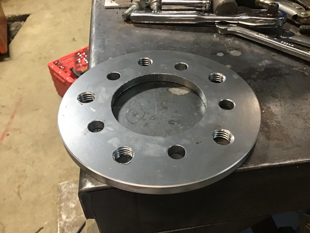

Pullstart 71,561 #319 Posted February 7, 2020 Here is a picture of my adapter mounted up before I turned it down. They are just a bit larger than the hub, maybe by 1/2” overall diameter. The drums could be welded directly to the adapters and be trued in the lathe, plus slide right over the hubs. 2 Share this post Link to post Share on other sites
ebinmaine 81,282 #320 Posted February 7, 2020 13 minutes ago, pullstart said: have a pair of Wheel Horse brake setups off 3 speeds. I could likely build a simple setup by building drums on the inside of my wheel adapters and adding mounting brackets to a plow/tiller bracket mounted to the axle. I think this is the simplest option... plus it’s Wheel Horse parts I like this option for simplicity and keeping it 'horse.. Share this post Link to post Share on other sites

953 nut 70,656 #322 Posted February 7, 2020 Another break option could be a pair of brake drums turned inward and a singe break shoe in each operated mechanically. That is how it was done on the Pennsylvania Panzer tractors. 1 1 Share this post Link to post Share on other sites

oilwell1415 563 #324 Posted February 7, 2020 13 hours ago, pullstart said: The drums could be welded directly to the adapters and be trued in the lathe, plus slide right over the hubs. I think you're making things more difficult than they need to be. If you get a drum or rotor with a 5x4.5 bolt patter you can just put them on the hub under the spacer. If you've got Subaru brakes available you could use the calipers from those and just find a rotor that will work. You just have to get something about the same diameter and thickness, but most of them are pretty close to the same. Share this post Link to post Share on other sites

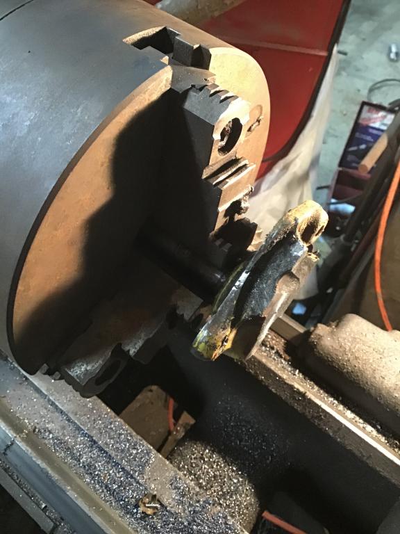

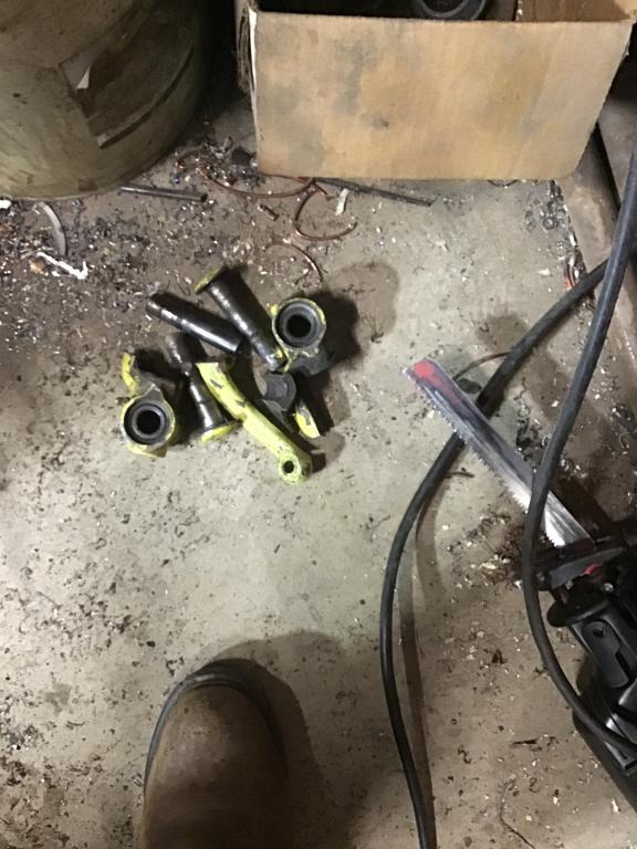

Pullstart 71,561 #325 Posted February 12, 2020 I’m out hacking on these VW spindles, hoping to get something I can weld to a set of WH spindles ‘fore too long. 1 Share this post Link to post Share on other sites
