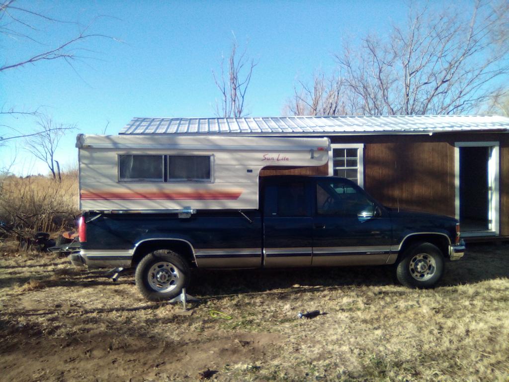

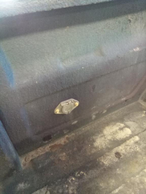

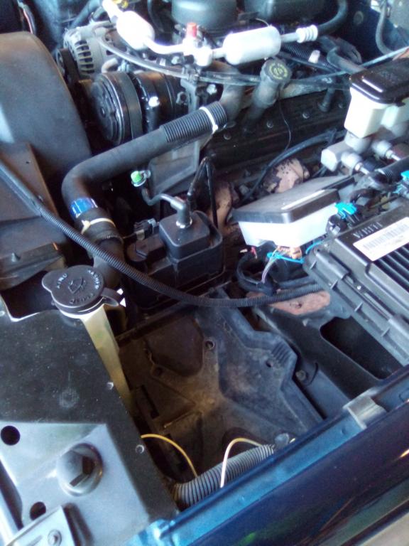

ClassicTractorProfessor 5,455 #1 Posted January 3, 2020 As most of you already know my main reason for purchasing the new truck was to haul my camper in. I have an idea of something I want to do, but my brain is not letting me come up with a solution. I'm probably overthinking a simple setup, but here goes. On my F150 whenever I loaded the camper I just set the battery inside the bed directly in front of the left wheel well and hooked the wiring directly to it. Since this new truck is going to be the dedicated camp rig I would like to do something a bit more permanent. What I'm wanting to do is install my camper battery under the hood in the auxiliary battery box and run my electric back to a plug in the bed. This will allow me to just plug the camper in when I load it and simply unplug it when not needed, as well as have the marker lights on the camper working with the switch for the marker lights on the truck. That part I have figured out without any problems. Where it gets tricky for me is I want to have the auxiliary battery connected where it will charge off the alternator when driving down the road, but I want it isolated from the truck battery so as not to run the risk of draining it and leaving us stranded somewhere. What is the simplest and most cost effective way to do this. I know it can be done as my 1991 Tioga RV is wired that way, but space is so limited under the hood I really can't see how they have everything hooked up Share this post Link to post Share on other sites

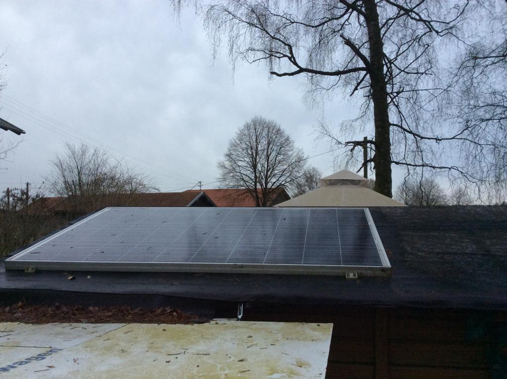

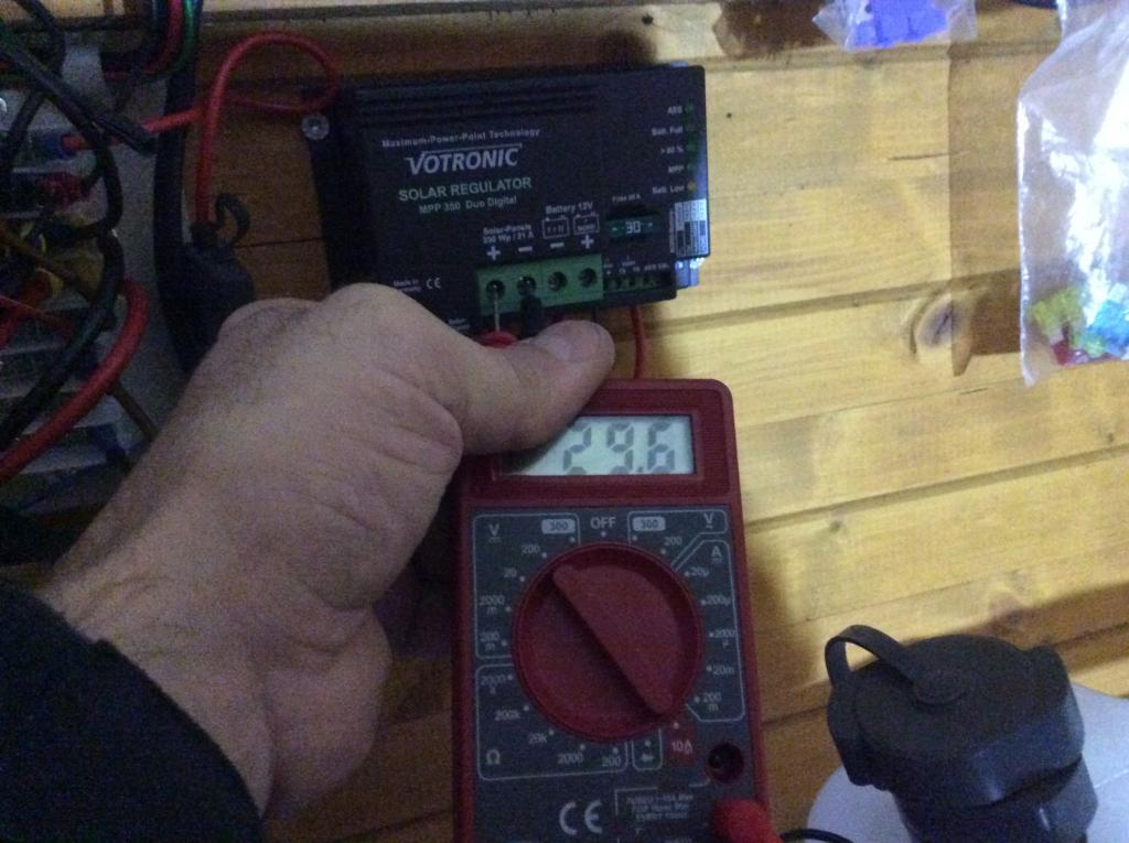

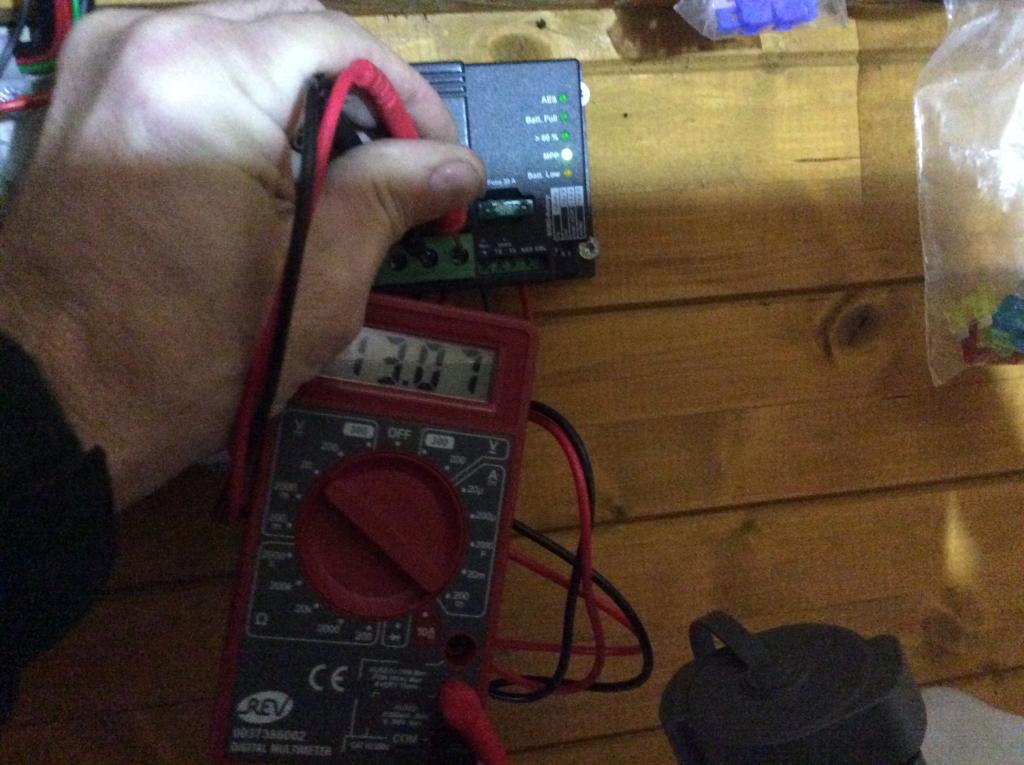

Tractorhead 9,218 #12 Posted January 4, 2020 Thanks for the Flowers Kevin..😎 ok, to show you what i meant with Solar,i was short in my Barn, to give you an idea about Solarcharging in Winter. firstly, i have absolutely no Sun here it is 15:45 at Cloudy Heaven. My Solarpanel is a Housepanel with 250W in Peak, my Battery was a Gel Type with 120Ah. i had an Inverter continousely running in Standby with a drop of 1A about. And few Lights with motiondetector. i just do a few Voltage measuring, because the Charge depending on time. firstly the Battery Voltage measured on the Solar Regulator as you can see, the Battery is fully Charged in idle with and the second Charging for startbattery i using outside, to keep Motocycle batt in working condition. that‘s a very handy installation. This second charging output you can use for the Truck Battery. now we have a closer look at the Cell Voltage and as you can see, even in weak light, i got more as needed to charge a Battery. that means in fact, the Solarcharger handles the drop of the Inverter, and the balance is even now still in positive. this System runs now for 10years in that combination, still with all components. No batterychange until now. I just moved the whole system with all components about 5years ago from my RV to the Shed, because i sold my RV. 1 Share this post Link to post Share on other sites
