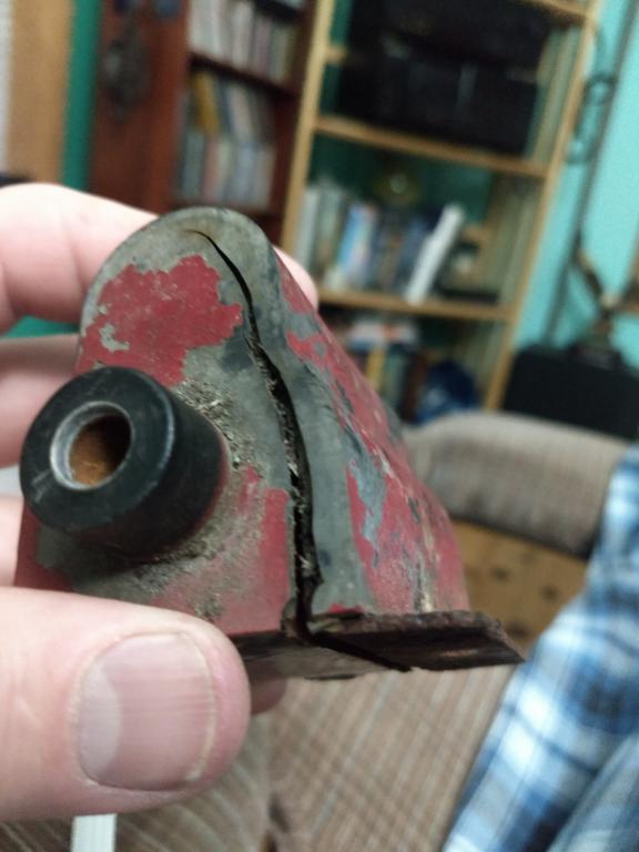

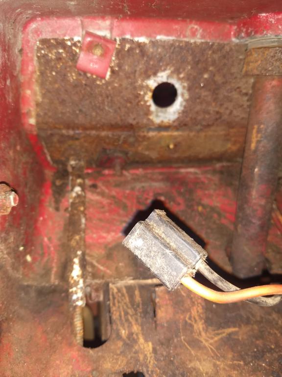

ebinmaine 79,595 #79 Posted January 13, 2020 Spent a bunch of time organizing and cleaning up the outdoor workshop the past two days. Some much needed space cleared out. Got the 1267 mongrel taken apart. Needed some of that for Colossus and some for this Charger. I was able to work on the Charger a little bit this afternoon. General cleaning, a little disassembly. A little spray penetrant. Oiled up the hydro control. I removed the nasty seat, bad coil, and frozen carb. Any thoughts on why this is bad? Carb and coil gone. Some surfaces cleaned up. Here's the frozen carb. I'm going to put it in the carb soak kit for a week or so and see if it frees up. It appears to be an original Kohler carb and I'd like to save it. Rodent hotel between the gas tank and ignition switch. This under seat box was literally half full with nuts and seeds. Some squirrel is really gonna be peaved when they see I have it all.. Seat is nearly ..... A moss farm? Water and rust stains from the almost new seat. When I get freed up again I'll take out the gas tank and clean back there. I'll need to find a key and test this ignition switch. Throw a few new wires on then see if I can find some spark. 1 2 1 Share this post Link to post Share on other sites
ZXT 2,402 #80 Posted January 13, 2020 1 minute ago, ebinmaine said: Any thoughts on why this is bad? That's so water can get in to aid with cooling! Some water must've leaked in and then it froze and split. 1 1 Share this post Link to post Share on other sites
pfrederi 20,837 #81 Posted January 13, 2020 (edited) Should just be a standard indak key. You switch should have two heavy wires screw terminal and a three prong plastic push on for the rest. If you need keys or a whole switch got you covered. You have a new coil don't you ?? Edited January 13, 2020 by pfrederi 1 Share this post Link to post Share on other sites
ebinmaine 79,595 #82 Posted January 13, 2020 1 minute ago, pfrederi said: Should just be a standard indak key. You switch should have two heavy wires screw terminal and a three prong plastic push on for the rest. If you need keys or a whole switch got you covered. Sounds right from what I can see through the nest. I'll pop it out and do some testing to make sure it works and feels ok. Thanks for the parts offer Paul. Share this post Link to post Share on other sites

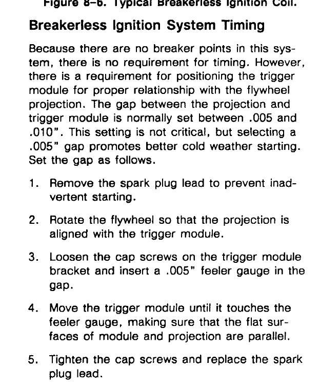

pfrederi 20,837 #98 Posted January 20, 2020 Great. No points to clean no timing to adjust simple is good. Being cold up there i would set the trigger close to the .005. i do it on mine as they are mostly snow horses. 1 1 Share this post Link to post Share on other sites
ebinmaine 79,595 #99 Posted January 20, 2020 17 minutes ago, pfrederi said: mostly snow horses I'm going to be using this one year round although nowhere near as much in the warm season. Does that affect the setting? Share this post Link to post Share on other sites
pfrederi 20,837 #100 Posted January 20, 2020 3 minutes ago, ebinmaine said: I'm going to be using this one year round although nowhere near as much in the warm season. Does that affect the setting? One of my breakerless is on loan to a neighbor he only mows with it. I think I had it set at .006 or a bit more. Runs fine I am not sure that it makes a significant difference. Manual really doesn't enlighten us as to why closer is better in the cold. 1 Share this post Link to post Share on other sites
