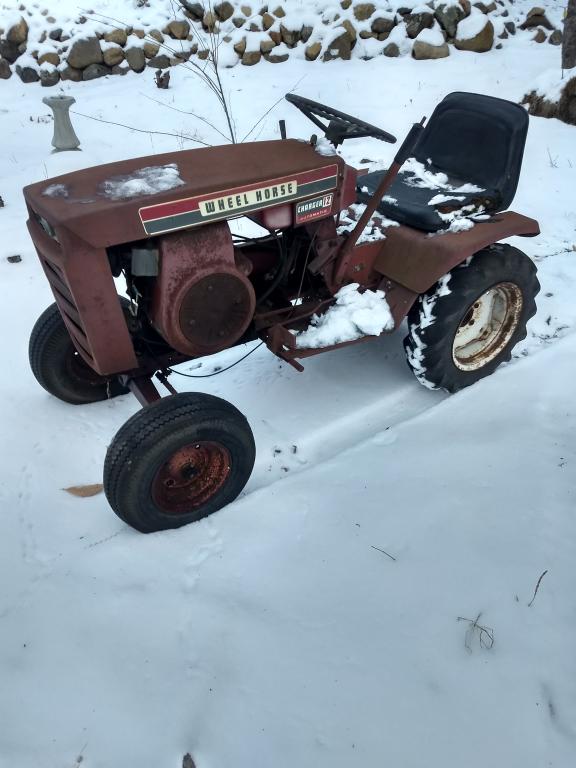

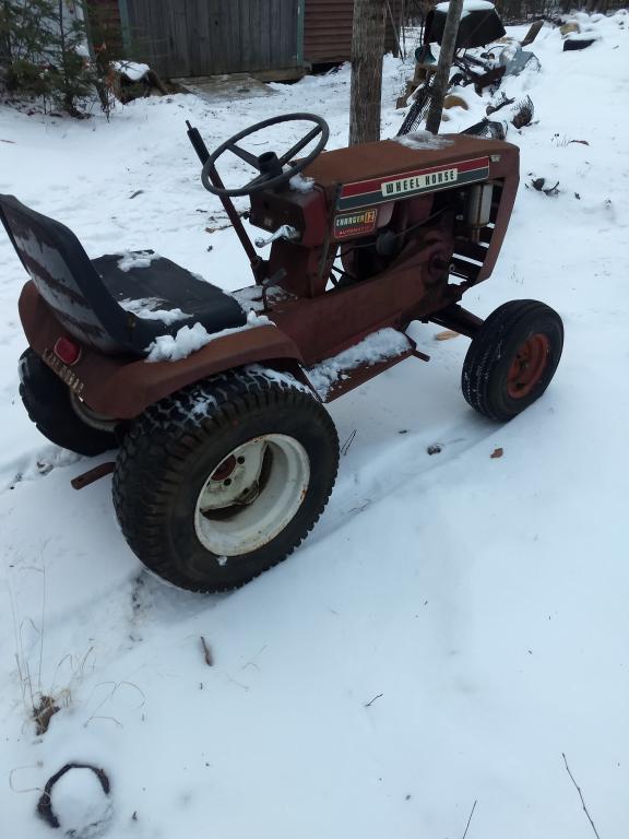

ebinmaine 81,047 #1 Posted December 22, 2019 I've been thinking about picking up a hydro of some sort for at least a year. I'm curious to see what it's like to plow snow with one. This one was found by @Stepney Spenser. Near as he can figure it's a 1970 model year. It needs a changeover from a bad module to a Points ignition system. From there some wiring and a test drive to see how the transmission performs. If all goes well up til then I'll take apart the transmission and change axles and hubs on both sides. Then see where we go..... 5 9 1 Share this post Link to post Share on other sites
Stepney 2,356 #2 Posted December 22, 2019 Trans had fluid in it when I had looked. I'd drain it before attempting to drive and change the filter. Who knows how long it's been sitting. 25+ years is what the PO told me. 1 Share this post Link to post Share on other sites

AHS 1,703 #22 Posted December 22, 2019 That’s pretty good to have the original coil! My 1970 already has points and the round coil. That must have not been used much!👍 1 Share this post Link to post Share on other sites
ebinmaine 81,047 #23 Posted December 22, 2019 4 minutes ago, AHS said: That’s pretty good to have the original coil! My 1970 already has points and the round coil. That must have not been used much!👍 It's there but not functioning. Cracked top has let in water and become rusted. I have the parts to change over to a Points ignition. The machine in general does likely have low hours considering the length of the time it was unused. 2 Share this post Link to post Share on other sites
oliver2-44 11,791 #24 Posted December 22, 2019 Congratulations, nice Charger In your cold area it will be interesting to see if you need a magnetic block heater on the transmission 1 1 Share this post Link to post Share on other sites
Stepney 2,356 #25 Posted December 22, 2019 1 minute ago, oliver2-44 said: In your cold area it will be interesting to see if you need a magnetic block heater on the transmission I have a pair of autos I keep running in the winter, one with an Eaton 11 and one with an old ATF sundstrand like this one. The Eaton takes a solid 5 minutes before it'll consider moving. My '68 will lift and drive as soon as the engine is running. Maybe it's the thinner oil? 2 Share this post Link to post Share on other sites
