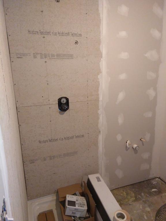

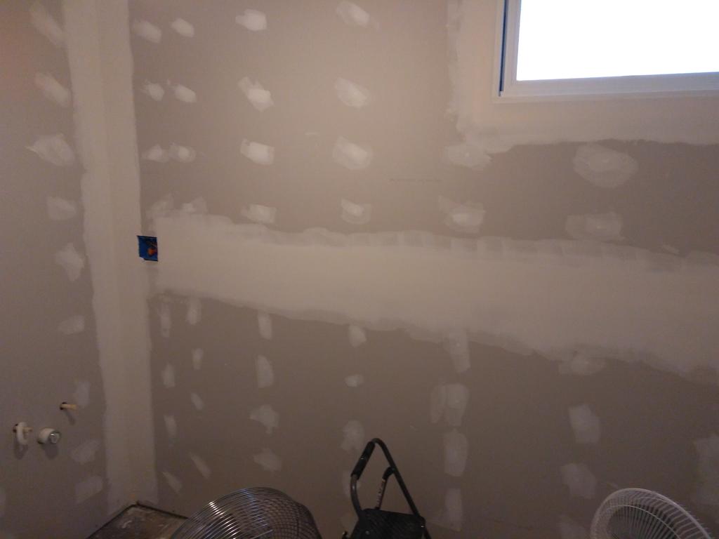

rmaynard 16,912 #70 Posted March 17, 2020 Remodeling is fun. While the pole building is going up, the wife has me remodeling the basement bathroom. Cement board and drywall are up. Waiting on corners to dry so I can do the final skim coat. Meanwhile, the concrete is setting up in the pole building and I must get more pictures... 3 Share this post Link to post Share on other sites
