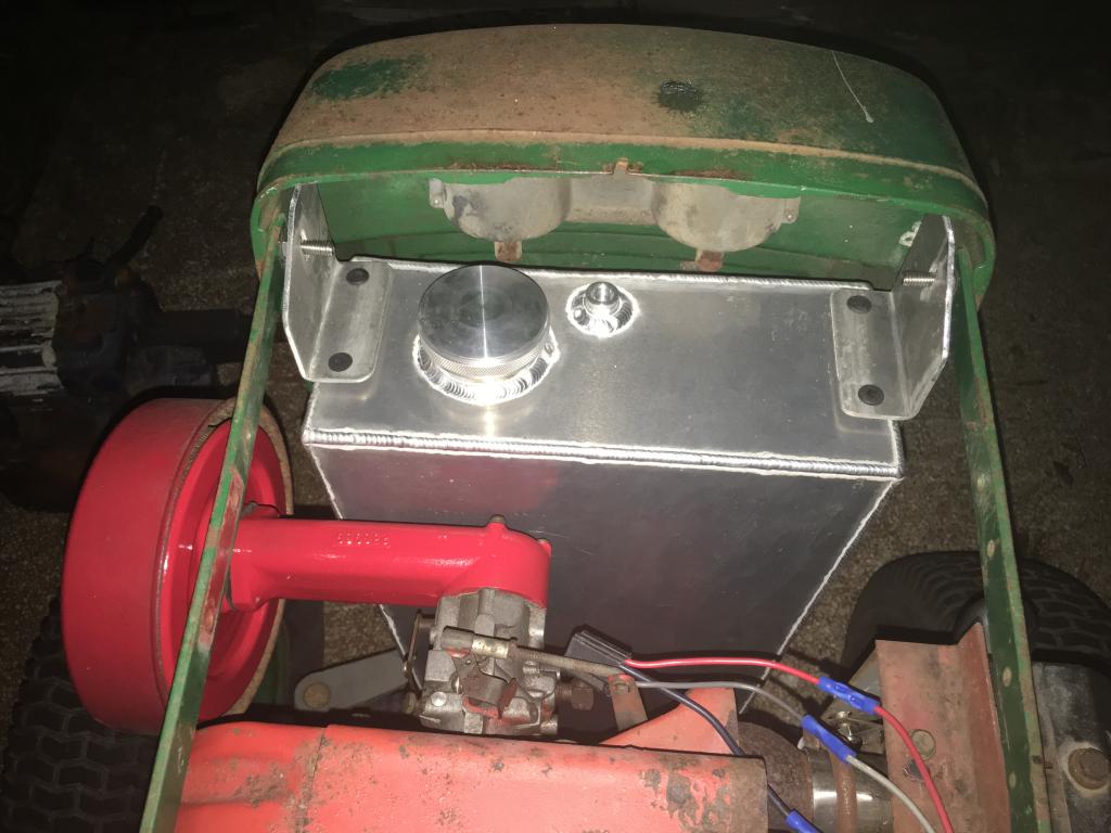

ZXT 2,402 #7 Posted December 1, 2019 1 hour ago, Aldon said: Then I plan on installing aluminum gas Tank that @19richie66 son made up for me on my GT16 restomod. Any pictures of this? I'd like to see what it looks like! Has to be a vast improvement over the garbage plastic tank! Share this post Link to post Share on other sites
Aldon 4,832 #8 Posted December 1, 2019 5 minutes ago, ZXT said: Any pictures of this? I'd like to see what it looks like! Has to be a vast improvement over the garbage plastic tank! I believe Ritchie, @19richie66, probably posted a pic of same when he did his Skittles restoration. 2 Share this post Link to post Share on other sites
ebinmaine 80,138 #9 Posted December 1, 2019 16 minutes ago, ZXT said: Has to be a vast improvement over the garbage plastic tank Agreed. We don't use plastic tanks on our builds. Just don't like the look of them.... 1 Share this post Link to post Share on other sites
ZXT 2,402 #10 Posted December 1, 2019 1 minute ago, ebinmaine said: Agreed. We don't use plastic tanks on our builds. Just don't like the look of them.... Do you build the metal tanks yourself? The tanks on GT-14's were the worst design on the planet. Share this post Link to post Share on other sites
Aldon 4,832 #11 Posted December 1, 2019 I did a thread that fixes the main problem of the nipple splitting. Cut it off, drill it out and use a Furl grommet like on the newer models. 1 Share this post Link to post Share on other sites
ebinmaine 80,138 #12 Posted December 1, 2019 5 minutes ago, ZXT said: Do you build the metal tanks yourself? The tanks on GT-14's were the worst design on the planet. No. Parts shelf finds. But none of ours are GT14s..... Yet. 1 Share this post Link to post Share on other sites

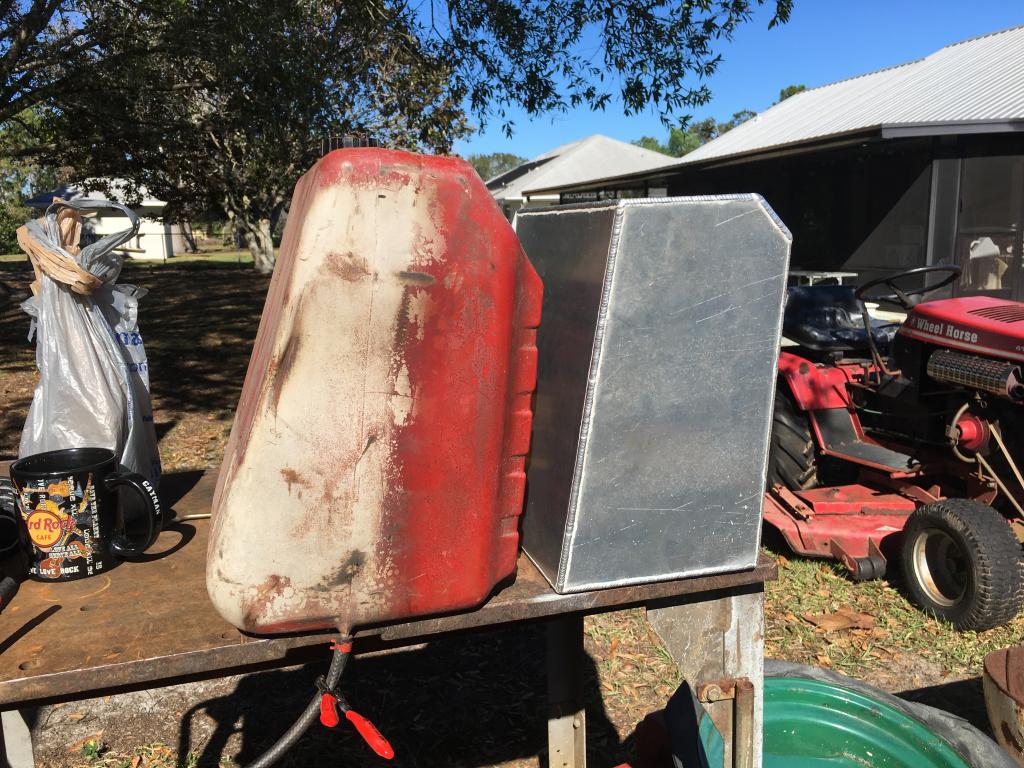

ZXT 2,402 #13 Posted December 1, 2019 2 minutes ago, Aldon said: I did a thread that fixes the main problem of the nipple splitting. Cut it off, drill it out and use a Furl grommet like on the newer models. I followed your thread when I first started messing with my G-14 (which I have neglected to touch for the past year) and repaired the nipple, but even after that, it's still a large plastic tank in very close proximity to hot exhaust. My tank is deformed quite a bit from the muffler and is also cracked along the top seam. I plastic welded it but it didn't hold up well. Share this post Link to post Share on other sites

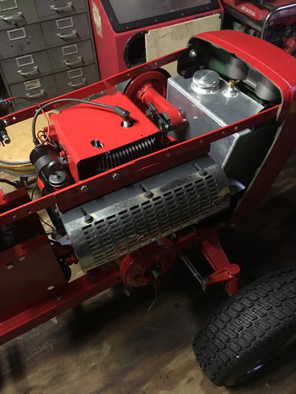

19richie66 17,932 #14 Posted December 1, 2019 (edited) @ZXT Here are pics of the three that we have made so far. Mine works great for me. I know the other two haven’t been installed yet. Waiting to hear how they like them. They are a little smaller than stock. Holds a little over 4 gallons. Edited December 1, 2019 by 19richie66 7 1 Share this post Link to post Share on other sites

mr biggs 187 #16 Posted December 1, 2019 Hummm I would love to get my hands on one of them tanks , any way a guy could purchase one ?? 1 Share this post Link to post Share on other sites
19richie66 17,932 #17 Posted December 1, 2019 @mr biggs please shoot me a pm and we can talk about it. I’m in the process of moving so a lot of my stuff is packed up. I am going to try and make a couple more soon. I need one for my next gt14. 1 1 Share this post Link to post Share on other sites
ZXT 2,402 #18 Posted December 1, 2019 3 hours ago, 19richie66 said: @ZXT Here are pics of the three that we have made so far. Mine works great for me. I know the other two haven’t been installed yet. Waiting to hear how they like them. They are a little smaller than stock. Holds a little over 4 gallons. Now that is is an excellent looking fuel tank! If I ever get any attachments for my GT to make it actually be a useful tractor I might be interested in one! 1 Share this post Link to post Share on other sites

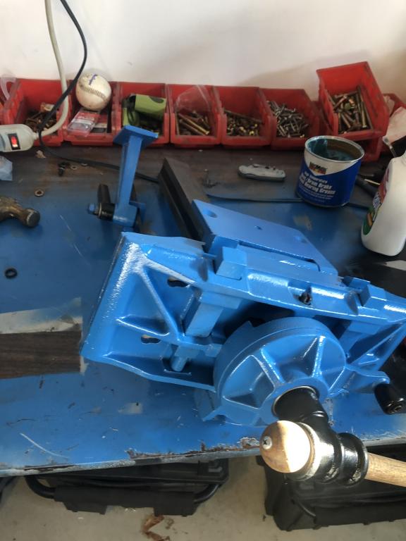

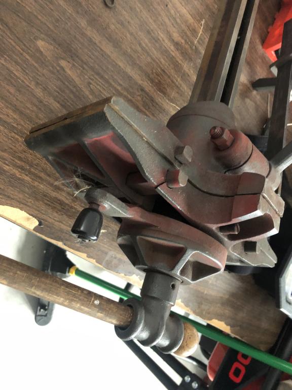

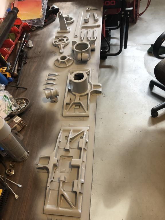

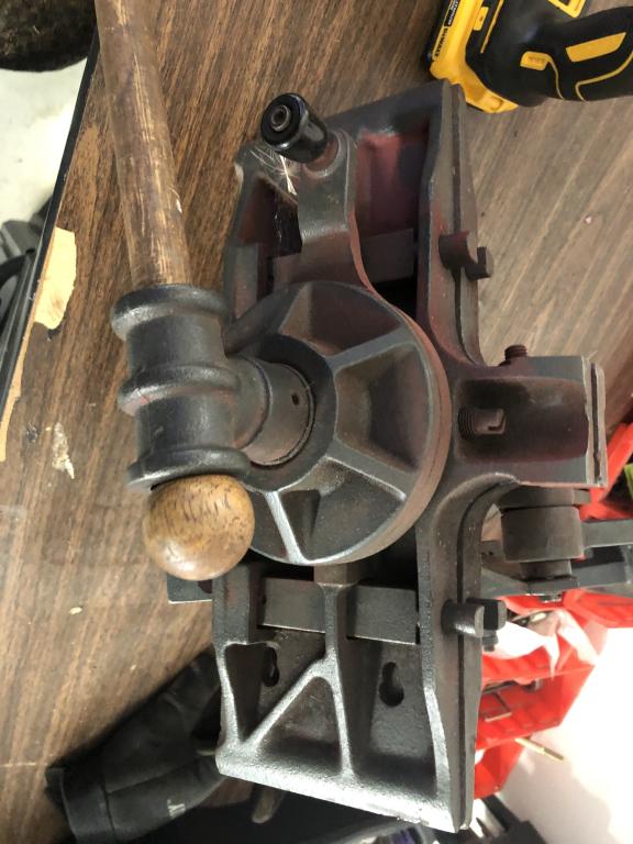

formariz 12,381 #20 Posted March 10, 2020 On 11/30/2019 at 4:45 PM, Aldon said: Had intentions of asking you before how you use your vise and what it is mounted on? What type of work is it used on? Share this post Link to post Share on other sites

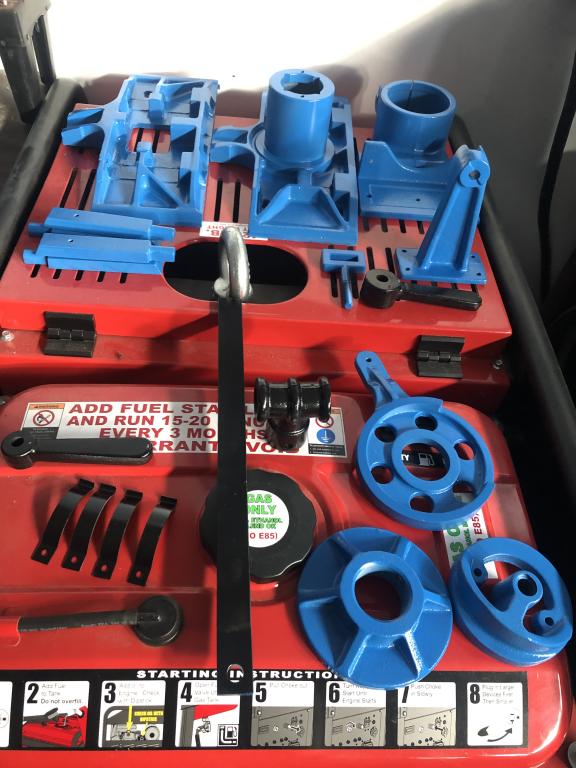

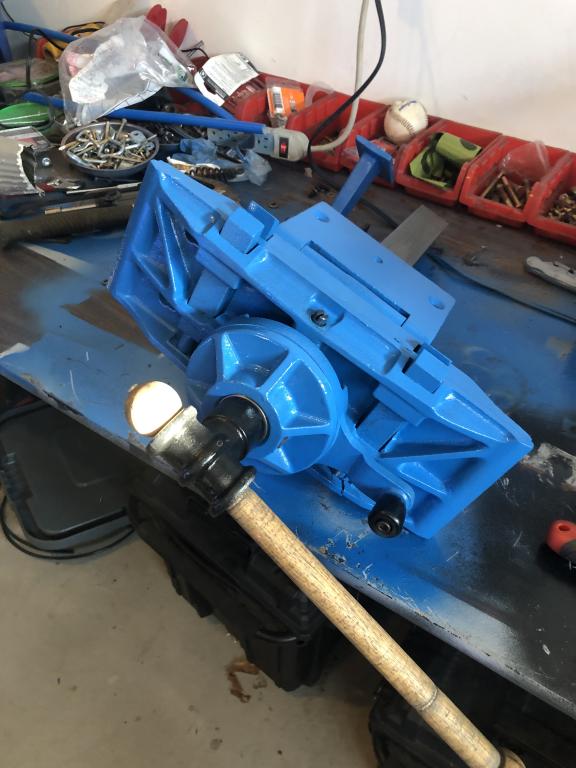

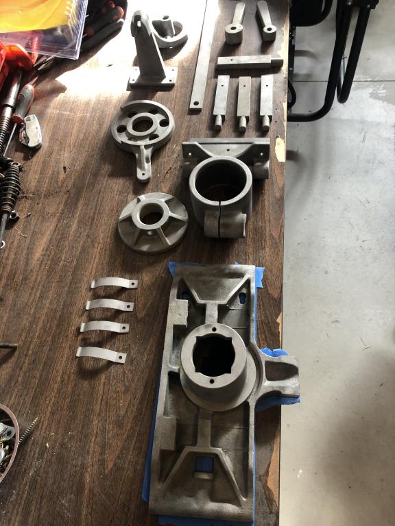

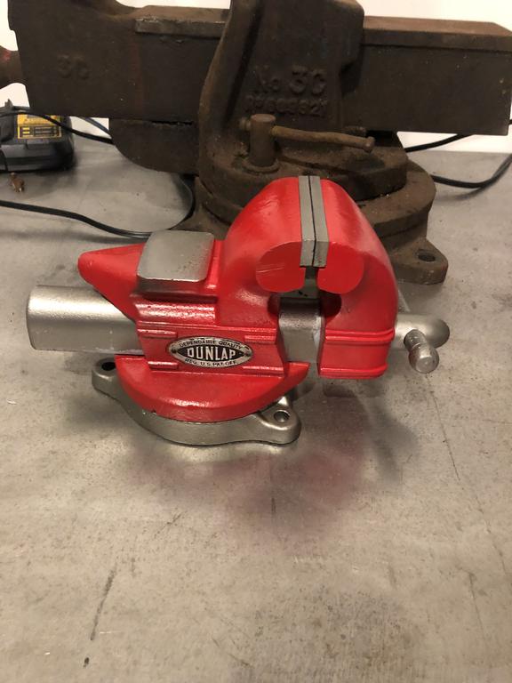

Aldon 4,832 #21 Posted March 16, 2020 On 3/10/2020 at 2:06 PM, formariz said: Had intentions of asking you before how you use your vise and what it is mounted on? What type of work is it used on? I use it for everything.....but ideally not to hammer or wrench overly hard on. I had it attached to a woodworking workbench I had made on the far left side. It worked excellent. When I sold my home in NY, I let them keep the workbench since it was bolted on the wall on back side but pulled the vice. Building a new bench for my new shop is on my list of projects. As I did crack this one, which I was able to repair fully, i did get into restoring quality vises this past winter so I have a correct vise for each needed purpose. I will post some pics of them shortly. Aldon Share this post Link to post Share on other sites

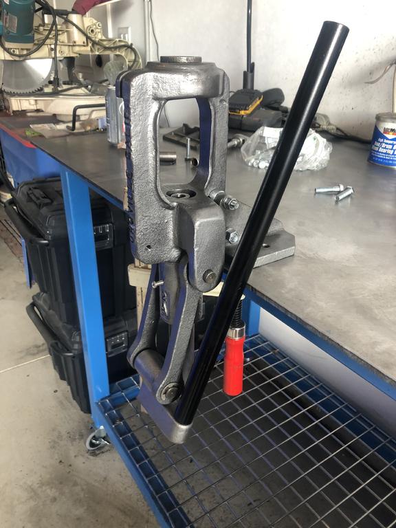

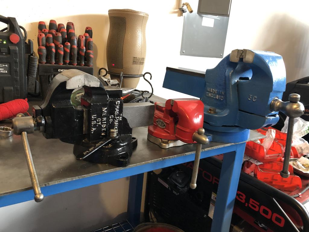

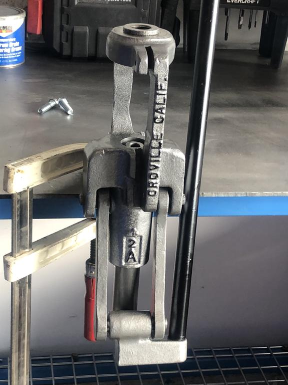

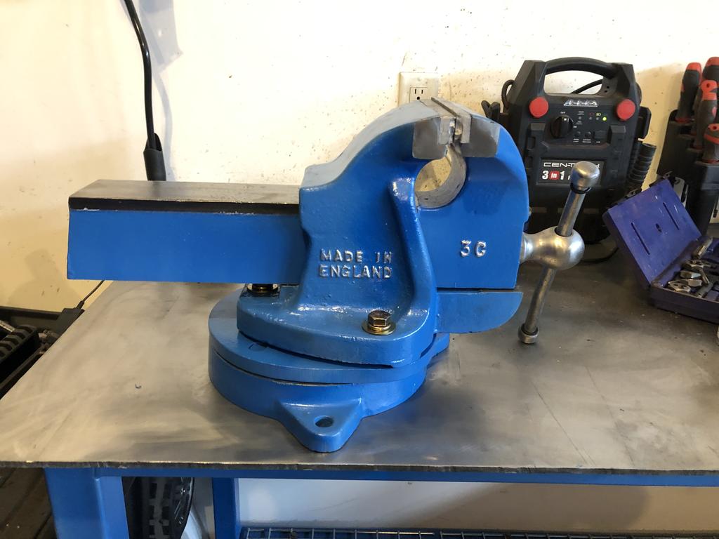

Aldon 4,832 #22 Posted March 16, 2020 So here are some pics of the 3 vises I restored this winter. Also restored an RCBS A2 old school reloading press that I will use for swaging and at some point sizing 50 BMG 4 Share this post Link to post Share on other sites
formariz 12,381 #23 Posted March 16, 2020 (edited) On 3/16/2020 at 2:04 PM, Aldon said: I use it for everything.....but ideally not to hammer or wrench overly hard on. I had it attached to a woodworking workbench I had made on the far left side. It worked excellent. When I sold my home in NY, I let them keep the workbench since it was bolted on the wall on back side but pulled the vice. Building a new bench for my new shop is on my list of projects. As I did crack this one, which I was able to repair fully, i did get into restoring quality vises this past winter so I have a correct vise for each needed purpose. I will post some pics of them shortly. Aldon Very nice work on those vises. I always loved the Dunlops or Columbians from that era with the art deco decorations and the nicely rounded surfaces. Is the blue one a Record? The pattern makers vises are really rather fragile if used or abused in a manner other than what they were designed for. Usually their final demise is a metal handle that allows the user to over tighten them breaking the jaws. Used within their intended function they have really no peer . I have collected and used Emmerts most of my life and currently have two on my bench along with a machinists vise for metal work. There are enough of them here to avoid house being blown away in bad weather. Edited March 22, 2020 by formariz 1 Share this post Link to post Share on other sites
Aldon 4,832 #24 Posted March 21, 2020 On 3/16/2020 at 4:39 PM, formariz said: Is the blue one a Record it is an English “Parkinson’s”. extremely similar to “Record” but does not have the quick adjustment nut. 1 Share this post Link to post Share on other sites
