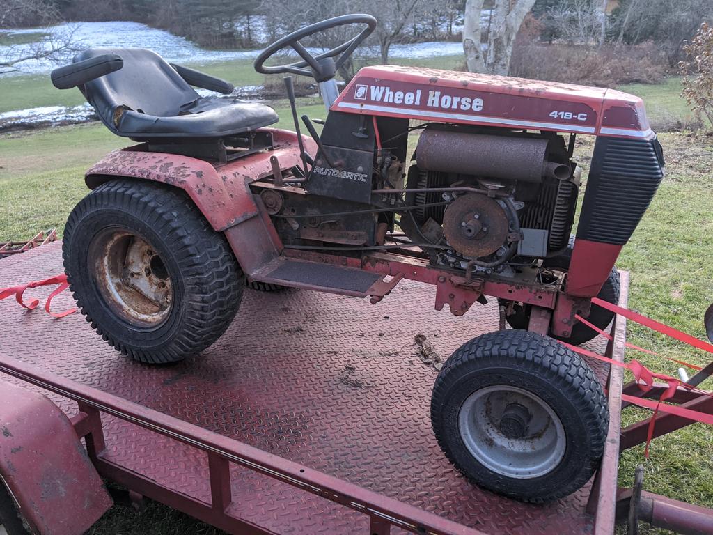

WildmanC120 615 #1 Posted November 21, 2019 Snagged this little fella from @Super-C 4 me today while picking up parts to fix up my C-161. She is a little beat up, but not off to the glue factory just yet! This should make for a good winter project bringing her back to life. I don't plan any kind of restoration just yet, just a good usable horse. Hoping the engine and trans are in OK shape still. I'm excited for the extra ground speed. I might turn this into my every day mower. 9 Share this post Link to post Share on other sites

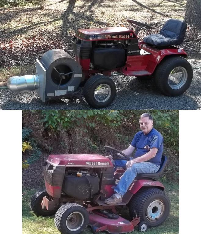

ZXT 2,402 #2 Posted November 21, 2019 15 minutes ago, WildmanC120 said: Snagged this little fella from @Super-C 4 me today while picking up parts to fix up my C-161. She is a little beat up, but not off to the glue factory just yet! This should make for a good winter project bringing her back to life. I don't plan any kind of restoration just yet, just a good usable horse. Hoping the engine and trans are in OK shape still. I'm excited for the extra ground speed. I might turn this into my every day mower. Nice buy! Could you not have put the blower on this Horse instead of modifying your C-161? 2 Share this post Link to post Share on other sites
WildmanC120 615 #3 Posted November 21, 2019 11 minutes ago, ZXT said: Nice buy! Could you not have put the blower on this Horse instead of modifying your C-161? Eventually the goal is to get a 520 or the like to put the blower on so I can return the proper hood to the 161. This 418 is pretty far gone at the moment and the engine/trans are in unknown condition. 1 Share this post Link to post Share on other sites

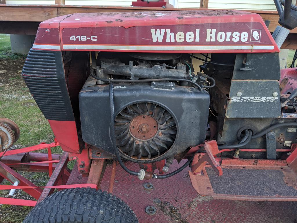

WildmanC120 615 #17 Posted November 22, 2019 12 minutes ago, 19richie66 said: 418’s are beasts. That transmission should be fine. The engine runs smooth. I just reglued the magnets on the flywheel and it was charging last I checked. The Florida humidity kills sheet metal. Should be a good tractor for you. Find some replacement body panels and it would look a whole lot better. Well...I think this one is headed to be parted out. I got it running and the engine seems to run very well, nice and quiet. I had to change the oil a few times as it was full of crud and looked like a chocolate shake. Looking much better now. Looks like the rear end is no good on this one. Its just pissing fluid out from somewhere I cant see. Forward/Reverse also do not work at all. The lift and lower also does not work. Shame as I was excited for this. Engine Running Oozing Oil Share this post Link to post Share on other sites
19richie66 17,950 #18 Posted November 23, 2019 I think the hardline from the pump has a rust hole in it. I drove it around the yard and it moved fine. Did leave a nice stripe in my son’s yard 😁 Share this post Link to post Share on other sites
WildmanC120 615 #19 Posted November 23, 2019 21 minutes ago, 19richie66 said: I think the hardline from the pump has a rust hole in it. I drove it around the yard and it moved fine. Did leave a nice stripe in my son’s yard 😁 So is it possible that the hole is big enough that the tractor won't move because it can't build pressure? IDK much about how the actual system works so just guessing here. Share this post Link to post Share on other sites

19richie66 17,950 #22 Posted November 23, 2019 (edited) 1 hour ago, WildmanC120 said: So is it possible that the hole is big enough that the tractor won't move because it can't build pressure? IDK much about how the actual system works so just guessing here. It may have leaked out too much fluid and it’s sucking air. I believe it is the hardline that is right under the tunnel/seat stand. Don’t give up on the transmission because I believe it is good. Take the seat/fender pan off and see if the hardline is rusted. It goes where the fitting is in the front and I believe goes to the lift valve or the filter housing. Can’t remember and can’t find any pictures right now. Edited November 23, 2019 by 19richie66 Share this post Link to post Share on other sites
WildmanC120 615 #23 Posted November 23, 2019 14 minutes ago, 19richie66 said: It may have leaked out too much fluid and it’s sucking air. I believe it is the hardline that is right under the tunnel/seat stand. Don’t give up on the transmission because I believe it is good. Take the seat/fender pan off and see if the hardline is rusted. It goes where the fitting is in the front and I believe goes to the lift valve or the filter housing. Can’t remember and can’t find any pictures right now. Yes whatever that hard line is that runs from the filter side between the frame and trans is the one I believe is leaking. As long as the trans housing or something isn't broken there and I can't see it. 1 Share this post Link to post Share on other sites
19richie66 17,950 #24 Posted November 23, 2019 No.....I believe it’s that line. Share this post Link to post Share on other sites
