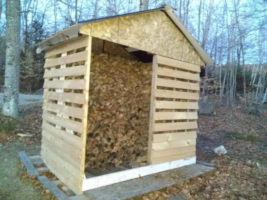

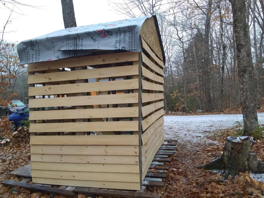

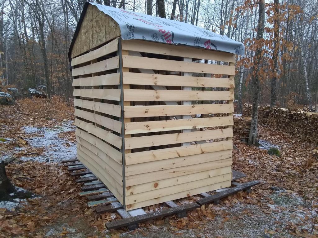

ebinmaine 81,003 #1 Posted November 17, 2019 (edited) My honey/Trina/BBT and her mom have been building us a roughly 6 x 8 foot wood shed. The only help I've given was standing up the roof assembly and securing it. ALL spare parts from past projects except the siding they started putting on today. Note the spaces between the boards. They're about 2" gapped for air flow. The bottom of each board has a nail driven in part way to hold them out 1/2" or so. The water will run from the bottom of each board to the face of the next. Edited November 29, 2019 by ebinmaine 6 3 2 Share this post Link to post Share on other sites
Sparky-(Admin) 26,571 #2 Posted November 17, 2019 Very nice. How many cord total will it hold when full? 2-1/2 to 3? So, can you school an old guy what BBT stands for 1 Share this post Link to post Share on other sites
ebinmaine 81,003 #3 Posted November 17, 2019 Just now, Sparky said: Very nice. How many cord total will it hold when full? 2-1/2 to 3? So, can you school an old guy what BBT stands for About 2.5 should fit. BBT is the official designation of @pullstart for Trina. Black Belt Trina. 2 1 6 Share this post Link to post Share on other sites

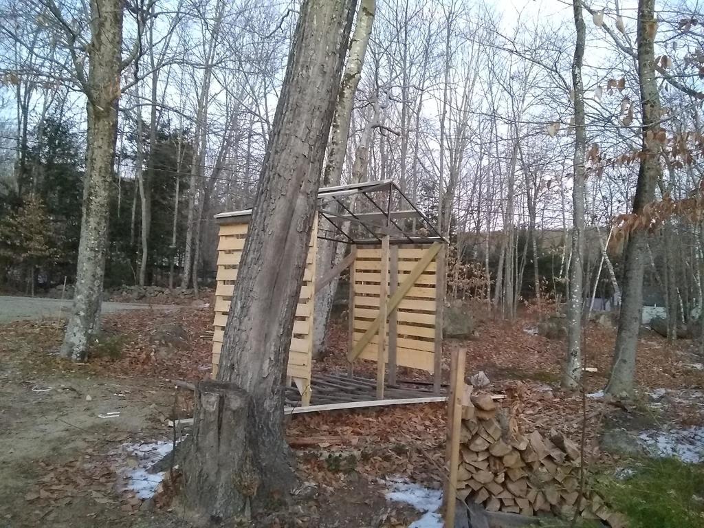

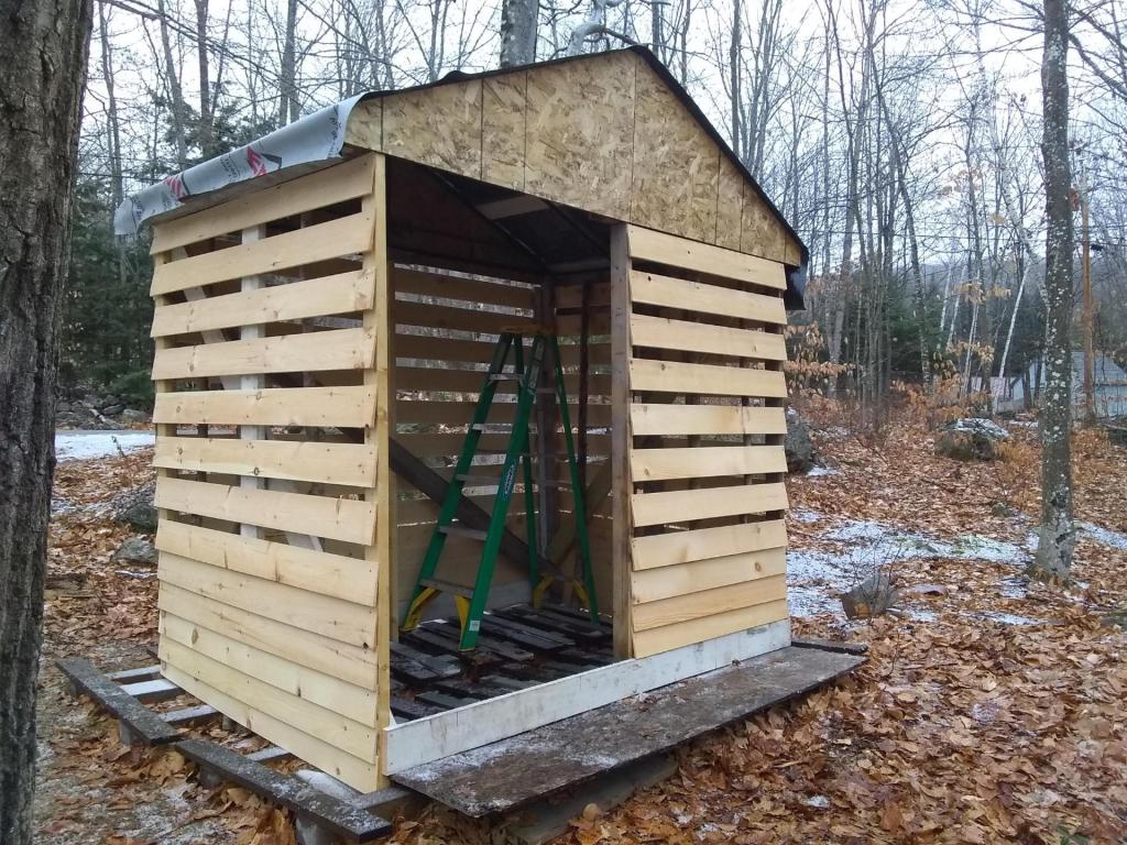

Lee1977 7,805 #8 Posted November 18, 2019 You better get a roof on that shed before it fill up with snow. Share this post Link to post Share on other sites
ebinmaine 81,003 #9 Posted November 18, 2019 Just now, Lee1977 said: You better get a roof on that shed before it fill up with snow. I have a shovel if it comes down to that but the roof goes on last I want all the support on the sides I can get while I'm putting the roof on. I'm not a little dude. 2 Share this post Link to post Share on other sites

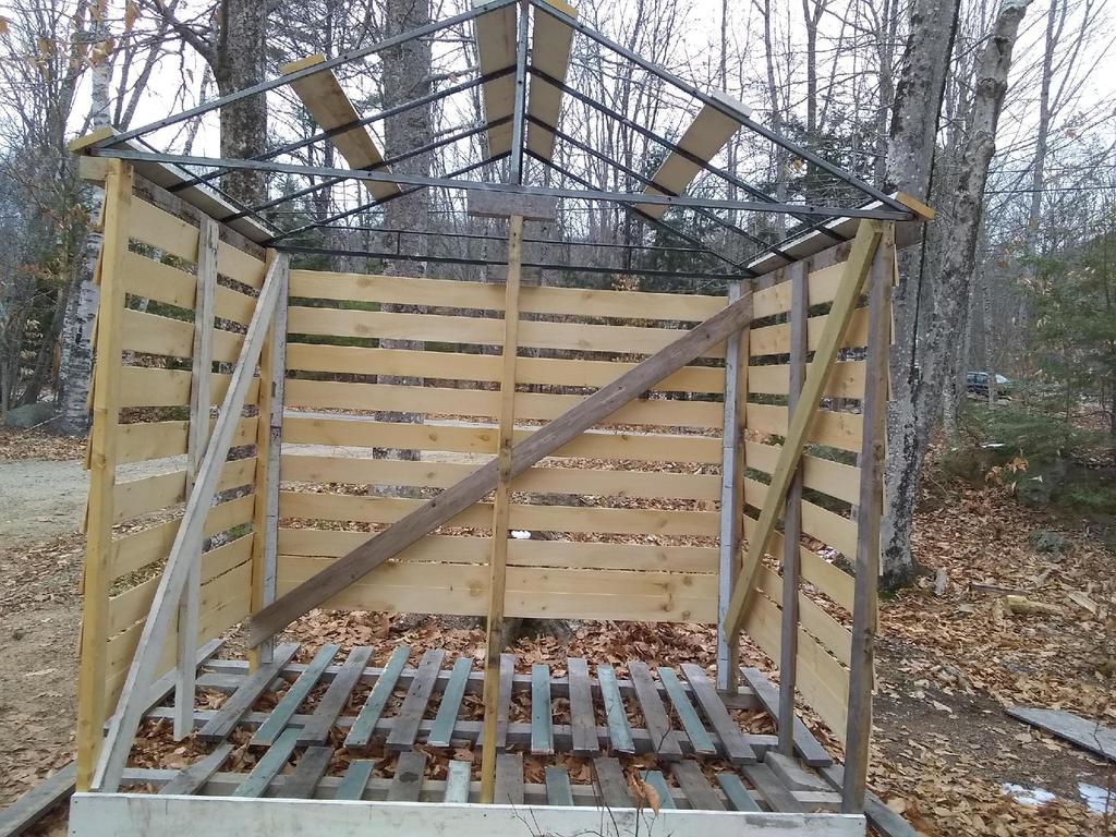

Lee1977 7,805 #10 Posted November 18, 2019 2 minutes ago, ebinmaine said: I have a shovel if it comes down to that but the roof goes on last I want all the support on the sides I can get while I'm putting the roof on. I'm not a little dude. Be careful, Some temporary bracing in the center roof might be a good ideal. I can't tell from the picture what you used for the roof structure. I would also tie the front and back together with a 2x6 as there isn't anything there to keep it from folding in. Share this post Link to post Share on other sites
ebinmaine 81,003 #11 Posted November 18, 2019 @Lee1977 There are diagonals on the interior of the three closed walls. The roof structure itself is one full solid single steel set up. I'm thinking while I am installing the pieces of metal roofing up there I will probably run some braces to the ground. To be honest, I don't think I need them but better safe than sorry. Share this post Link to post Share on other sites

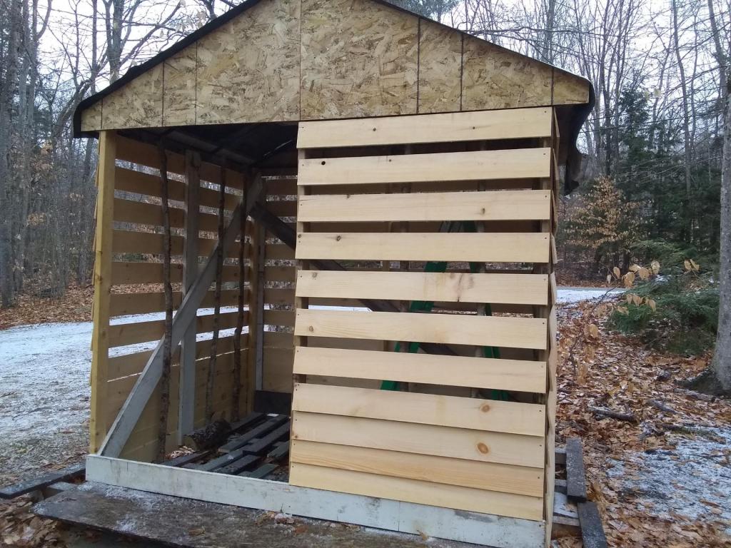

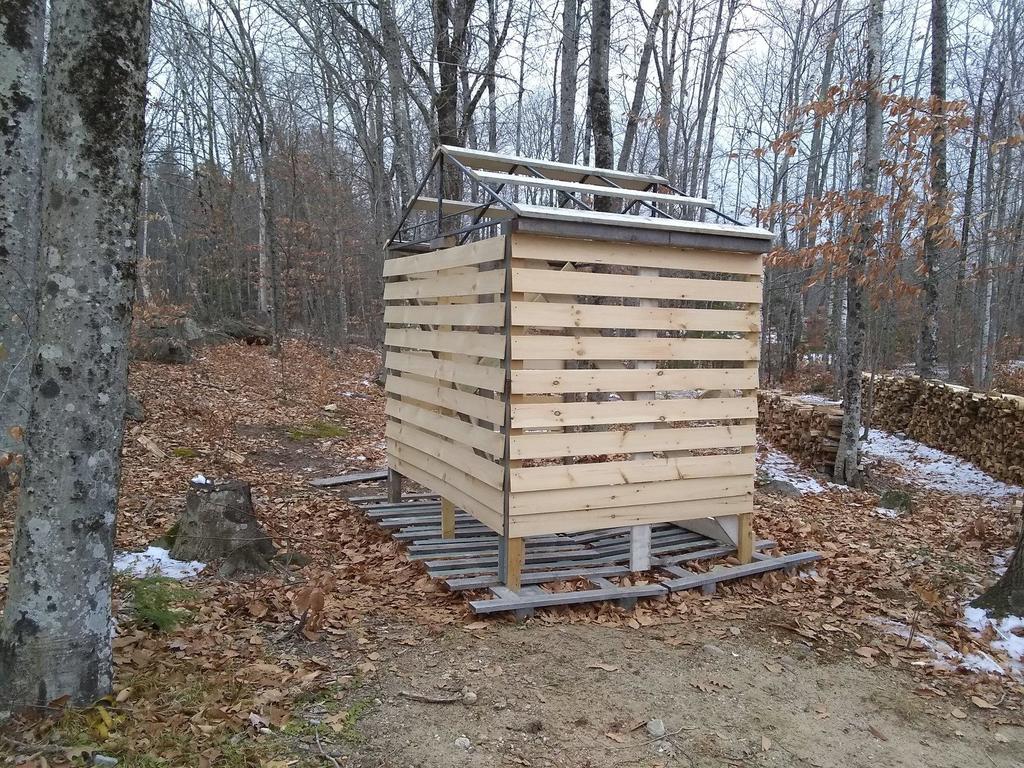

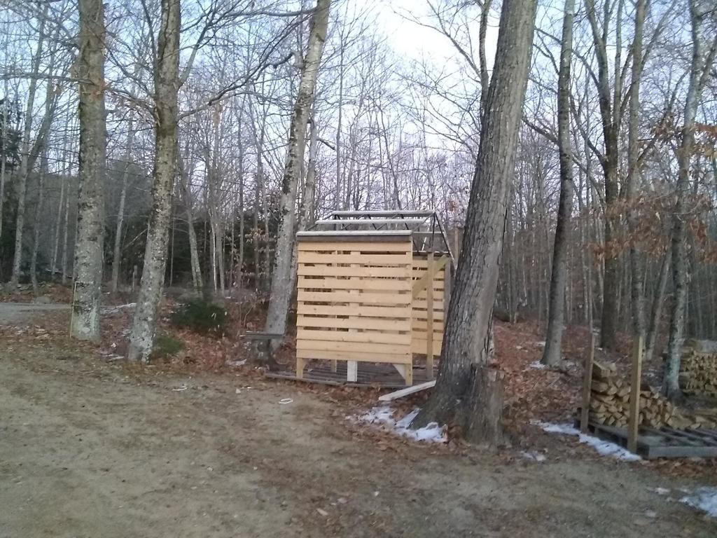

ebinmaine 81,003 #12 Posted November 18, 2019 53 minutes ago, Lee1977 said: Here's more pics from today. Trina and her mom are working on it some more. 3 Share this post Link to post Share on other sites

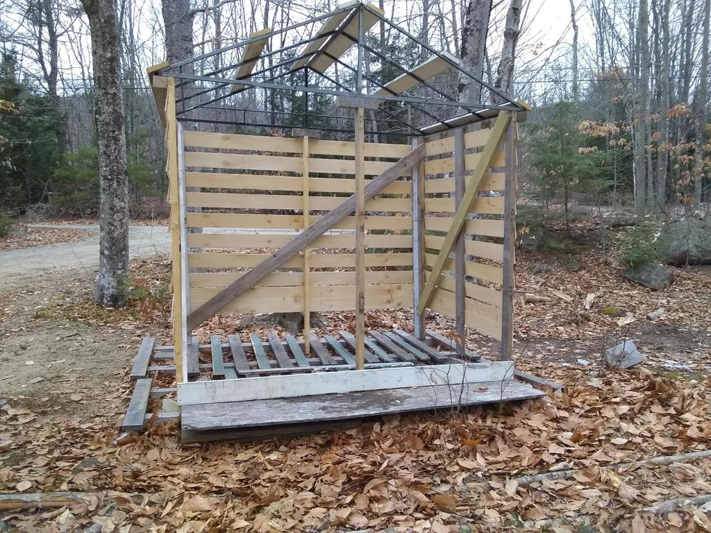

Pullstart 71,459 #13 Posted November 19, 2019 Hey EB... that back wall diagonal might be better suited the other way... if the roof wanted to come down, it could twist and plop with those diagonals the way they are. Not that I question the structural integrity... but all that effort to support might just as well be the best it can be, right? Share this post Link to post Share on other sites
ebinmaine 81,003 #14 Posted November 19, 2019 5 minutes ago, pullstart said: Hey EB... that back wall diagonal might be better suited the other way... if the roof wanted to come down, it could twist and plop with those diagonals the way they are. Not that I question the structural integrity... but all that effort to support might just as well be the best it can be, right? Absolutely. In fact I'd thought about putting another one going opposite to it. The open front will also be braced more than it currently is. Share this post Link to post Share on other sites

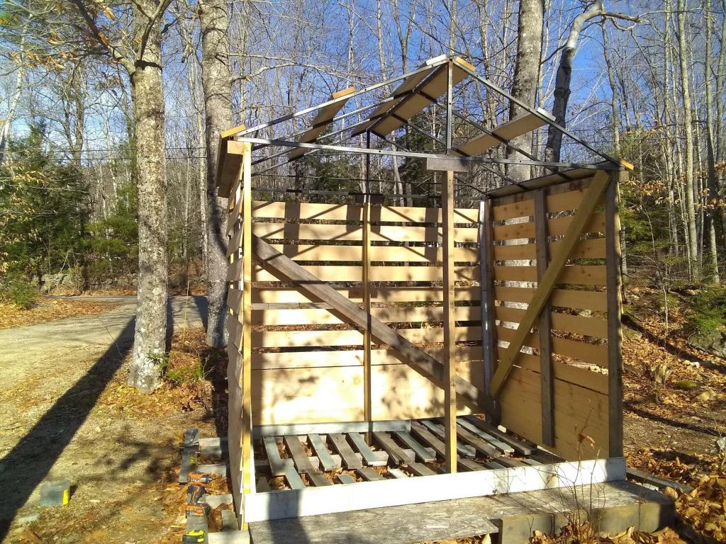

ebinmaine 81,003 #15 Posted November 24, 2019 On 11/18/2019 at 7:33 PM, pullstart said: Hey EB... that back wall diagonal might be better suited the other way... if the roof wanted to come down, it could twist and plop with those diagonals the way they are. Not that I question the structural integrity... but all that effort to support might just as well be the best it can be, right? Yesterday Trina and her mom spent some time working on the shed again. You can see where they reversed the direction of the diagonal brace on the back wall. They also worked on putting the clapboards on the walls some more and installed vertical braces on the inside for the wood piles to rest against. Those braces are pieces of harvested forest wood. Saplings. Today we installed the gable pieces and put some Typar type material over the top just to make it waterproof until we get time to install the metal roofing. 2 2 Share this post Link to post Share on other sites
Pullstart 71,459 #16 Posted November 24, 2019 Looks great! 1 Share this post Link to post Share on other sites
ebinmaine 81,003 #17 Posted November 24, 2019 22 minutes ago, pullstart said: Looks great! Thanks Kev! I'm also happy to report that I was just out there throwing a few extra Staples on the edges of the roof and the rain is running right off the outsides of the bottoms of the boards just like it should so the system is working well. 1 1 Share this post Link to post Share on other sites
Sparky-(Admin) 26,571 #18 Posted November 24, 2019 So is the floor just pallets? If yes, how long will they last? Share this post Link to post Share on other sites
ebinmaine 81,003 #19 Posted November 24, 2019 3 minutes ago, Sparky said: So is the floor just pallets? If yes, how long will they last? They are. 3 to 5 years or so....?? The rest of the building is also scrap except the clapboards. When it falls over it'll give Trina something to do. 1 1 Share this post Link to post Share on other sites

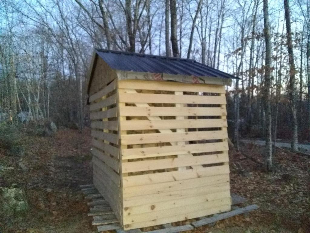

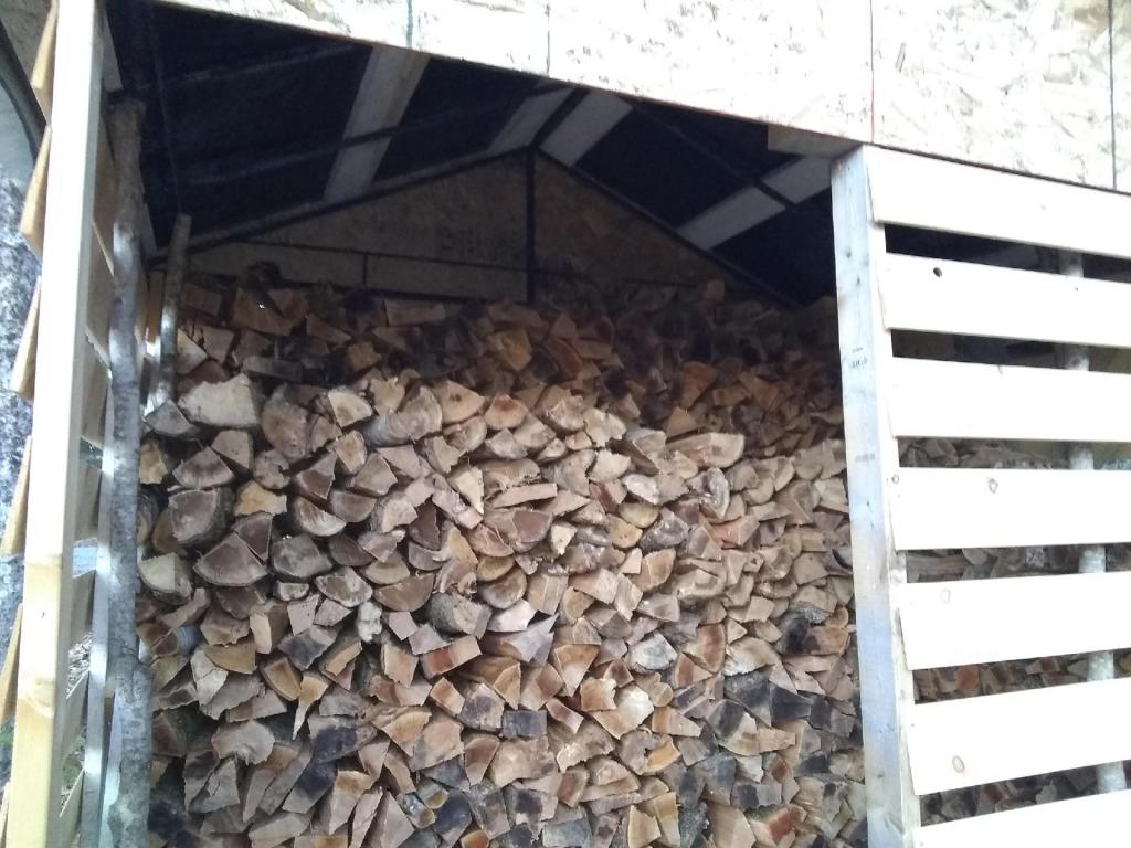

ebinmaine 81,003 #20 Posted November 29, 2019 We finished up putting the metal roof on and then filled it right up. Somewhere around 2 cord in there. 4 Share this post Link to post Share on other sites
Stormin 9,988 #21 Posted November 29, 2019 Still room for more. 1 Share this post Link to post Share on other sites
ebinmaine 81,003 #22 Posted November 29, 2019 1 minute ago, Stormin said: Still room for more. Yeah there sure is. Nothing left to put in there for this year though. Share this post Link to post Share on other sites
Stormin 9,988 #23 Posted November 29, 2019 1 minute ago, ebinmaine said: Yeah there sure is. Nothing left to put in there for this year though. That enough to see you through the winter? Share this post Link to post Share on other sites
Sparky-(Admin) 26,571 #24 Posted November 29, 2019 Some mouse (or many mice) is just gonna love living in there!! Well done, and just in time for winter 2 Share this post Link to post Share on other sites
Lee1977 7,805 #25 Posted November 29, 2019 Better get busy and fill that shed up, it's going to be a long cold winter. Share this post Link to post Share on other sites
