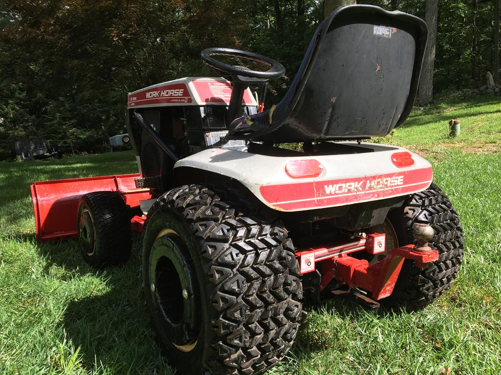

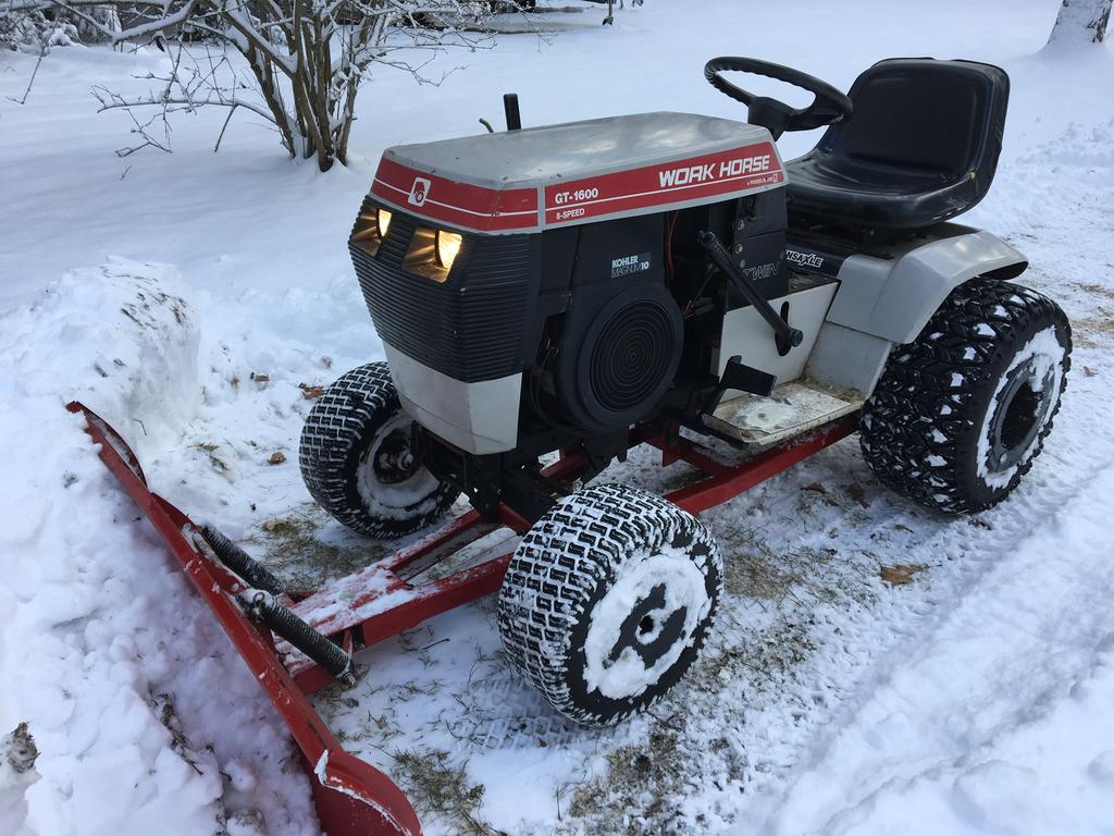

Sparky-(Admin) 25,934 #5 Posted October 28, 2019 My opinion is that Ags are lousy for snow clearing on asphalt or concrete driveways. I went with this style tread a few years back and they are GREAT! I have 75#’s of cast iron wheel weights on each rear rim and don’t run chains. 8 Share this post Link to post Share on other sites

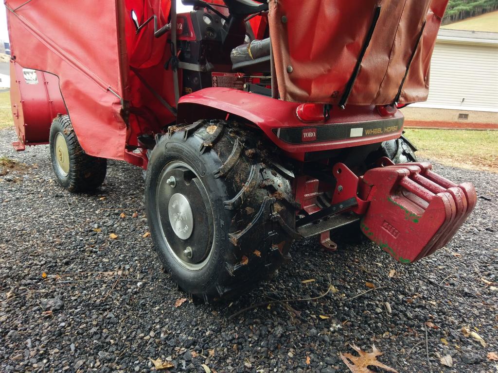

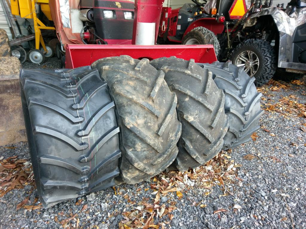

WVHillbilly520H 10,378 #7 Posted October 28, 2019 (edited) I guess I'll be the odd duck out at the moment... I plow and snowblow (depending on amount) with a pair of 520Hs mounted with Lawn Trac R1 AG tires that are fluid filled along with iron wheel weights and then a custom rear bracket for suitcase weights on the blower tractor... With this particular brand tire I have had NO issues with slippage on our inclined asphalt driveway... Before this brand I had Nankang and Deestone AGs which required the use of chains even with the addition of wheel weights... Also the older a tire is the harder the rubber ,the less flex and less tractive forces... I do believe turfs allow more rubber to force the chain to dig in more effectively than AGs unless you get the diamond or net style chains... So just to reiterate IMPO the Lawn Trac R1 or Carlisle TruPower AGs would be my go to tire of choice but loaded with fluid and additional wheel weights. VIDEO0124.mp4 Edited October 29, 2019 by WVHillbilly520H 5 1 Share this post Link to post Share on other sites

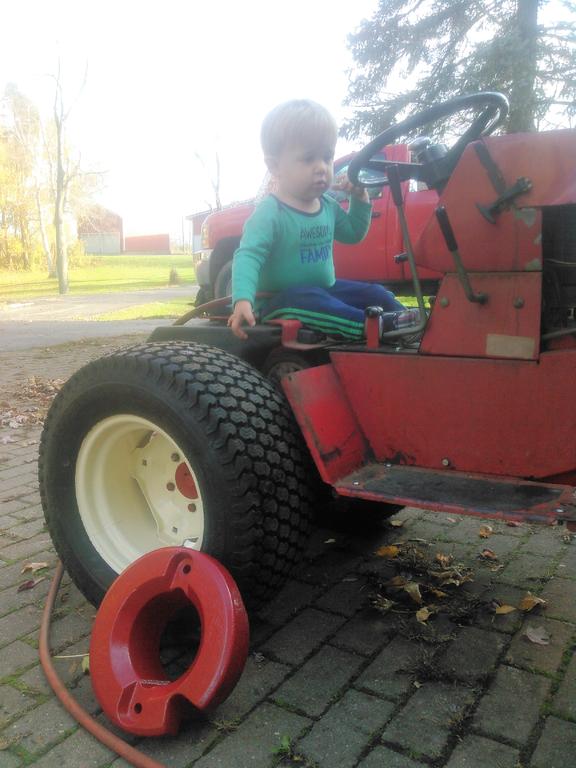

Mikey the Monkey 701 #15 Posted October 30, 2019 Fluid filled 23x9.5x12 Kenda turfs inspired by @SylvanLakeWH, and wheel weights. No chains. Works well for me. 2 1 Share this post Link to post Share on other sites
SylvanLakeWH 31,710 #16 Posted October 30, 2019 52 minutes ago, Mikey the Monkey said: Fluid filled 23x9.5x12 Kenda turfs inspired by @SylvanLakeWH, and wheel weights. No chains. Works well for me. Officer: “You look kinda young to be driving such a fast machine there son...could I see your license and registration?” Boy: “Uhm...My Dad said it was ok...” 2 Share this post Link to post Share on other sites
953 nut 67,375 #17 Posted October 30, 2019 3 hours ago, Mikey the Monkey said: Fluid filled 23x9.5x12 Kenda turfs inspired by @SylvanLakeWH, and wheel weights. No chains. Works well for me. A seat might be a nice addition. 3 Share this post Link to post Share on other sites
lynnmor 8,896 #18 Posted October 30, 2019 4 hours ago, Mikey the Monkey said: Fluid filled 23x9.5x12 Kenda turfs inspired by @SylvanLakeWH, and wheel weights. No chains. Works well for me. No wonder you need all that weight, you look kinda light. 2 Share this post Link to post Share on other sites
Mikey the Monkey 701 #19 Posted October 30, 2019 Haha yes @953 nut, I was putting the seat and tins back on after doing oil change, new belt, new set screws, new woodruff keys, new seals, painted wheels/hubs/weights. Just getting it ready for snow plow time @lynnmor, Mikey the monkey took the pic, that's Sammy the monkey waiting for me to turn my head so he can hide the key 1 1 Share this post Link to post Share on other sites
bds1984 1,513 #20 Posted October 30, 2019 Everyone has their preference for what combination of tread style, chains, and/or weights. I think a lot of it comes down to your need, what is available, and your budget. I use my 520H mutt for plowing and it has 23-8.50R12 ags, loaded, and the plastic cover wheel weights and it plows/pushes pretty darn good. If I need more I have an additional 100 pounds of plate weights to install in my 2-inch receiver. The only issue I have ever had pushing snow is when there is an ice storm that has left behind a nice, slick mess and in that case, there isn't much that can overcome that. For my C165 I have 23-10.50R12 ags, loaded, and cast iron wheel weights; this machine I have yet to plow with but I just may try her out this winter. I would go with what Spark has on his Workhorse but I got an incredible deal on the ags for my 520. 2 Share this post Link to post Share on other sites
