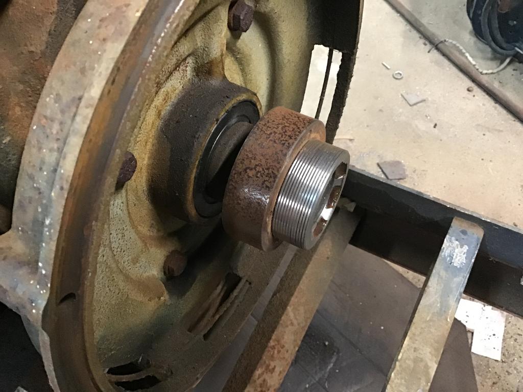

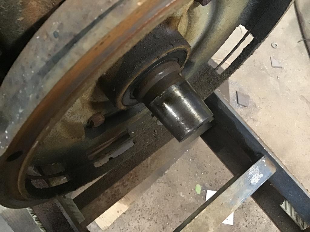

Pullstart 71,459 #26 Posted October 24, 2019 (edited) The genny guts came off. It’s a tapered shaft. If I cut the guts apart, I could cut a tapered pulley out of the drive hub and call it a day. If it runs. Edited October 24, 2019 by pullstart Pictures 2 Share this post Link to post Share on other sites

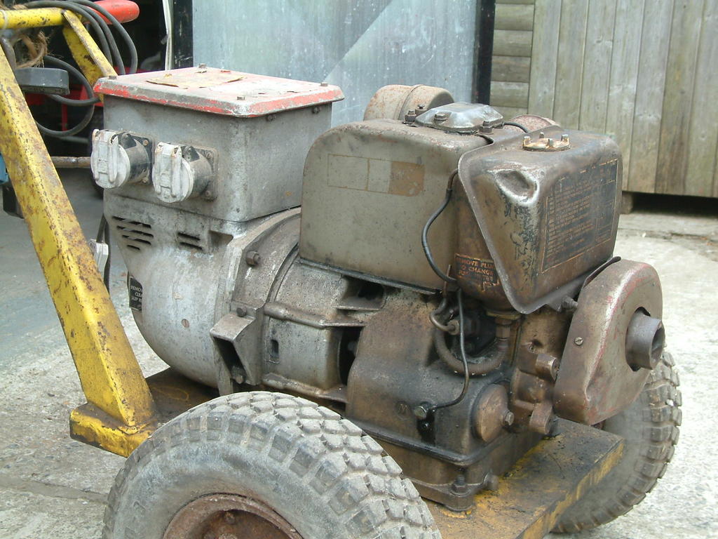

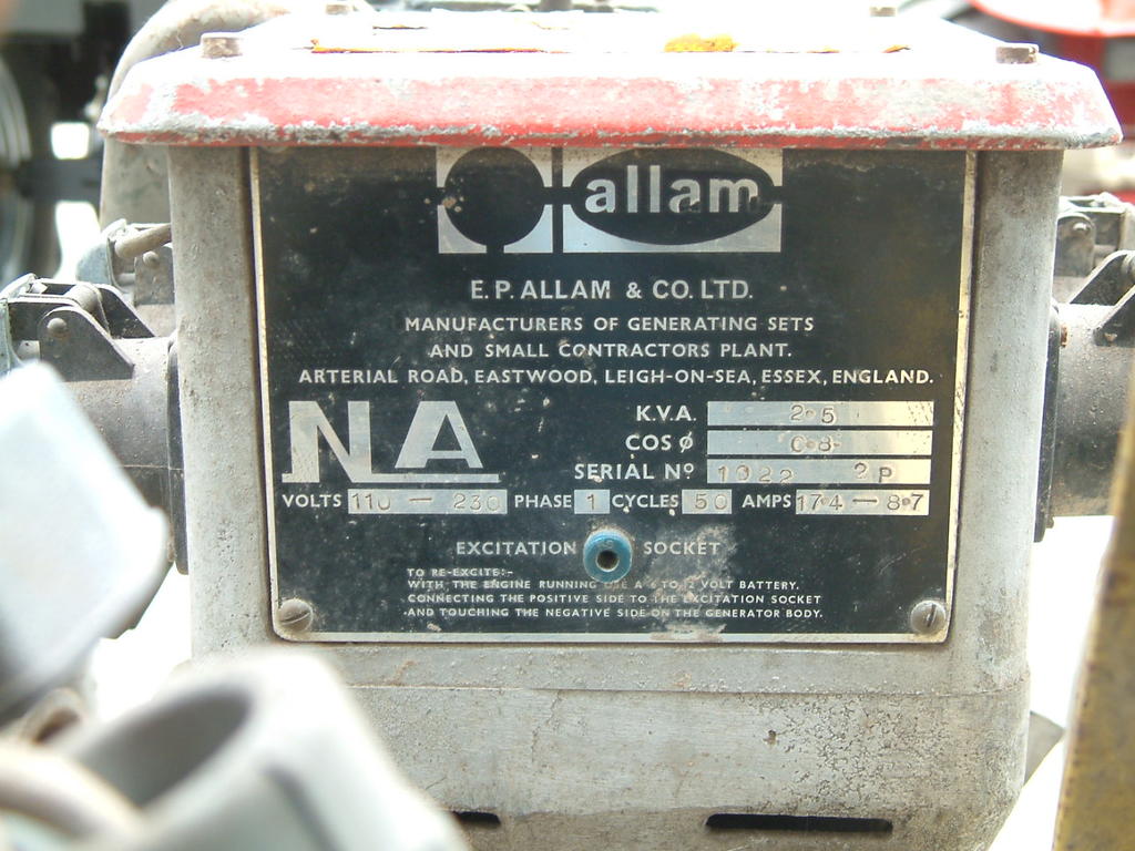

Stormin 9,988 #29 Posted October 24, 2019 Talking of gennys, I've a little Petter diesel one. 110v and 240v. Maybe some one can tell me what I could power off it. Electrics are not my strong point by a long chalk. I know it will power the workshop lights. Domestic appliances are 240v over here. Share this post Link to post Share on other sites
Pullstart 71,459 #30 Posted October 24, 2019 Watts = amps x volts. with that said, that is a 2001 watt genny. 1 2 Share this post Link to post Share on other sites
Achto 32,864 #31 Posted October 24, 2019 (edited) Rating on the tag says 2.5kva or 2500 watt ( kva rating is not generally used here with single phase power) but that is probably a surge rating. @pullstart's figure's are most likely the continuous rating. An average 110v electric space heater here is 1500 watt, this would leave room for an additional five 100w bulbs then it would be maxed out. Although the load on the gen would be very unbalanced as you would be potentially pulling 1500w from one leg & 500w from the other. If you are using 240v it would have an even load al the way through to 2000w. In short you would have to know the wattage rating of each item that you are running with the gen & add them together to know when you are maxed out. Edited October 24, 2019 by Achto 2 Share this post Link to post Share on other sites

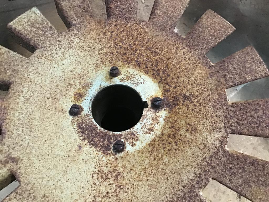

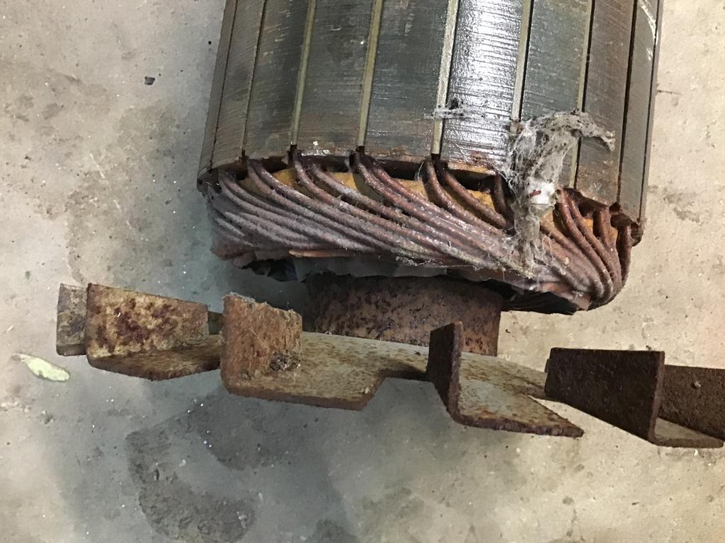

Pullstart 71,459 #33 Posted October 24, 2019 I cut the genny guts apart and spun the hub on the lathe. That’s something to work by! 2 1 1 Share this post Link to post Share on other sites
