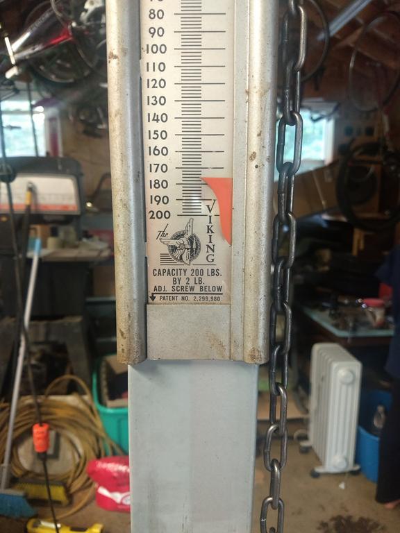

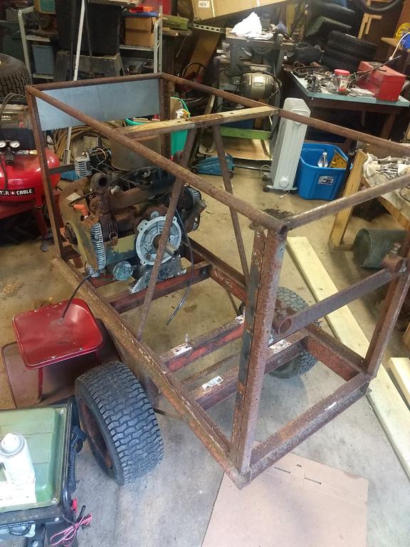

Pullstart 71,561 #722 Posted November 11, 2020 On 8/31/2019 at 10:07 PM, ebinmaine said: I've been getting a few things ready for this build over the last few weeks and today decided it's time to start a thread. This will be a C-series ... Named Colossus. And for good reason. It'll have the BIG Kohler twin K582 powerplant. 8 speed. Rear tires somewhere in the 27"-30" height range. Fronts will likely be oversized as well but not sure yet. It'll be approximately 5 to 6 inches taller, several inches wider, and longer (because of the battery and fuel tank location) than a normal C Series. The rear fenders are from an early 60s Horse and have been modified to bolt to the flat step boards of a 68+ model. The hood stand and fenders will need to be raised... I think... around 4" to clear the engine and tall rear tires. I'll most likely use some 4" tall rectangular steel stock for that. Here's a few pics of the engine coming out of the generator trailer frame. I put my recently purchased chain falls to good use. Out and hanging from the scale. 176 pounds!! Now for comparison I weighed a 12 horse single. 138... Here's a few pictures to show the size of the big twin compared to a 12 single. The K582 measures about 20" across the front. I'll need at least 24" front to back in the tractor so I can remove the oil filter which will be accessed right near the steering column/gear. This engine will stick out from under the right side hood almost 4" after installation. This hood will be removed in favor of a C Series hood but this is the chassis I'll be using. I'll also swap the 4 speed to an 8 so I have a low for reverse. The tiny little battery box and fuel tank shelf will be removed to make space for the engine. Note the fenders Not sure if I'll be able to use it yet... This axle was all custom made. It's about 6" narrower than a stock C axle. It would look cool but I'd rather have it wider for stability.... The battery and fuel tank will probably be moved to the front of the tractor. Battery even with the frame and fuel tank above it. The hood will be lifted straight up and removed instead of tilted forward. I'll sketch up something and share that later. Not positive on the color yet but leaning towards Rust-Oleum 2X Apple Red. My lead dismantler and head paint specialist is working on painting the house for a few weeks so this'll be a long project. I'd be pretty happy to be able to use it for logging next season. Hey EB... when does next login season begin? 4 Share this post Link to post Share on other sites
