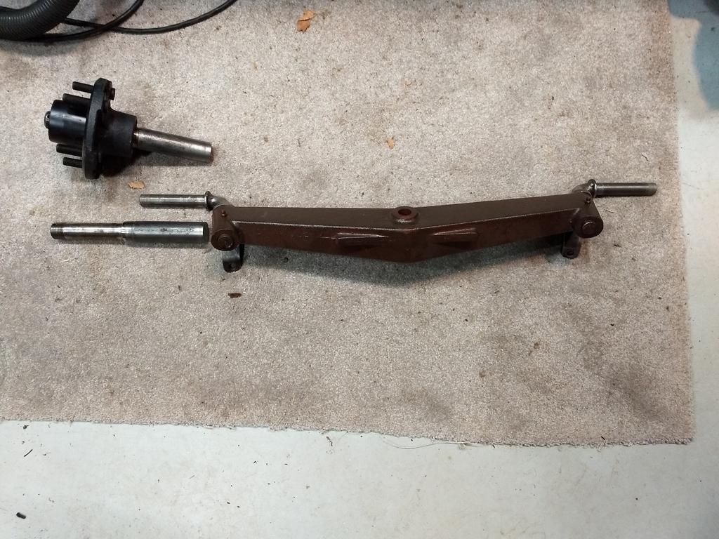

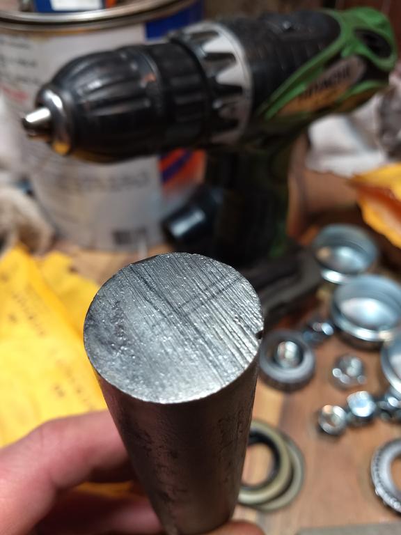

Cvans 1,009 #476 Posted April 7, 2020 I wish you lived closer you could bring them over and we'd have you going in no time. Without a lathe how are you going to make sure you drill straight into the spindle? Your going to want to keep your wheels mounted with the original spread or steering is going to be difficult as stated above. I would cut off your trailer spindles just beyond the hubs. Bore them and the slip them onto the WH spindles. This might be a good time to make friends with someone who has a lathe or will let you use theirs. The latter might be a stretch. 2 Share this post Link to post Share on other sites
ebinmaine 80,975 #477 Posted April 7, 2020 5 hours ago, Cvans said: I wish you lived closer you could bring them over and we'd have you going in no time. Without a lathe how are you going to make sure you drill straight into the spindle? Your going to want to keep your wheels mounted with the original spread or steering is going to be difficult as stated above. I would cut off your trailer spindles just beyond the hubs. Bore them and the slip them onto the WH spindles. This might be a good time to make friends with someone who has a lathe or will let you use theirs. The latter might be a stretch. I'll be the only one driving this unless on rare occasion someone like @JCM or @Stepney wants to take a cruise. Anyone who stops by would be welcome. "Armstrong steering" isn't an issue as long as I'm not breaking parts. I'll use an old strongman trick. Don't try to steer unless you're already rolling. To do the drilling I'm going to mount the axle stub in my drill press. It's an old stand-up type no name I inherited from my grandfather. I've never tried to do any precision work with it so it's about time I learned to set it up right. Biggest issue will be starting as close to center as I can. Machine shop work on the private side for me is non existent. It's also quite expensive around here in comparison to other areas. I have a friend who can get things done for us but she lives over 90 minutes away and the state is on lockdown for the foreseeable future anywhooo... No worries. @wallfish I like the DOM idea but the stubs have a place for the grease seal. 2 1 Share this post Link to post Share on other sites
wallfish 20,689 #478 Posted April 7, 2020 1 hour ago, ebinmaine said: @wallfish I like the DOM idea but the stubs have a place for the grease seal. Another small ring of tube for the ID of the seal over the 1" tube for the spindle solves that. Mine is buried but I'll see if I can get you a pic. Here''s some more options to use those spindles http://www.p.f.engineering.50megs.com/photo.html 2 Share this post Link to post Share on other sites
Tractorhead 9,217 #479 Posted April 7, 2020 Good ideas of reworking the Spindles. The reinforce brings you the ability fo more load if required. 👍 1 Share this post Link to post Share on other sites
953 nut 69,839 #480 Posted April 7, 2020 @ebinmaine, why don't you get some one inch OD by 3/4 inch ID bushings so that the trailer hub bearings can be used on the existing axles? You could drill and tap the ends of the axles for a bolt and washer to hold the bearings in place. Share this post Link to post Share on other sites
ebinmaine 80,975 #481 Posted April 7, 2020 10 minutes ago, 953 nut said: @ebinmaine, why don't you get some one inch OD by 3/4 inch ID bushings so that the trailer hub bearings can be used on the existing axles? You could drill and tap the ends of the axles for a bolt and washer to hold the bearings in place. Part of the reason I want to use the stubs is so I can add several inches to the width of the front of the tractor. Share this post Link to post Share on other sites
953 nut 69,839 #482 Posted April 7, 2020 4 minutes ago, ebinmaine said: so I can add several inches to the width of the front of the tractor. May want to look for another front axle. If the axles are extended away from the bend in the spindles the 3/4" front spindles would be subjected to too much additional load and having the wheels so far from the pivot point will make steering extremely difficult. 2 Share this post Link to post Share on other sites
ebinmaine 80,975 #483 Posted April 7, 2020 4 hours ago, 953 nut said: another front axle I have one here that is actually a shortened version with a 2" square tube as the axle itself. I thought about taking that and cutting the centerpiece out and widening it. I'm not at all worried about difficulty steering on my own part as long as I'm not going to be breaking things. Share this post Link to post Share on other sites
ebinmaine 80,975 #484 Posted April 7, 2020 6 hours ago, wallfish said: Another small ring of tube for the ID of the seal over the 1" tube for the spindle solves that. Mine is buried but I'll see if I can get you a pic. Here''s some more options to use those spindles http://www.p.f.engineering.50megs.com/photo.html Thanks for that link John. I'll take a look at it later today when I can see it better on the big screen. Share this post Link to post Share on other sites
19richie66 17,937 #485 Posted April 7, 2020 13 minutes ago, ebinmaine said: I have one here that is actually a shortened version with a 2" square tube as the axle itself. I thought about taking that and cutting the centerpiece out and widening it. I'm not at all worried about difficulty steering on my own part as long as I'm not going to be breaking things. With all that weight of the engine sitting over top those axles and then the extended section on the end of them, I think that may be a little much. Definitely would try and find a 520 axle with the heavy duty spindles/hubs. Wish you were closer as I have a green front axle but it has heavy duty 1” spindles. I’d gladly give it to you. 1 1 Share this post Link to post Share on other sites

Lee1977 7,805 #489 Posted April 7, 2020 I only extended the spindle 3/4" on my C-120/180. 1 Share this post Link to post Share on other sites
Lee1977 7,805 #490 Posted April 7, 2020 (edited) Somebody used a JD front axle on a loader tractor It's wider some where around 40 + inches for the total width. Tractor Data gives the width at 49" for a 400 series JD. I think those axles have a one inch spindle. Edited April 7, 2020 by Lee1977 1 Share this post Link to post Share on other sites
Mudrig150 400 #491 Posted April 7, 2020 53 minutes ago, Lee1977 said: Somebody used a JD front axle on a loader tractor It's wider some where around 40 + inches for the total width. Tractor Data gives the width at 49" for a 400 series JD. I think those axles have a one inch spindle. Yes they do. The 300 series have one inch spindles. Share this post Link to post Share on other sites

8ntruck 9,354 #493 Posted April 8, 2020 EB - when you get the axle stubs set up in your drill press, start with a smaller diameter pilot drill, say, 1/4 inch, then work your way up to the final size in a couple of steps. The following are just idle thoughts that sprang into my head: Extending the spindles will increase the scrub radius of the front wheels when they are turned for steering. This increases the steering effort and will probably increase the amount of kick back at the steering wheel when you encounter the rare rock on your property. The resulting increased steering effort might cancel the advantage of the gear reduction steering you worked so hard to incorporate in this project. 1 Share this post Link to post Share on other sites

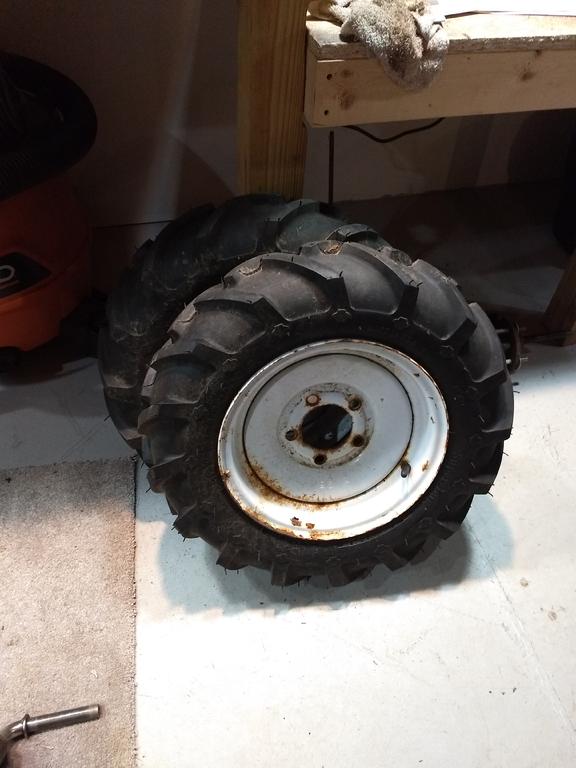

Stormin 9,988 #494 Posted April 8, 2020 (edited) On 4/7/2020 at 1:04 AM, ebinmaine said: I spent a little while tonight removing some stub axles from an old trailer project that I'm not going to use at this time. These stub axles are going to be end-drilled and installed on the spindles so I can use the regular 5 x 4.5 wheels on the front. I have a set of 6 / 12 Carlisle super lug that are basically NOS but sat outside. There's one spot that has a bit of weather checking. Nothing serious. They were sitting on the back of one of the rigs we brought home from the auction. I don't remember how to date code tires but there is a 09 at 1 indentation. I assume that means they were manufactured in 2009. I took some measurements and I would like to cut 2 inches off of each stub axle and then drill them to put the Wheelhorse spindles into them. I do have a couple questions. Is there a fairly easy way to find the center on the end of the stub shaft so I know where to begin drilling? Also, how much of the horse spindle should be stuck into the end of the stub shaft? I'll have to cut it some because I'm only going to have about 2.5" of stub shaft after I trim it to get the right tractor width. Have a look here, Eric. Near the bottom of the page. https://myoldmachine.com/topic/936-c-120-refurb/page/15/ Personally I wouldn't attempt to drill the stub axles by hand. Best done in a lathe. No one near you with one who would drill them for you? Edited April 8, 2020 by Stormin Share this post Link to post Share on other sites
ebinmaine 80,975 #495 Posted April 8, 2020 29 minutes ago, Stormin said: No one near you with one who would drill them for you? Not without charging an arm and a leg. 1 Share this post Link to post Share on other sites

ebinmaine 80,975 #499 Posted April 8, 2020 4 hours ago, Stormin said: Have a look here, Eric. Near the bottom of the page. https://myoldmachine.com/topic/936-c-120-refurb/page/15/ Personally I wouldn't attempt to drill the stub axles by hand. Best done in a lathe. No one near you with one who would drill them for you? @Lee1977 and @Stormin, when you did that conversion did your front axle come out any wider than stock? Looks like you both added about 3/4 inch per side? What I'm looking at is adding about 2 inches per side. I'll look at the other axle I have that was shop made and see about modifying that so the width is added to the axle beam and tie rods instead of to the length of the stubs. Share this post Link to post Share on other sites
Lee1977 7,805 #500 Posted April 8, 2020 (edited) 1 hour ago, ebinmaine said: @Lee1977 and @Stormin, when you did that conversion did your front axle come out any wider than stock? Looks like you both added about 3/4 inch per side? What I'm looking at is adding about 2 inches per side. I'll look at the other axle I have that was shop made and see about modifying that so the width is added to the axle beam and tie rods instead of to the length of the stubs. Don't know the original width of the C-120 It now measures 37"in width. The wheel are trailer wheels and are 5 1/2" wide. I also widened the 312-8 the Wheel Horse trailer hubs were 4 1/2" long and I removed 3/4" on the out side of the hubs. It measures 33 1/2" wide but the wheels are only 3" wide. The 1989 520-H is stock and it measures 36" wide. Edited April 8, 2020 by Lee1977 1 Share this post Link to post Share on other sites
