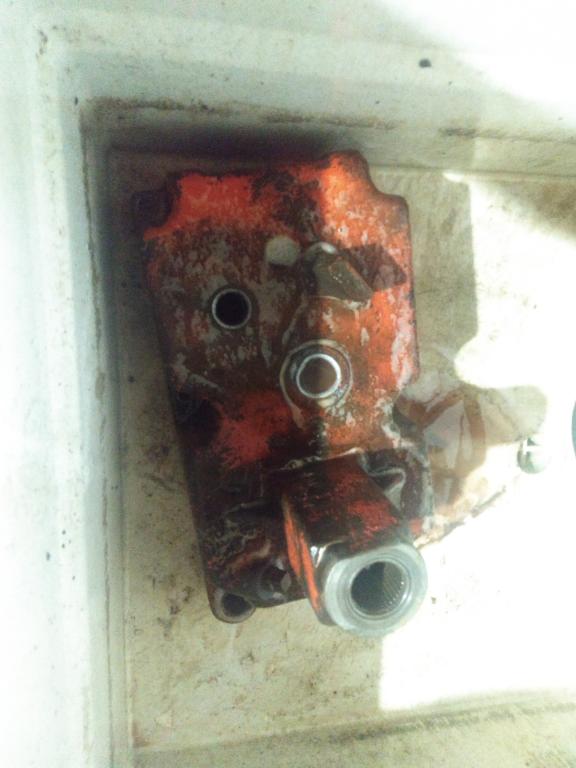

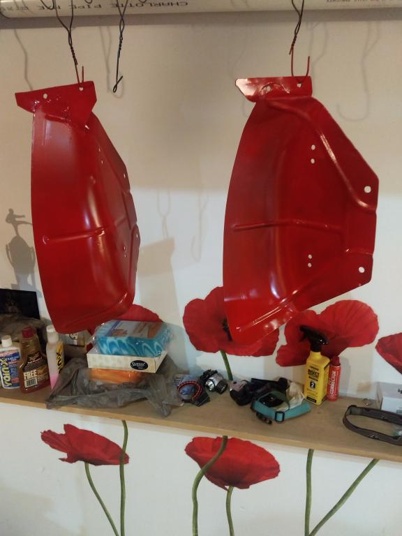

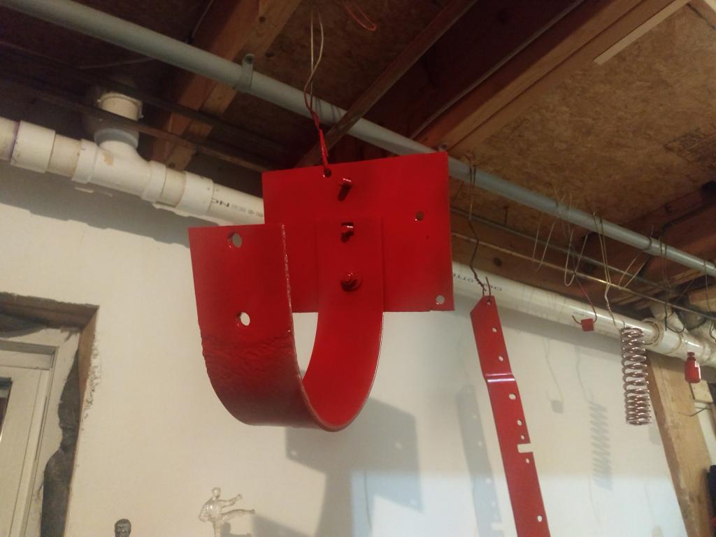

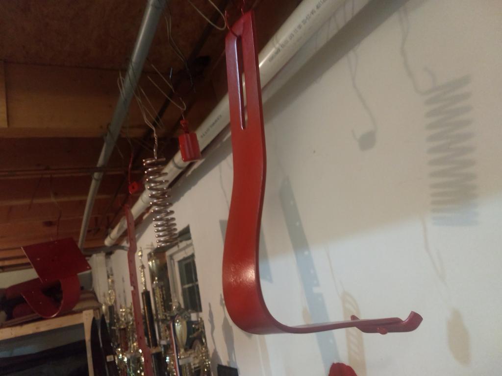

ebinmaine 80,976 #326 Posted January 28, 2020 A little more work done over the weekend. I had started to disassemble a transmission to put the axles and seals in then decided to change to another one. I remembered that the other has bad axle keyways and I'm swapping out the axles... So why use a transmission that's still good... Maybe Wednesday or Thursday I'll get to that... Trina disassembled and cleaned the front axle and spindles. Then painted the axle. Also.. the first RED paint was sprayed!! The rear fenders have their first coat. This is Rust-Oleum Apple Red Gloss. @Stormin She wants you to know that she has more than one pair of socks. 2 3 3 1 Share this post Link to post Share on other sites

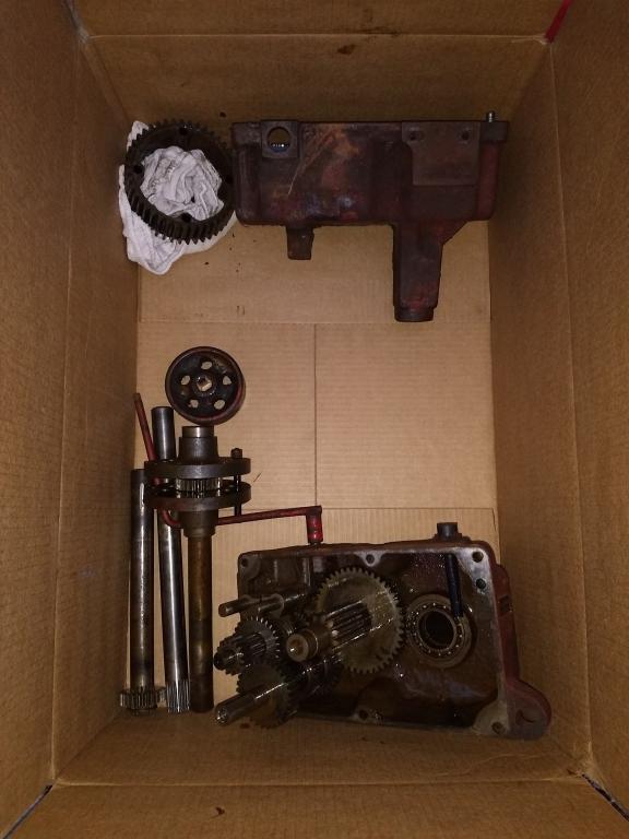

ebinmaine 80,976 #334 Posted February 2, 2020 @Stepney was nice enough to stop by and visit with us. We tore into the 8 speed I'll be using in the project. It's the one of the three 8 speeds I have that already has visible badly damaged axle keyways. I'm using axles that were generously offered by @19richie66 from a GT14. The GT14 axles are approximately 6" total wider than the C-series this transmission came out of. The dish of the 15" wheels are an inch or so deeper so... the tractor will be 4" wider than a standard size C-series, give or take... The internals look good. No visible excess wear. I'll double check the wheel bearings, install 4 new seals and clean/reassemble. At the lower left of the pic you can see the C-series axle beside the GT14 axle for a length comparison. 5 Share this post Link to post Share on other sites

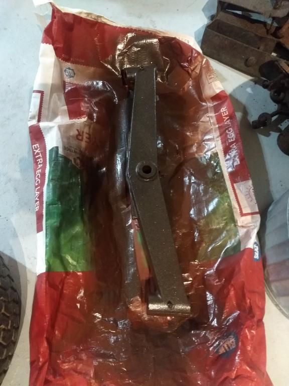

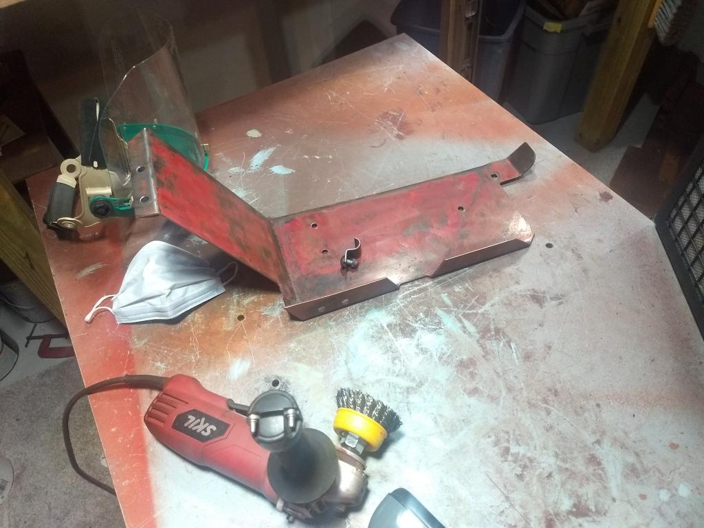

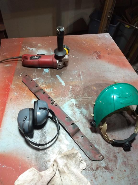

ebinmaine 80,976 #337 Posted February 16, 2020 On 2/2/2020 at 1:20 PM, pullstart said: So long as she has her painting socks on... Trina did a little more grinding on some "pahts" today. She wore different socks so you all would know she has different socks. Foot rest rear bracket Seat spring and back rest bracket. 2 3 1 Share this post Link to post Share on other sites

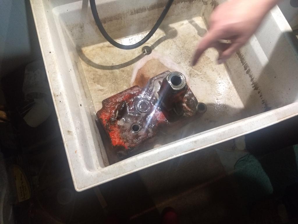

ebinmaine 80,976 #338 Posted February 16, 2020 I've left the transmission to drain for a couple weeks now. Cleaned out with brake clean and degreaser. That should be ready to reassemble when I get time. 2 Share this post Link to post Share on other sites

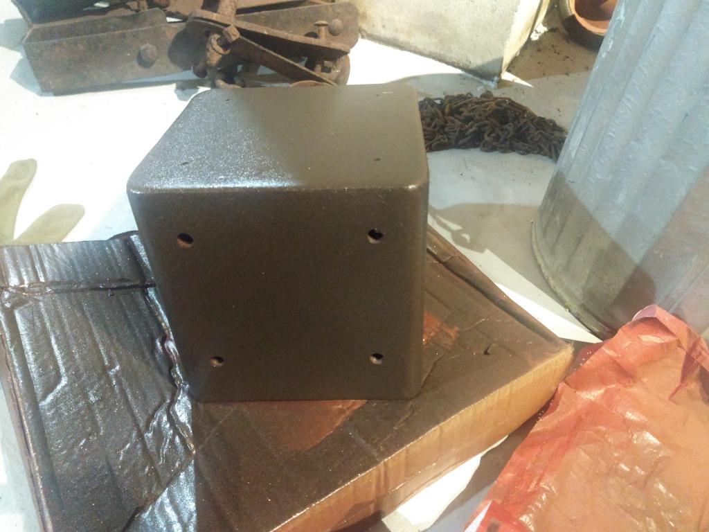

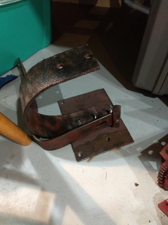

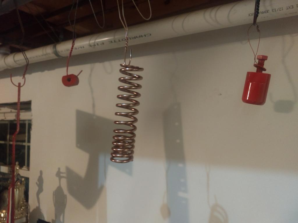

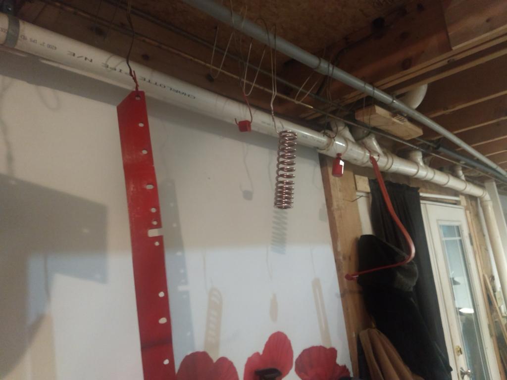

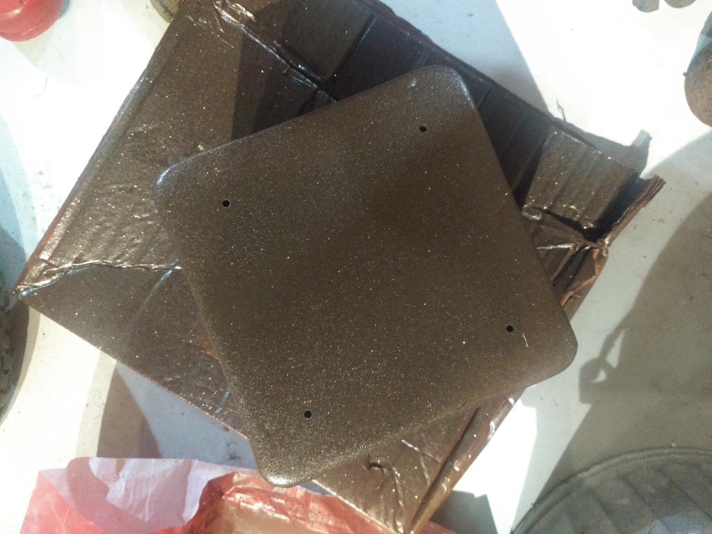

ebinmaine 80,976 #342 Posted February 17, 2020 More cleaning scraping wire brushing... And even a bit of painting. Trina put another coat of textured metallic brown on the frame-to-transmission adapter. LOVE this sparkle.... We each took a turn or 2 degreasing half the transmission case. She wire brushed a few things and painted some. *****NOTE the color of that spring. VERY nice copper. Here's the seat spring and base. And the seat back bracket I got from @Stepney 11 1 Share this post Link to post Share on other sites

ebinmaine 80,976 #347 Posted February 18, 2020 Just a little more cleaning/soaking/transmission inspection this evening. Trina and I checked over the roller bearings... Most bearings are in good condition. I have a bad outer roller bearing on one half... And a bad roller ball bearing in the other half. 1533?? I think I have other cases with decent 1533 bearings.... We shall see.... Share this post Link to post Share on other sites
