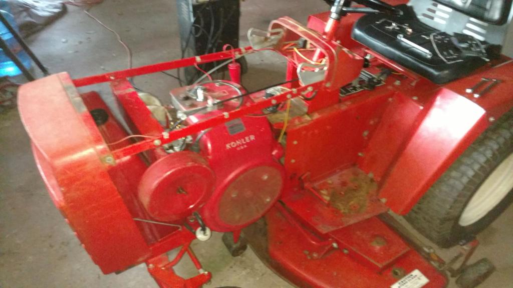

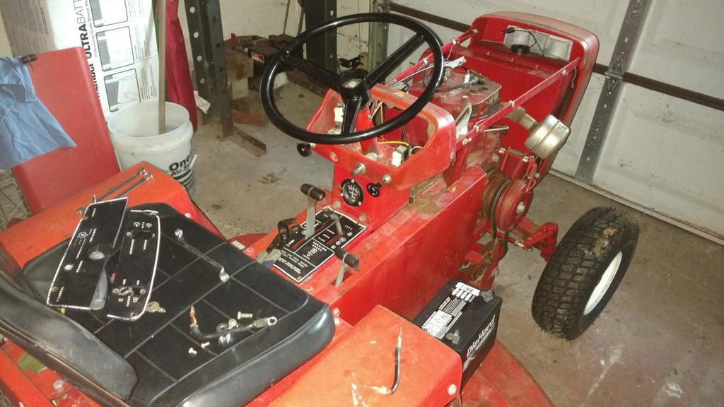

VBkid13 13 #1 Posted August 29, 2019 Hi Everyone, I am a rookie so please bear with me. I have been cruising this site for a little bit (still trying to navigate my way around) gathering all the info I can, there is a lot of great knowlege out there so...thank you! I recently acquired my dad’s 1970 or 1971 (I think it’s a 1971?) GT14 and I’m really excited about it. I spent many hours mowing our property when I was growing up so I kinda feel like it’s an old friend. It hasn’t been used for quite some time (my estimation is maybe 25 years). Luckily, it has been kept/stored inside most of its life. I, with the help of a great friend, am working on getting it going again and trying to get it into top shape. I am looking for a new/used working rocker switch for the lights, any suggestions? Also, what are the advantages of the 3 point hitch? I am familiar with a 3 point hitch with a rear pto, but not sure what it is used for without a rear pto. It has the belly mower deck which was used often and the front snowblower which was only used once. I am posting some pictures, it’s a work in progress. Thanks for listening to my saga.😁 I look forward to any advice, guidance or feedback, Bianca 2 11 Share this post Link to post Share on other sites

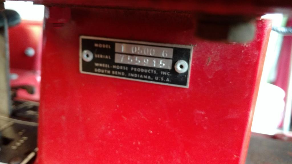

953 nut 65,081 #7 Posted August 29, 2019 Your father took very good care of your GT-14, glad to see it staying in the family. Most of us don't have the good fortune of having a long history with our . The only three point powered attachment I am aware of for the GT-14 is a rototiller that is belt driven from a special double pulley on the hydro pump. The model number on your GT-14 is a 1971 number so you are correct. This switch information should be helpful. 1 Share this post Link to post Share on other sites

p38js 441 #10 Posted August 29, 2019 Welcome to red square, I wish mine started out in the shape yours is in, as far as the switches go the light switch can still be found as they were used on different models the pto switch on the hand can be difficult to find and expensive, I took mine apart and cleaned the contacts and it seems to be working just fine, I also added a relay to the pto switch so the switch was not taking the load of the pto and arcing across the contacts in the switch. Good luck and have fun with it 2 Share this post Link to post Share on other sites

PeacemakerJack 10,917 #13 Posted August 29, 2019 Welcome to the forum Bianca! I’m so glad you found us and decided to join. That is one BEAUTIFUL GT-14. I’m so glad that it was passed on to someone who appreciates it for what it is and recognizes the sentimentality of those old memories. If you have any old pictures of you or other family members using or around the tractor, please post them. We love those old photos. So...what are your plans with the tractor? Are you planning to use it as a worker, getting running as a play machine, hang on to it as a fully functional show tractor, or... Looks like wiring is your biggest challenge right now. I can’t wait to see that thing running again. 3 Share this post Link to post Share on other sites
ebinmaine 78,166 #14 Posted August 29, 2019 8 hours ago, VBkid13 said: rocker switch if you can check the measurements on that rocker switch I might be able to give you a part number. Cole hersee makes a few. I keep a couple in stock for our 60s vintage tractors and I know they used them in the early 70s on other models as well. 1 Share this post Link to post Share on other sites
76c12091520h 4,133 #15 Posted August 29, 2019 I have both the headlight and pto switches on hand. They are all new old stock, send me a pm if interested. 3 1 Share this post Link to post Share on other sites

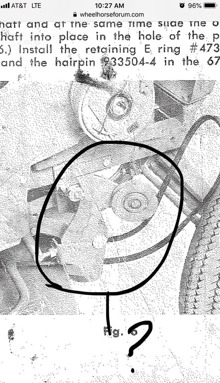

Treepep 1,104 #17 Posted September 7, 2019 Hello all! I too recently acquired a 1969 GT-14 that has been gifted to me by my retiring father. We mechanically restored it in the late eighties as I was finishing high school. At that time it frequently mowed an acre of our four acres a week. When I went to college my father restored an old Ferguson tractor and mowed all with that and the wheel horse was a backup and garden tiller. Each season the gas was treated or run dry and the oil was changed. 2019 and it still pops right off (as right off as the old cast iron 14hp kohler do) but you know what I mean. I am new to forums and seeking some wisdom as well. My machine is mostly complete and running. It has a tiller and I have successfully restored the mower deck. My main problem is the steering wheel and it is missing the directional pulleys under the tractor that would complete the mowing setup. I cannot find that part or any diagram so I could fabricate something. I am fairly certain that the original setup was gone when my father acquired it and he subsequently fabricated pulleys to make it work. Sorry for the long post, any help or guidance would be greatly appreciated. I have my old buddy back. I will post pictures as soon as I figure that out. Not a great interweb person. Better with old machines. Thanks Ken 4 Share this post Link to post Share on other sites

Treepep 1,104 #20 Posted September 7, 2019 Thank you for the information. As a hobby I have restored many old pieces of lawn equipment. Mostly tillers and mostly David Bradley. I am very much a wheel horse rookie. When we acquired it they were rare but around. I want to keep it from scrap however it seems like a black hole very much like finding David Bradley parts. It will run and till the rest of my life if I am still around. I would like it to mow on occasion as well. I know the deck we have is from the next generation 73-76. I also know that somehow my father made it work. The tractor now no longer has the puley(s)? on the passenger side. I believe I could make something but I have not found a place to start. I.E. no good pictures of what the original belt/pulley configuration. Runs and drives. Thank you Share this post Link to post Share on other sites
19richie66 17,858 #21 Posted September 7, 2019 (edited) @Treepep I may have the piece you are looking for but it is in NC in a storage shed. I’m going up next weekend so I can check. Edited September 7, 2019 by 19richie66 1 Share this post Link to post Share on other sites
Treepep 1,104 #22 Posted September 7, 2019 19richie66, Thanks for the response. If I just putt around the farm with it I will be happy. If I can procure the part from you or somewhere and get it back to some seasonal at my discretion work then great as well. Many thanks Ken Share this post Link to post Share on other sites
953 nut 65,081 #23 Posted September 7, 2019 A good alternative to the OEM method of driving a deck on your GT-14 would be to add a "Mule Drive". This thread by @daveoman1966 gives you all the information you will need to pull it off. Dave may be able to hook you up with the needed parts. If not I'm sure @Ed Kennell or @A-Z Tractor could. 1 Share this post Link to post Share on other sites
