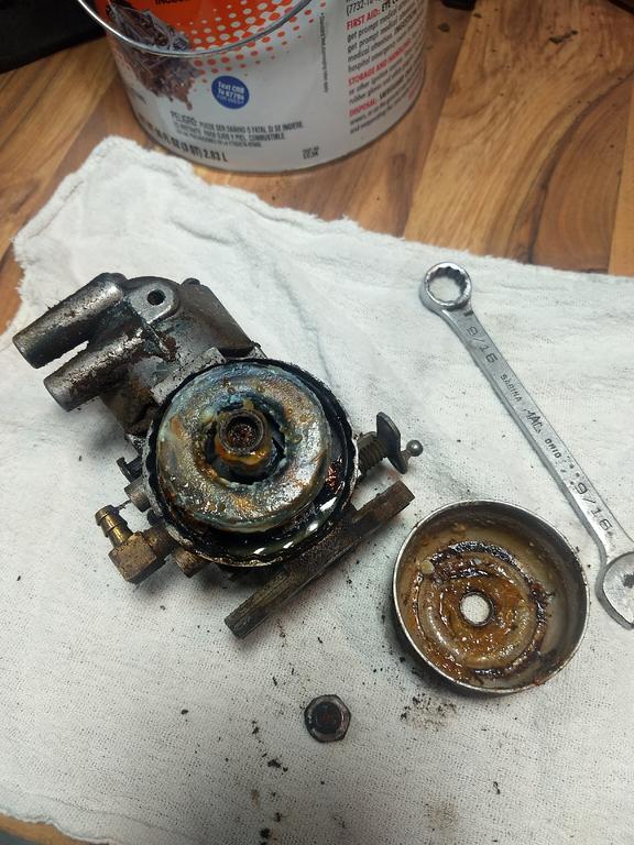

ebinmaine 75,840 #1 Posted August 18, 2019 I've messed around with carburetors big and small for maybe 25 or 30 years? This is definitely the one that is absolutely the worst condition I've ever seen. Several different types of corrosion and there is white and tan colored gel built up all inside of the fuel bowl area. Corrosion inside a couple of the galley holes blocked them so much I didn't even realize they were there. I took it all apart and carefully scraped it out and it is now soaking for a few days. One serious question though. The main jet is screwed into the bottom. That hole was literally filled with rust. I found that a little odd considering the carburetor is aluminum and the jet is likely brass? Maybe the bottom bolt holding the bowl on is steel and that's where the rust came from. That jet does NOT want to move. Is it super important that I take it out and clean in there or should I be able to just spray through or blow through with compressed air... 1 Share this post Link to post Share on other sites

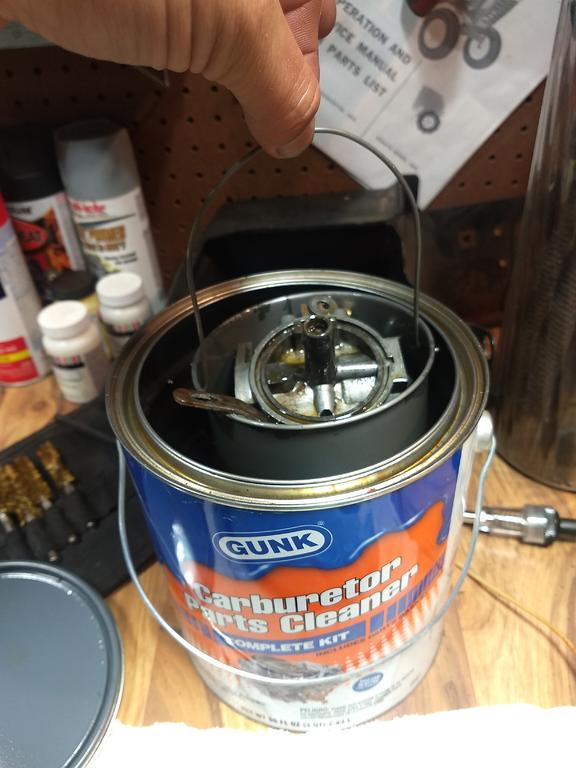

ebinmaine 75,840 #19 Posted August 25, 2019 @jabelman @Lee1977 @The Tool CribCri And others... I'll post more pictures in a few minutes showing the carb itself. This is the cleaner that I use. I've had it for a couple years and I can't remember why I did not buy the Berryman's but I've been very very satisfied with this Gunk brand kit. 1 Share this post Link to post Share on other sites

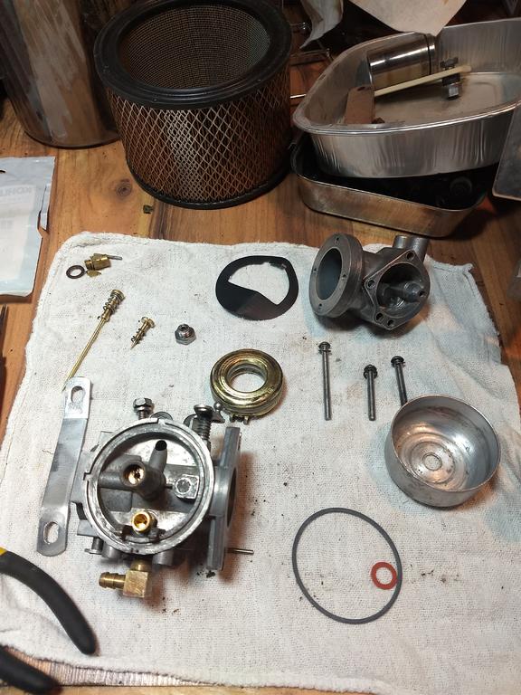

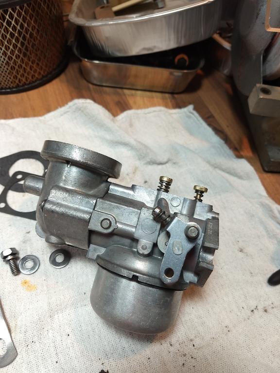

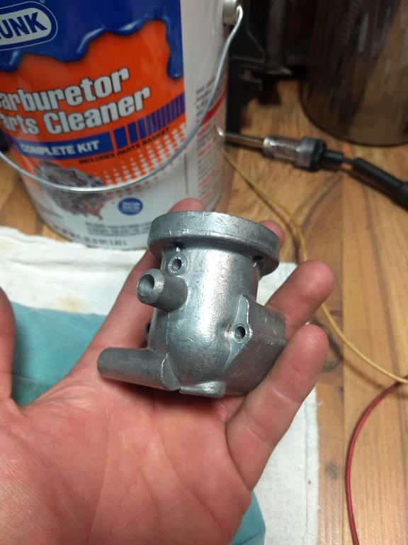

ebinmaine 75,840 #22 Posted August 25, 2019 Here's a couple pictures of the carburetor in its cleaned up state. I am extremely impressed with the way this thing came out. 2 days soaking. Removed all parts and gently brushed them by hand with a wire brush under lukewarm water. 4 more days soaking. Finished cleaning up with the wire brush and a little sandpaper where it was necessary. 2 Share this post Link to post Share on other sites
tunahead72 2,591 #23 Posted August 25, 2019 That's impressive Eric, it's hard to believe that's even the same carb! 1 Share this post Link to post Share on other sites
ebinmaine 75,840 #24 Posted August 25, 2019 2 minutes ago, tunahead72 said: That's impressive Eric, it's hard to believe that's even the same carb! Thanks! I'm installing it now so we will find out sometime today if it looks as good internally as it does externally. 1 Share this post Link to post Share on other sites
