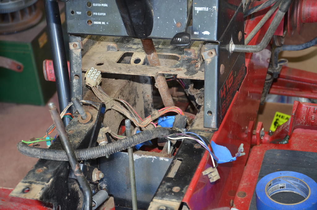

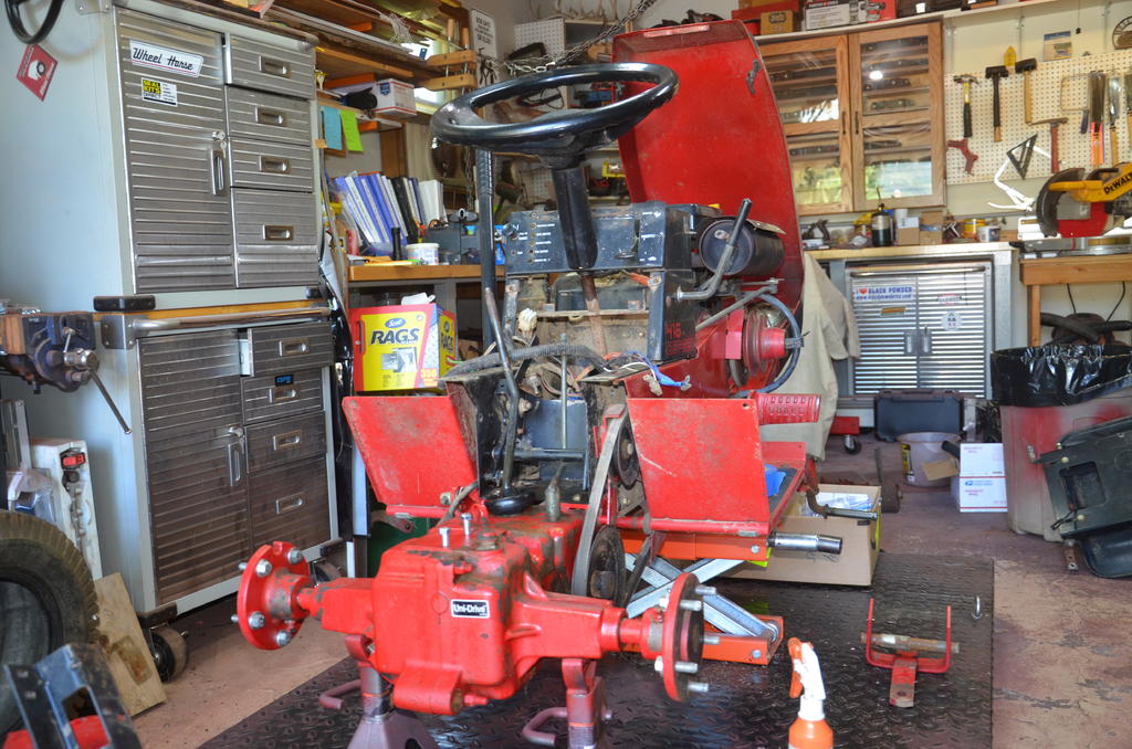

Got to spend a few hours disassembling, marking and bagging parts.
She's looking pretty naked.
Couple more small pieces to go before I get out the Oil Eater and the power washer.

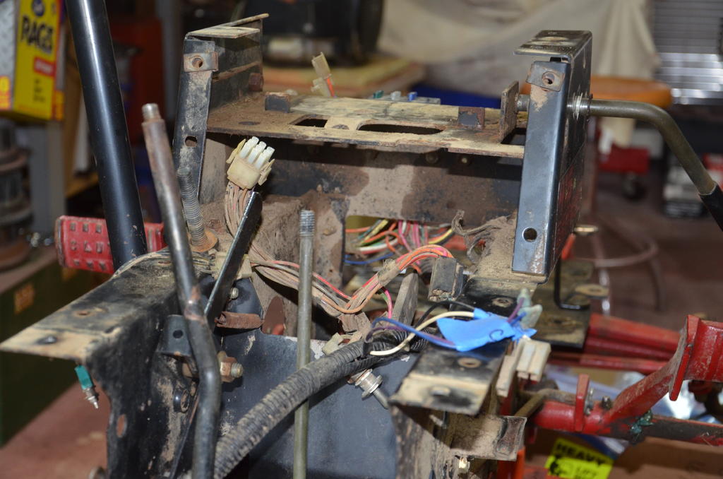

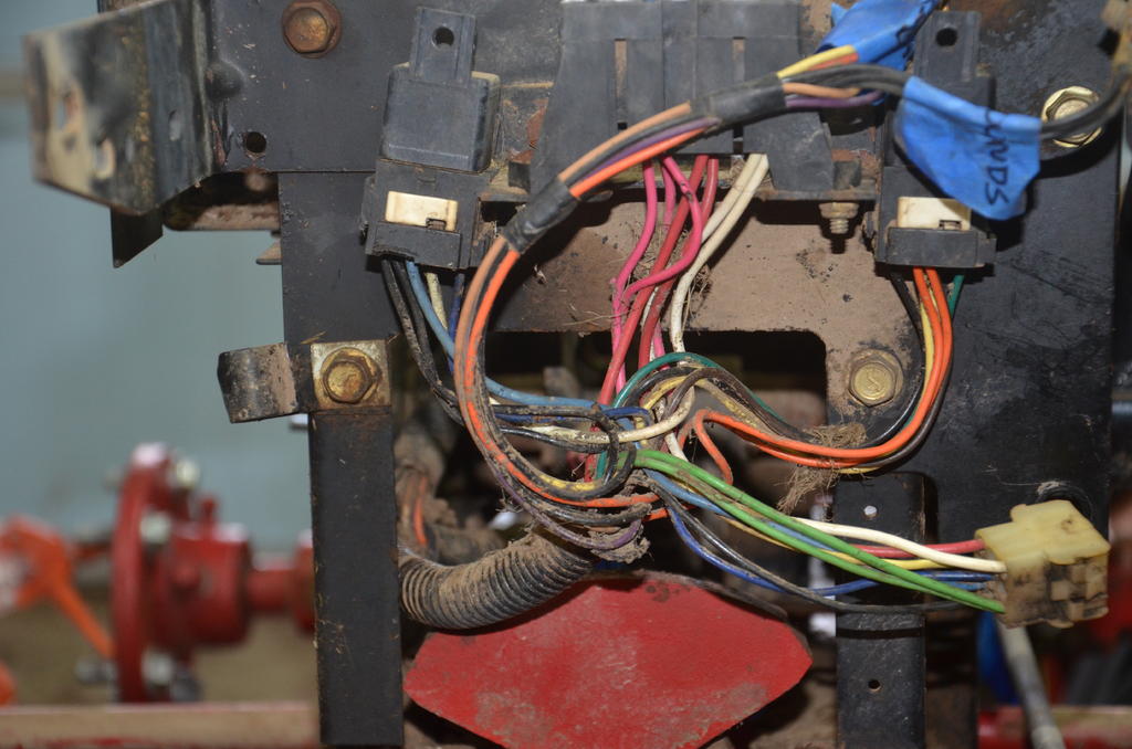

The one item I am wondering about is what to use the clean the wiring harness.
Its a combination of mud mostly and the assorted grease and mouse droppings
Any "helpful hints"???
  • Like 2
ebinmaine
Been a long long time since I've bought an e but there used to be spray cleaners for electric parts like a starter or whatever.
I wouldn't get too worried about using a garden hose and wiping most of the harness but maybe that electric parts cleaner in the terminal ends?
At reassembly... Probably reapply some dielectric grease.
  • Like 1
RJ Hamner
That's kind of what I was thinking. Was wondering what others had done in this situation. Rebuilding a harness for an early model isn't bad but rebuilding this one could be (for me) a nightmare:wacko:

Pullstart
I have a long air nozzle that I taped some 1/4” clear tubing to the end of in a siphon manner.  I mix up some simple green and water, put the tubing on the dip and blast away... then wipe it down and switch to just water for cleanup.  It’s a great all purpose cleaner and I believe a little water quickly dried is much different than storing it in a rain storm and weather.

I totally agree with @pullstart, from the photos your harness looks to be in pretty good shape other than the mud. Simple Green is pretty good stuff for this situation and generally just for wiring and connectors, water shouldn't do any harm since there are no electronics or circuitry involved.

Tractorhead
19 hours ago, RJ Hamner said:
- snip -
- / snip -
in the above pict, i think i see the pink wire in the middle upper front, short under the connector, looks like to be a bit depressed.
maybe it was clamped or scratched somwhere, that looked a bit of insulation was gone.
i would protect this by insulation Tape, to prevent shorts.
maybe i‘m wrong too.
but on the pict, it looks like so.
  • Like 1
RJ Hamner
Wow. Great eyesight
I’ll have to check that out. Everything was covered with so much crud there were places that you couldn’t tell what color the wire was.
Thanks

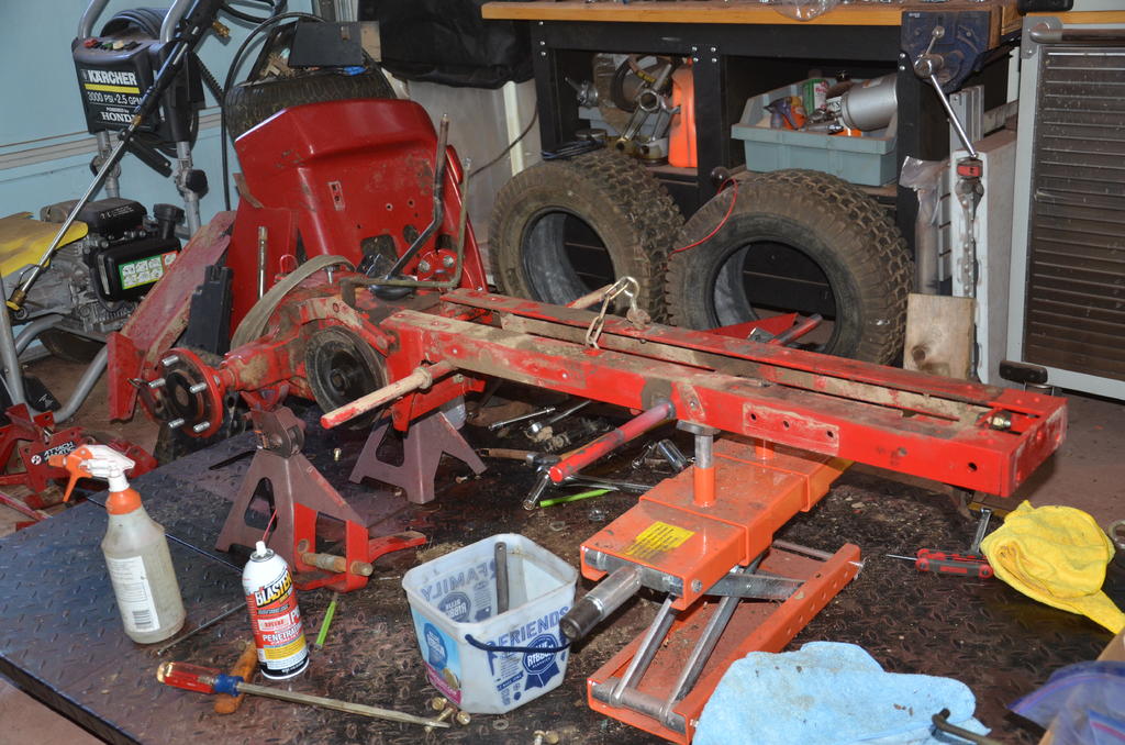

Its down to the bare transmission and the frame.
Been just a tad warm so haven't spent a whole lot of time in the shop.

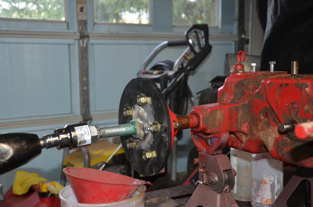

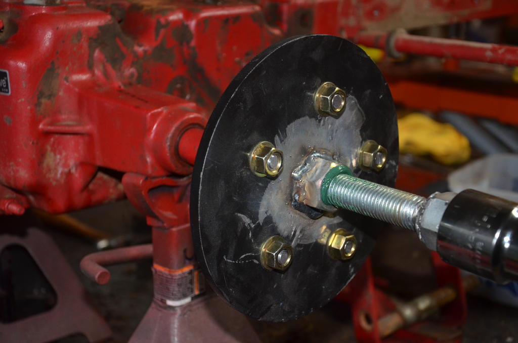

I needed to get the hubs off the axles and figured I needed a good way to get them off without destroying any more hubs.
Got to talking with Ed Kennell and did some LBR Engineering (LBR = Looks About Right)
Finally got all the parts I needed, did a little welding and tried it out tonight
The end result was the the hubs are off the axles and nothing got broken in the process:greetings-clappingyellow:
