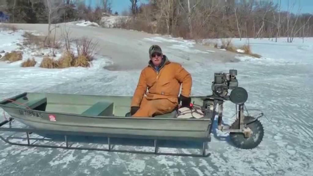

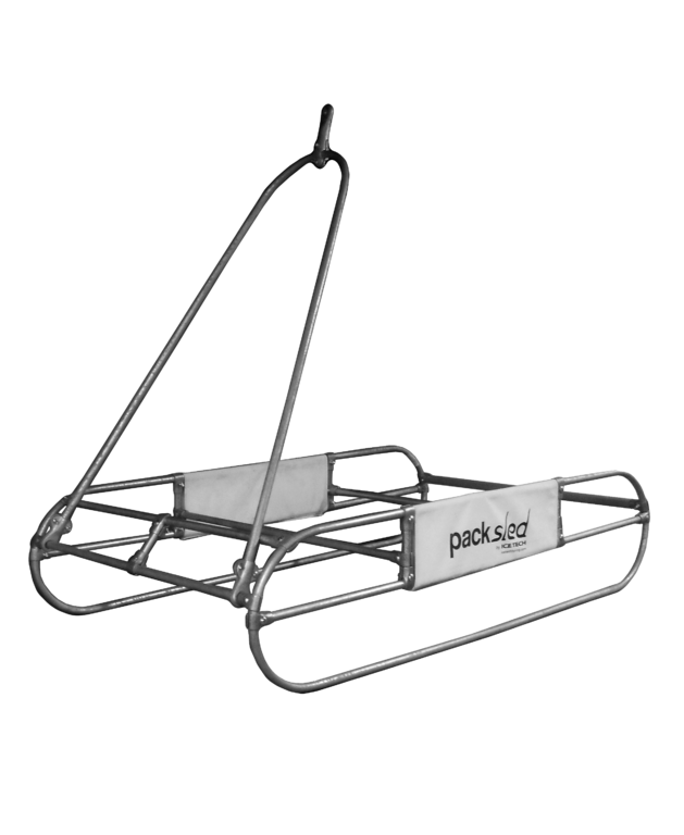

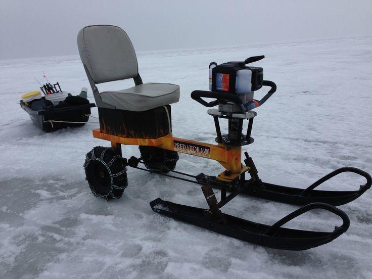

stevasaurus 23,627 #8 Posted August 13, 2019 Here are some ice fishing sled ideas. I saw a nice sled built out of conduit at a bait shop out side of Traverse City, Mich. Just some ideas here. Check this one out...I want to make this. 7 3 Share this post Link to post Share on other sites

wallfish 19,402 #16 Posted August 14, 2019 (edited) 18 hours ago, stevasaurus said: Check this one out...I want to make this. Personally I like the boat idea probably because it's a little crazy but that little driving sled is certainly cool too. Is the idea to use the ice auger engine to power yourself out there and then also use it again for the ice auger? Never mind, found this. https://www.outdoorhub.com/news/2015/01/08/ice-fisherman-develops-ice-auger-doubles-go-cart/ Edited August 14, 2019 by wallfish 1 Share this post Link to post Share on other sites
Lee1977 7,578 #17 Posted August 14, 2019 (edited) 2 hours ago, wallfish said: Personally I like the boat idea probably because it's a little crazy but that little driving sled is certainly cool too. Is the idea to use the ice auger engine to power yourself out there and then also use it again for the ice auger? Never mind, found this. https://www.outdoorhub.com/news/2015/01/08/ice-fisherman-develops-ice-auger-doubles-go-cart/ Pick up a vertical shaft Wheel Horse and adapt it for an ice-auger engine. And go in style. Edited August 14, 2019 by Lee1977 1 Share this post Link to post Share on other sites
