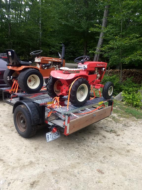

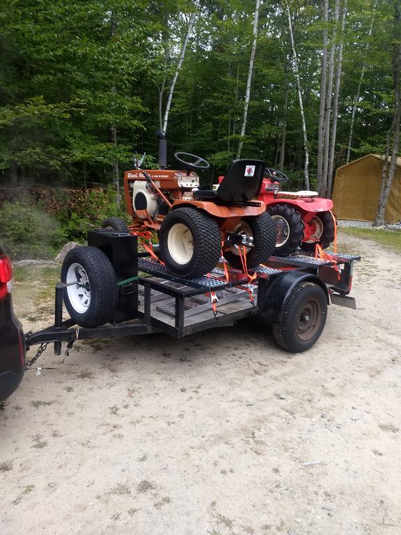

ebinmaine 78,340 #55 Posted September 14, 2019 On 9/1/2019 at 9:27 PM, Lee1977 said: You know we need PICTURES! Here's what we ended up with ladies and gentlemen. @RandyLittrell 3 2 Share this post Link to post Share on other sites

SALTYWRIGHT 861 #57 Posted September 14, 2019 I WOULD NOT TOW THAT OVER 20 M.P.H. VERY UNSAFE. I HAVE BEEN TOWING TRAILERS FOR OVER 75 YEARS. Share this post Link to post Share on other sites

ebinmaine 78,340 #59 Posted September 14, 2019 1 hour ago, SALTYWRIGHT said: I WOULD NOT TOW THAT OVER 20 M.P.H. VERY UNSAFE. I HAVE BEEN TOWING TRAILERS FOR OVER 75 YEARS. Curious to know why you think that? 1 hour ago, Lee1977 said: You did that all by yourself while Trina was painting the house? Yeah well..... I gotta do some things... Share this post Link to post Share on other sites
SALTYWRIGHT 861 #60 Posted September 14, 2019 ALL THE WEIGHT IS UP TOO HIGH. THAT IS ALSO OVER WHAT YOUR TOW CAR IS RATED FOR. STRAPS TO HOLD TRACTORS ARE NOT ON RIGHT. YOU NEED SOME THING TO TIE THE TRACTORS TO. Share this post Link to post Share on other sites
ebinmaine 78,340 #61 Posted September 14, 2019 2 hours ago, SALTYWRIGHT said: ALL THE WEIGHT IS UP TOO HIGH. THAT IS ALSO OVER WHAT YOUR TOW CAR IS RATED FOR. STRAPS TO HOLD TRACTORS ARE NOT ON RIGHT. YOU NEED SOME THING TO TIE THE TRACTORS TO. No worries Russ. As a professional CDL driver and having spent many hours in training with DOT and OSHA I assure you it's safe to use. I've even consulted with a commercial trailer and truck body builder. The tractors and trailer weigh a combined 1600 lbs or so. The cross ramps are rated at 1000 lbs. The heavier of the two is 575. The ramps are bolted to the trailer rails with 4 bolts each. DOT rules require 2 straps. Each tractor is held down with 4 straps. Each strap is WLL rated to hold more than the weight of a tractor. . Trina and I are both VERY safety conscious both by mindset and training. 3 Share this post Link to post Share on other sites
SALTYWRIGHT 861 #62 Posted September 14, 2019 GOOD LUCK WITH IT. 1 Share this post Link to post Share on other sites
Mike'sHorseBarn 3,484 #63 Posted September 16, 2019 Looks good EB! Trailer looks nice and sturdy. That old trailer that I showed you that I was working I just got back from sandblast and powder coat. I finished the axle over the weekend, new bearings and races and then I coated the axle and leafsprings with spray on bed liner. Hopefully that will be a little tougher than paint. 1 Share this post Link to post Share on other sites
ebinmaine 78,340 #64 Posted September 16, 2019 1 minute ago, Mike'sHorseBarn said: Looks good EB! Trailer looks nice and sturdy. That old trailer that I showed you that I was working I just got back from sandblast and powder coat. I finished the axle over the weekend, new bearings and races and then I coated the axle and leafsprings with spray on bed liner. Hopefully that will be a little tougher than paint. Sounds like yours should be pretty rugged with that spray on bed liner. That's usually pretty tough stuff. We took this on our maiden voyage down to see @JCM Jim and his family over the weekend. It went excellent. One thing that is important to remember is that this is NOT a box store cheap landscape trailer. My trailer has a net load carrying capability of over 2500 lb. GVW is 3400 lb. The side rails on this trailer were overbuilt right from the factory and are in great condition. I do want to thank @SALTYWRIGHT Russ for bringing some things to my attention. I was not super happy with the way the Cinnamon was rocking about 1/2" on the way down. At Russ's attention-getting I changed the way we did the straps for both tractors. On the return trip and I was much much happier. No movement whatsoever. 3 Share this post Link to post Share on other sites
