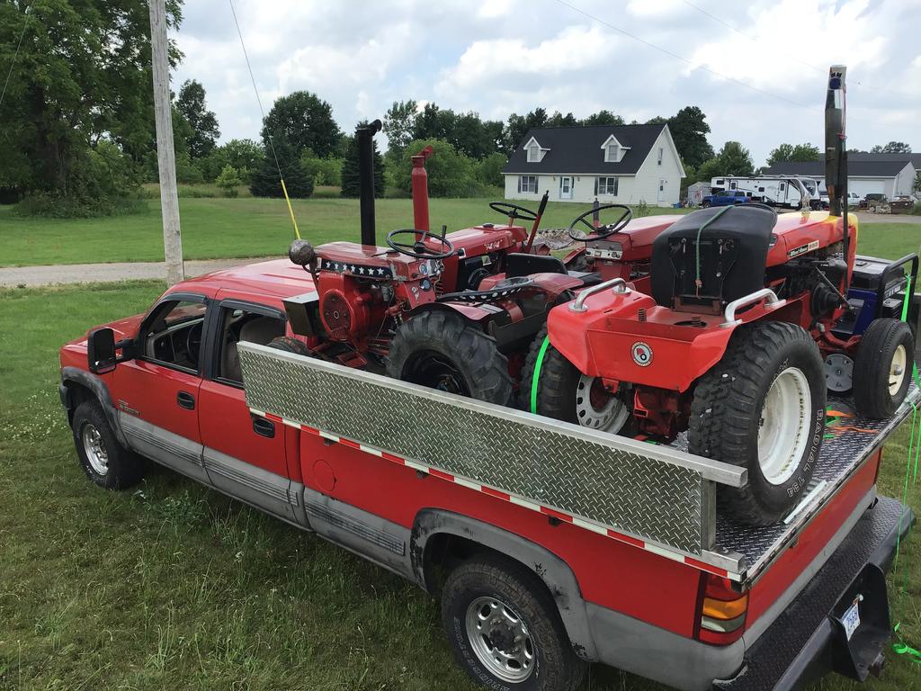

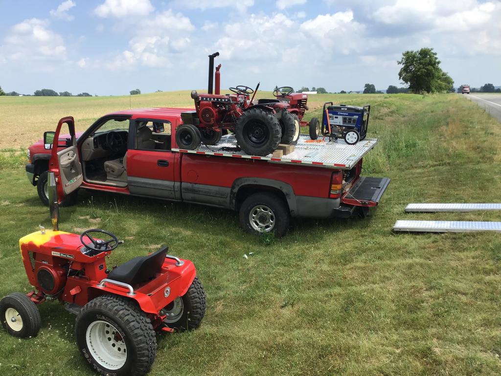

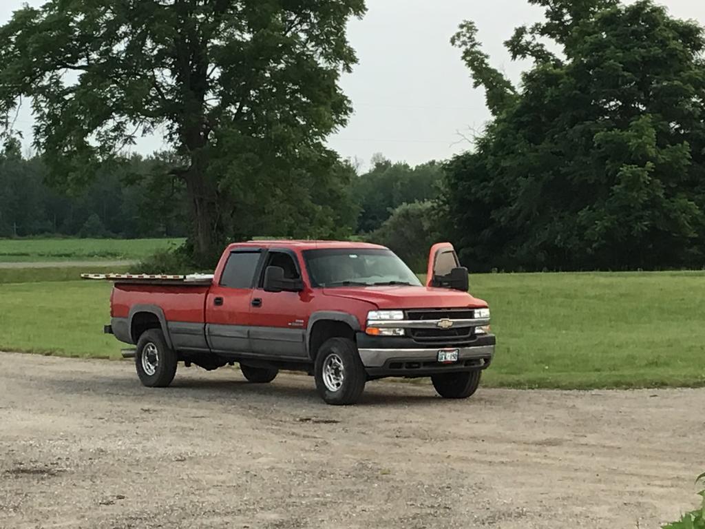

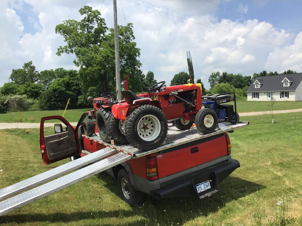

JAinVA 4,638 #4 Posted July 30, 2019 (edited) Eric have you seen the platform Pullstart (Kevin) fabbed up for his truck? If you go that route he probably has a lot of tips.Slick setup. Edited July 30, 2019 by JAinVA 2 1 Share this post Link to post Share on other sites

Pullstart 71,298 #12 Posted July 31, 2019 Eric, I built my deck over strictly out of necessity needing to pull the RV and haul tractors at the same time. We considered looking at toy haulers but because we got such a good deal on our camper, we soon realized we’d be doubling our cost in the camping end of the spectrum to find a reasonable replacement... then thought of just driving two trucks. As as far as trailers go, I tend to overthink and overbuild and over pack. I followed (at a safe distance) a motorhole hauling a Suzuki Samauri on a single axle utility trailer last year heading up north on the interstate. I wouldn’t ever think to put that load on one utility axle, but it was probably rated to do so. I’d be more comfortable looking for a dual axle trailer for the redundancy of an extra footprint. Now we get to your situation. I would think you’re crafty enough to somewhat duplicate the deck-over idea and overbuild it to hold your horses (ha! Hold your horses, Mister!) and keep a bit of room for storage. You have plenty of tree limbs to help with loading and unloading of the deck, right? A simple pulley system would help to get it off the trailer for gravel use. It would also hold you over until you’re in the truck market to get a bigger trailer at the same time. I like the deal that @dells68 got on his trailer this spring/summer and would love to add something like that to my hauling fleet! I also have an 8x8 snowmobile trailer. Little did I know, someone hauled something quite heavy at one time and the axle was bent pretty bad. The tires looked great from the outside, but the inside tread was nearly gone. I jacked the axle up and welded in a support to give it a little upward now, to anticipate a load like the semi flat beds do. It hauls better and I trust it for a couple tractors now... but loading with the tilt mechanism is still a bit cumbersome. You’d have to load simultaneously or half load one, then drive the other up, block and strap it, then finish the other to use the tilt... or simply use ramps from the stationary position. 2 1 1 Share this post Link to post Share on other sites
