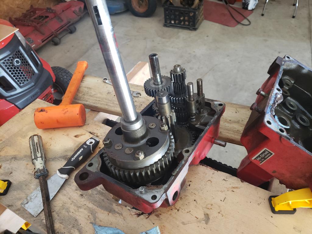

Gordyhogg 150 #27 Posted December 8, 2019 Thanks so much! I just ordered those three...a little pricey but gotta have it... cant believe those darn 1533's are $45 a piece! But theres nobody else who has them...Cant wait to get this one back together n plow some snow! Heres some more pics of the teardown. 2 Share this post Link to post Share on other sites

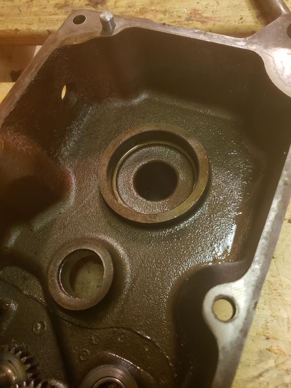

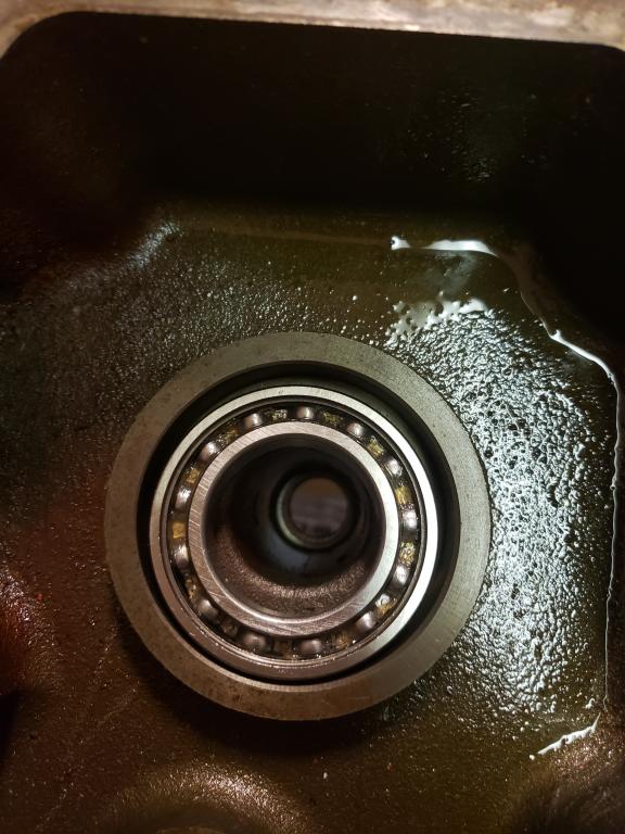

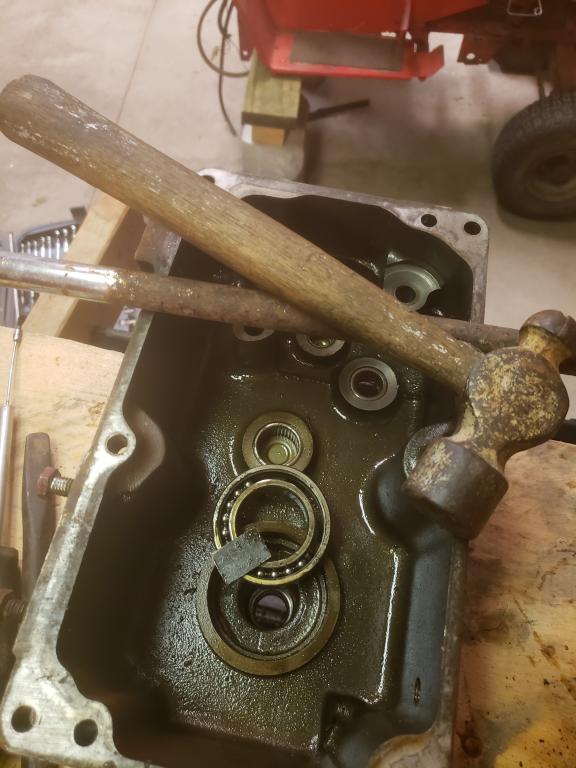

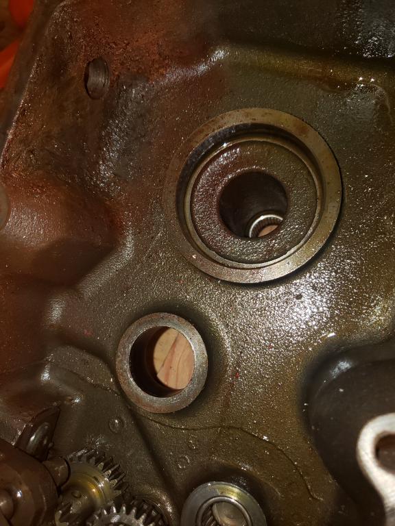

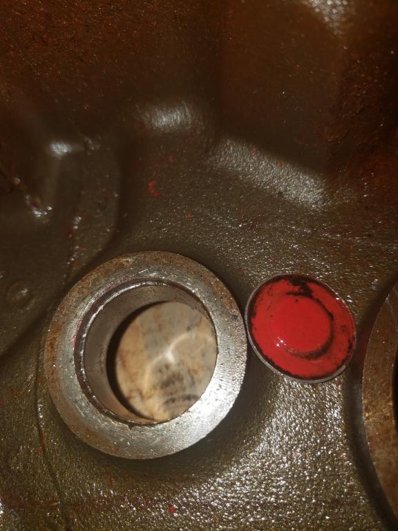

Gordyhogg 150 #34 Posted December 9, 2019 Good news and bad news...the good news is my bearings are supposed to come thursday and i successfully removed the 1533 bearings using @dclarke's idea and it worked great! No having to rent a puller just used what i had laying around the shop. The BAD news is...upon trying to remove the 1532 capped bearing...i managed to break the cap off and am not real sure how to remove the rest of the "sleeve". Share this post Link to post Share on other sites
953 nut 68,789 #35 Posted December 10, 2019 (edited) If you take a small punch or awl and drive ti between the casting and the bearing remains it will bend inward and slip right out. Lubricate the new bearing well and drive it in gently from the outside. Edited December 10, 2019 by 953 nut 2 Share this post Link to post Share on other sites
Burnerman 759 #36 Posted December 10, 2019 You did the same as me I bet. The capped end popped right off didn’t it? 😲 I found a socket that was a millimeter smaller than the bearing OD and used that to evenly tap out the outer race of the bearing from the case. A wooden handle maybe able to be used also. Just don’t damage the case. It’s a press fit and will come out fairly easily. Share this post Link to post Share on other sites
Gordyhogg 150 #37 Posted December 10, 2019 Hahaha sure did! I will definitely try those tips out guys thank you! Thats my biggest fear is damaging the case ive got 4/5 bearings out sucessfully so far im aiming for 5/5. Share this post Link to post Share on other sites

Gordyhogg 150 #46 Posted December 12, 2019 It came out!!! I had a genious idea! I used my old outer axle bearing to use as the awl to punch it out. Turns out they are the same o.d. so i then just tapped that back out and there we go! 1 Share this post Link to post Share on other sites

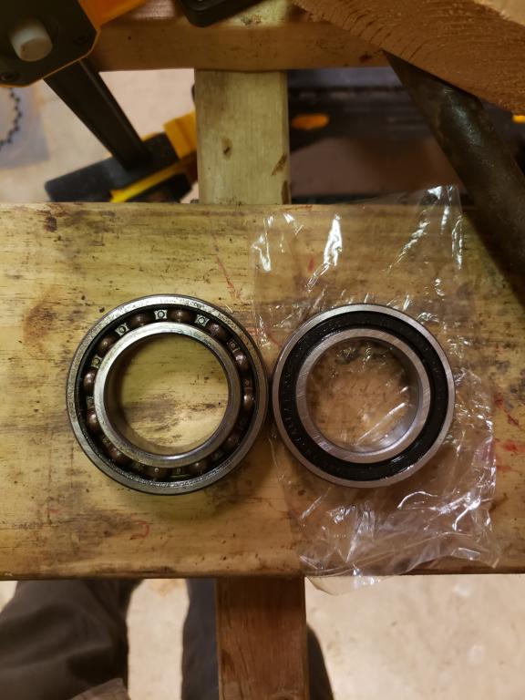

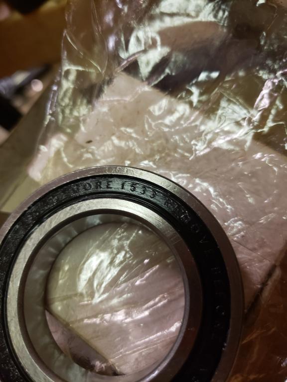

Gordyhogg 150 #48 Posted December 12, 2019 PROBLEM!!!! THE 1533'S DONT FIT!!! what do i do?? 1 Share this post Link to post Share on other sites
Gordyhogg 150 #49 Posted December 12, 2019 (edited) Size comparison...new one is on the right and it is indeed marked 1533 Edited December 12, 2019 by Gordyhogg 1 Share this post Link to post Share on other sites
953 nut 68,789 #50 Posted December 12, 2019 6 minutes ago, Gordyhogg said: THE 1533'S DONT FIT!!! You bought the bearings from Lowell @wheelhorseman right? Best give him a call, he is first class and will make it right for you. Share this post Link to post Share on other sites
