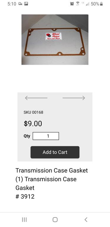

Gordyhogg 150 #17 Posted July 29, 2019 (edited) Thank you @stevasaurus i still have to tear the tractor apart and get this thing opened up. Ive already sourced the needle bearings and two more new seals from napa. Hopefully i wont have to order any more bearings etc; any idea which transmission this is and where i can find a case gasket? I think and hope thatll be the last piece to the puzzle...Also my flat pulley on my mule drive is completely toast and my shifter boot is too and i have those on the way from ebay Edited July 29, 2019 by Gordyhogg Share this post Link to post Share on other sites
pfrederi 21,274 #18 Posted July 29, 2019 8 speed transaxle case gasket WH# 3912 Still available from Toro 1 Share this post Link to post Share on other sites
stevasaurus 23,861 #19 Posted July 29, 2019 Your transmission should be a #110995...4 pinion with 1" axles. That TORO gasket is about $6.00 Share this post Link to post Share on other sites
Gordyhogg 150 #20 Posted July 29, 2019 This look correct? Share this post Link to post Share on other sites
stevasaurus 23,861 #21 Posted July 30, 2019 That would be it. Share this post Link to post Share on other sites

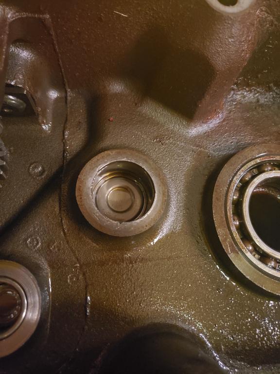

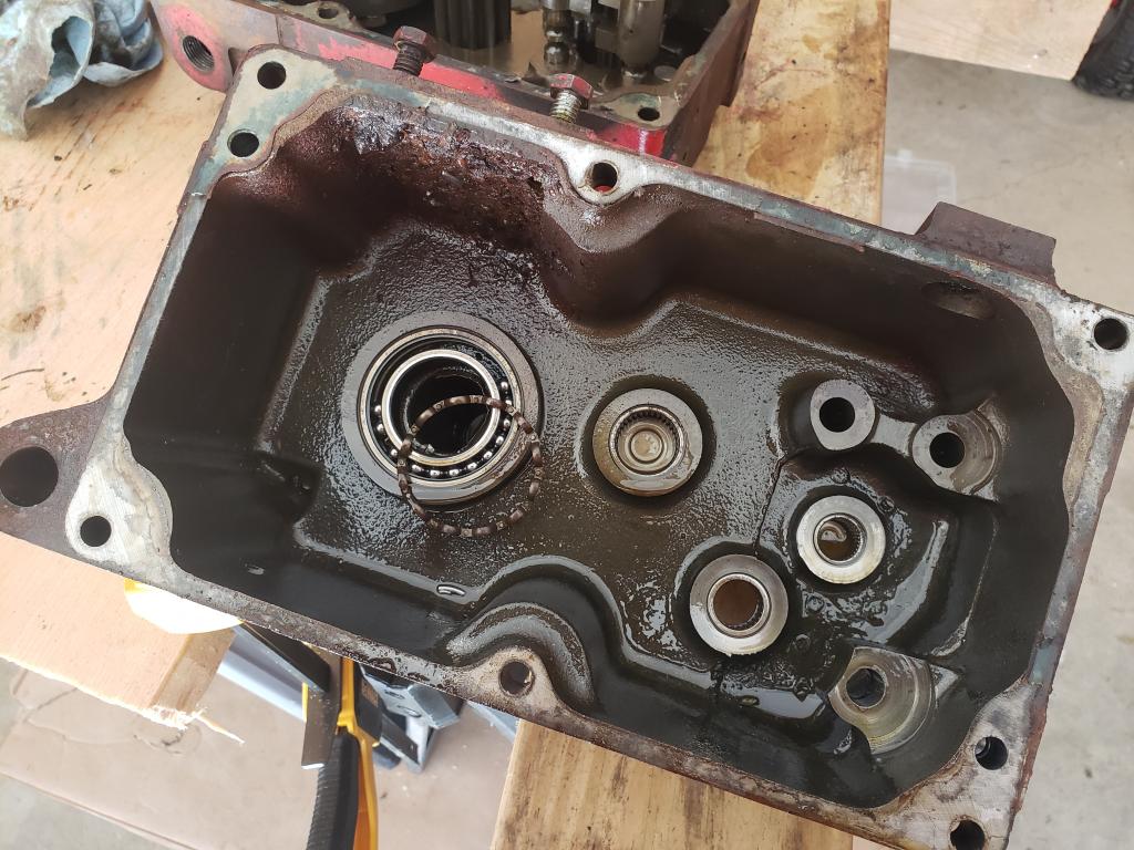

Gordyhogg 150 #23 Posted December 7, 2019 (edited) Finally tore it apart. Found there were a couple more bearimgs bad than i thought. Anybody know the part numbers for these? One is the big inner axle bearing and the other is where i believe the mushroom gear sits? (I think thats what its called) and yes, thats how i found them...broken/ and or completely missing...drained all the loose needle bearings with the oil. Edited December 7, 2019 by Gordyhogg 1 Share this post Link to post Share on other sites
pfrederi 21,274 #24 Posted December 8, 2019 One of our vendors has what yo need. he is only source for the big ball bearing 1533. https://www.wheelhorsepartsandmore.com/bearings.html 1 Share this post Link to post Share on other sites

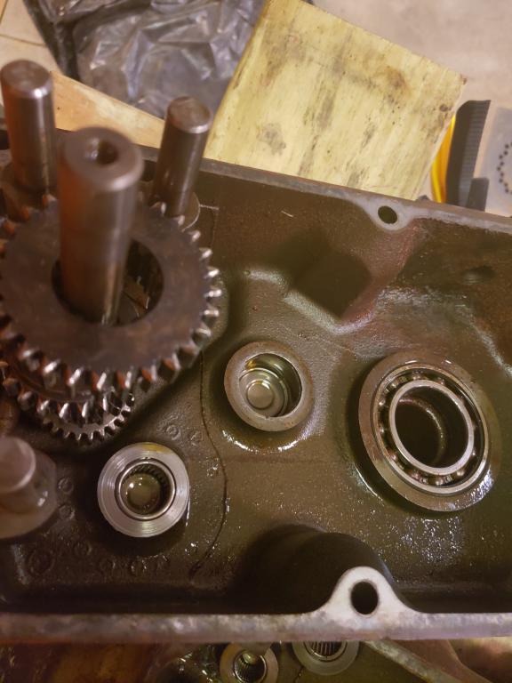

Gordyhogg 150 #25 Posted December 8, 2019 (edited) Thanks! Do you recommend i replace both 1533's? And do you have any idea what number the other bearing is? (2nd pic) Its totally gone i just know it was a needle bearing and the big mushroom gear sat in it there was so much slop but surprisingly the transmission operated fine with no noises before i tore it apart minus the leaking axle. I already replaced both outer axle bearings and seals just need to order these and get it put back together (hopefully) Edited December 8, 2019 by Gordyhogg Share this post Link to post Share on other sites
