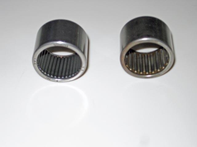

pfrederi 21,214 #18 Posted July 17, 2019 1 hour ago, stevasaurus said: Like Bob said...the 1976/77 8-speed horses all used the 8 pinion differential with 1 1/8" axles. They are the strongest. They used the #5091 and the #103916 transmissions. To know what the differences may be between those 2 transmissions, you have to go through the parts list. The only difference I saw...the #5091 uses the #1526 outer axle bearing and the #103907 uses #105219. What that means...you got me. #1526 is the same as KOYO # B-1816 and measures 1 1/8" x 1 3/8" x 1".........I'll bet the #105219 measures the same thing. Why do I think that?? The case halves and the axles are the same part numbers in both transmissions. The rest of the internals are all the same. Steve most trannies i have opened have had full complement needle bearings some have a spacer ring and only about half as many needles. maybe the reason for the different part numbers??? 2 Share this post Link to post Share on other sites
stevasaurus 23,857 #19 Posted July 17, 2019 Excellent point Paul, but the only way to know for sure (I think) would be to get a #105219 from TORO. We know the #1528 is a full compliment needle bearing. Too bad Wheel Horse bearing numbers do not cross over on anyone's list. I have not ran into any of those spacer ring bearings...how many have you ran across?? They should still be inter-changeable.?? 1 Share this post Link to post Share on other sites
pfrederi 21,214 #20 Posted July 17, 2019 They are identical size and interchangeable, I think I found them in two transmissions but it has been awhile.... They are torrington J-1816 instead of the normal B-1816 full complement. 1 1 Share this post Link to post Share on other sites

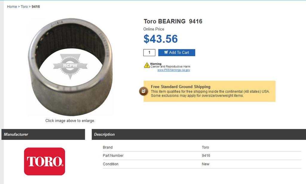

pfrederi 21,214 #22 Posted July 17, 2019 (edited) Mystery solved!!!! The 105219 was replaced by 9416. Looked it up at RCPW and they show a picture of the J-1816. I see that at my bearing source the J is 19.53 the B is 7.09 Edited July 17, 2019 by pfrederi Share this post Link to post Share on other sites
stevasaurus 23,857 #23 Posted July 17, 2019 WOW!!! What a team Paul...thanks. So that is the difference between the #5091 and the #103907. You know how many times I try not to learn something every day?? 1 Share this post Link to post Share on other sites
pfrederi 21,214 #24 Posted July 17, 2019 OK so from a strength/reliability standpoint which is the better bearing???? 1 Share this post Link to post Share on other sites
stevasaurus 23,857 #25 Posted July 17, 2019 I'm going to vote negledgeable. Reason being...the #1528 or B-1816 has lasted 40, 50, 60 years without being replaced in most transmissions. At almost 1/3 the price of the "J"-1816 and knowing that it made it's appearance in the 1976 transmissions...why spend the extra money. If you maintain your transmission, I see no need to spend the extra bucks. I also kind of like the extra bearings supporting the axle on the out ends. Share this post Link to post Share on other sites
