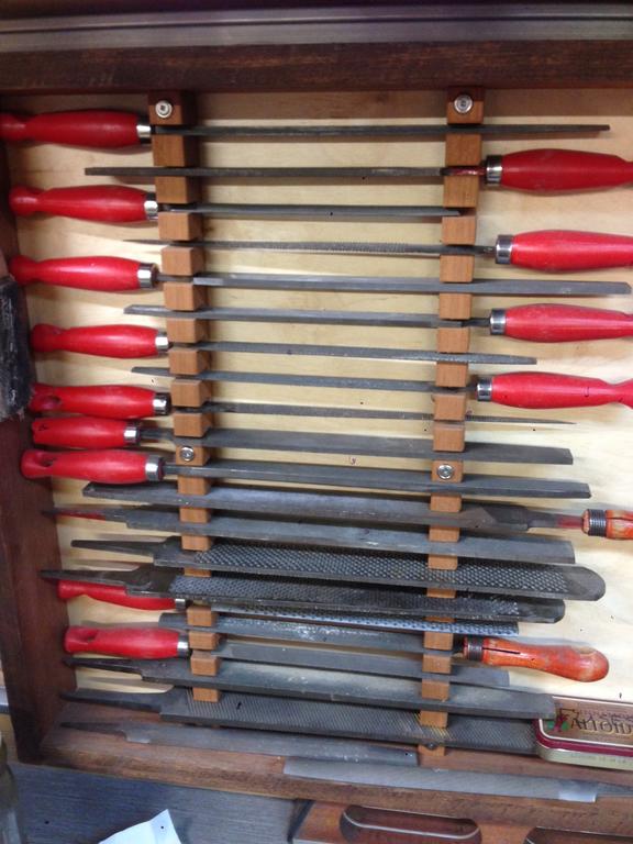

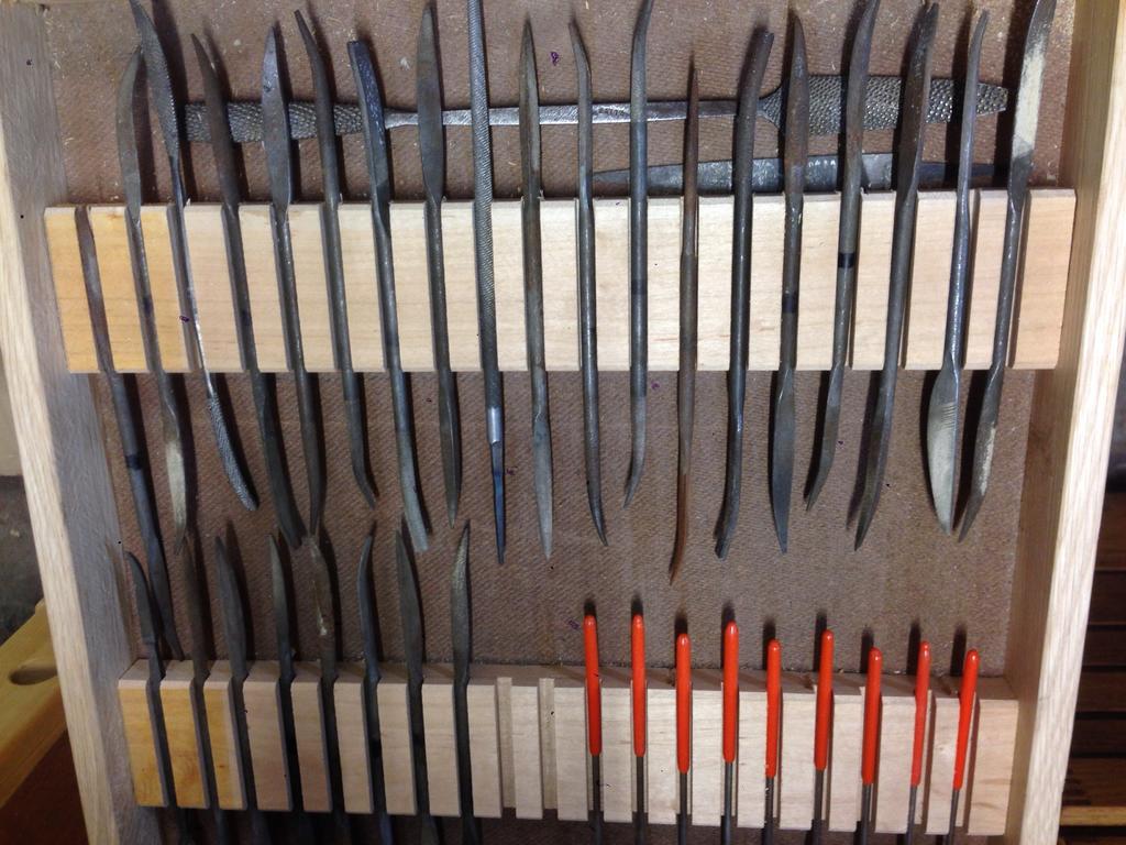

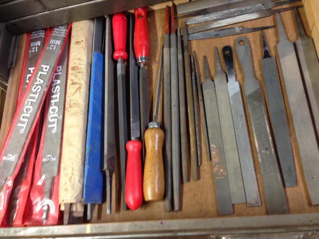

formariz 12,381 #12 Posted July 11, 2019 (edited) I have cleaned rusty and clogged files all my life. Best method for me is electrolysis if they are badly rusted or clogged. After each use I clean them with a card file. I keep dedicated files for different materials, such as bronze, brass, steel, and aluminum as the most used ones. Also separate ones for wood, plastic laminate etc. Never let them touch each other, keep them separate and protected. They are cutting tools such as a chisel and should be protected as such. Old dull files are great for making other tools such as lathe chisels and other cutting tools. They are great steel. Edited July 11, 2019 by formariz 3 2 1 Share this post Link to post Share on other sites
