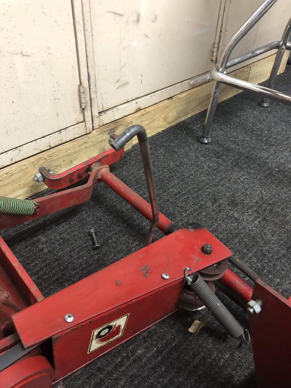

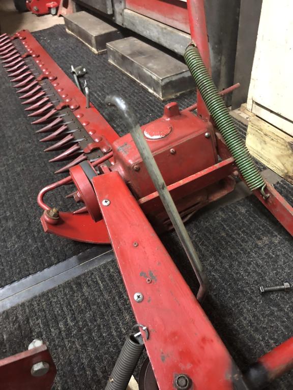

dkg520 531 #1 Posted July 3, 2019 Is this silver rod a part of this sickle bar? And if so what does it do and where does this attach? Thanks Share this post Link to post Share on other sites
Stepney 2,356 #2 Posted July 3, 2019 Yes, that's the correct lift rod. It attaches to your implement rockshaft at the dash tower, just as a deck/plow etc would. I think you use the inner hole on the shaft.. atleast thats how it was on mine. You don't want the higher lifting one, if you have a hydro like me it'll destroy the weakest part once the sickle lifts.. IE that rod. 1 Share this post Link to post Share on other sites

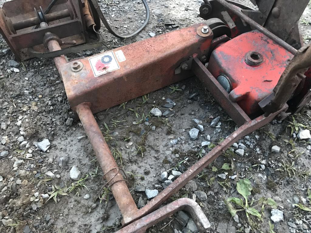

dells68 7,499 #6 Posted July 7, 2019 Alright guys your on the topic I’m needing help on! I bought a sickle bar at the Big Show, but it’s missing the lift rod. I don’t see anywhere on mine to mount it. @dkg520, is there any chance I could get you to snap a pic of how it mounts to your sickle bar? There doesn’t appear to be a mounting spot for a rod on mine. Dimensions on its placement on the sickle wood be helpful too. Here’s a pic of mine. 1 Share this post Link to post Share on other sites
Shynon 7,604 #7 Posted July 7, 2019 1 hour ago, dells68 said: Alright guys your on the topic I’m needing help on! I bought a sickle bar at the Big Show, but it’s missing the lift rod. I don’t see anywhere on mine to mount it. @dkg520, is there any chance I could get you to snap a pic of how it mounts to your sickle bar? There doesn’t appear to be a mounting spot for a rod on mine. Dimensions on its placement on the sickle wood be helpful too. Here’s a pic of mine. some of the early ones did not have a hole for a lift rod, nor did they have a belt cover on the front where the lift rod is installed Share this post Link to post Share on other sites
dells68 7,499 #8 Posted July 7, 2019 1 minute ago, Shynon said: some of the early ones did not have a hole for a lift rod, nor did they have a belt cover on the front where the lift rod is installed Ok Tom, that brings my next question. Could I make a mount to fit in place of the cover to keep from altering my sickle bar? I don’t want to mess it up! Share this post Link to post Share on other sites
Shynon 7,604 #9 Posted July 7, 2019 @wheelhorseman added a hole to his for the lift bar, he may have the measurements. I have an NOS cover for one. Share this post Link to post Share on other sites
