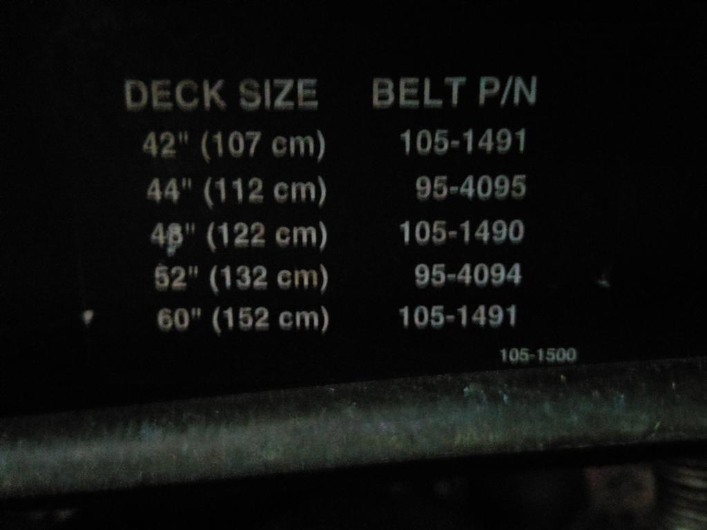

Can someone tell me how long is the drive belt from the engine to the mower deck is? 522xi with a 52" side discharge mower deck.

Thanks, but that just tells me the part number. Not length.

Sorry not even parts tree is showing size...https://www.partstree.com/parts/toro/parts/95-4094/
Drive belt 95-4094 (HB x 96.72" or 5/8" x 96.72")
Spindle belt 95-4228 (HA x 82.04" or 1/2" x 82.04")
