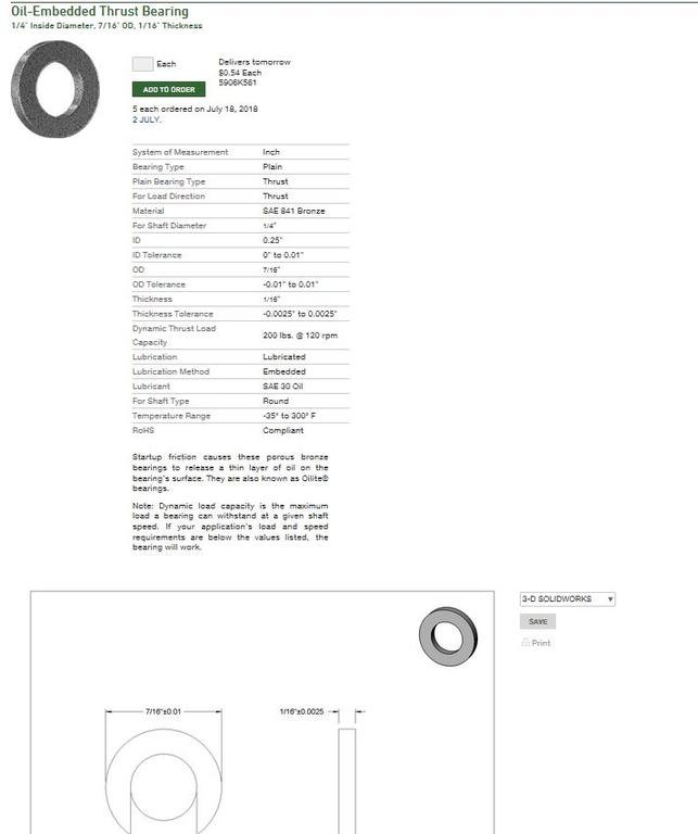

pfrederi 19,794 #16 Posted June 5, 2019 Or if you do not have and Ace.... 1 1 Share this post Link to post Share on other sites
JCM 10,638 #17 Posted June 5, 2019 Look's like a page out of a McMaster-Carr catalog.@squonk I am already goofy enough and a trip to P.A would put me over the edge listening to all you Guy's,though that may not be a bad thing at all. 1 2 Share this post Link to post Share on other sites
