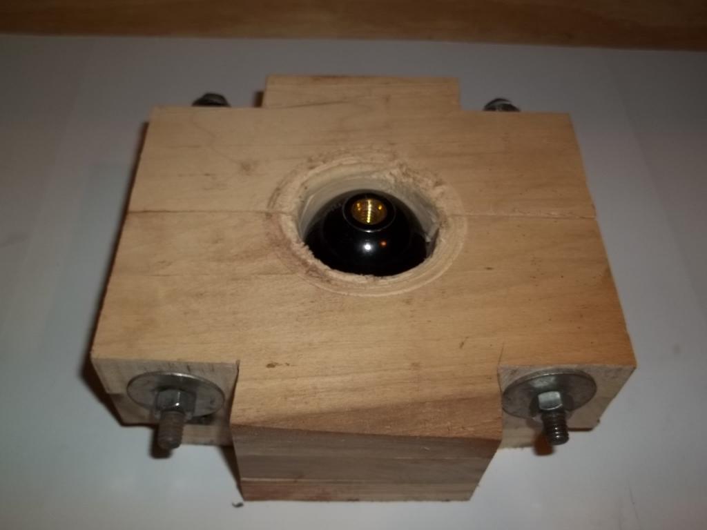

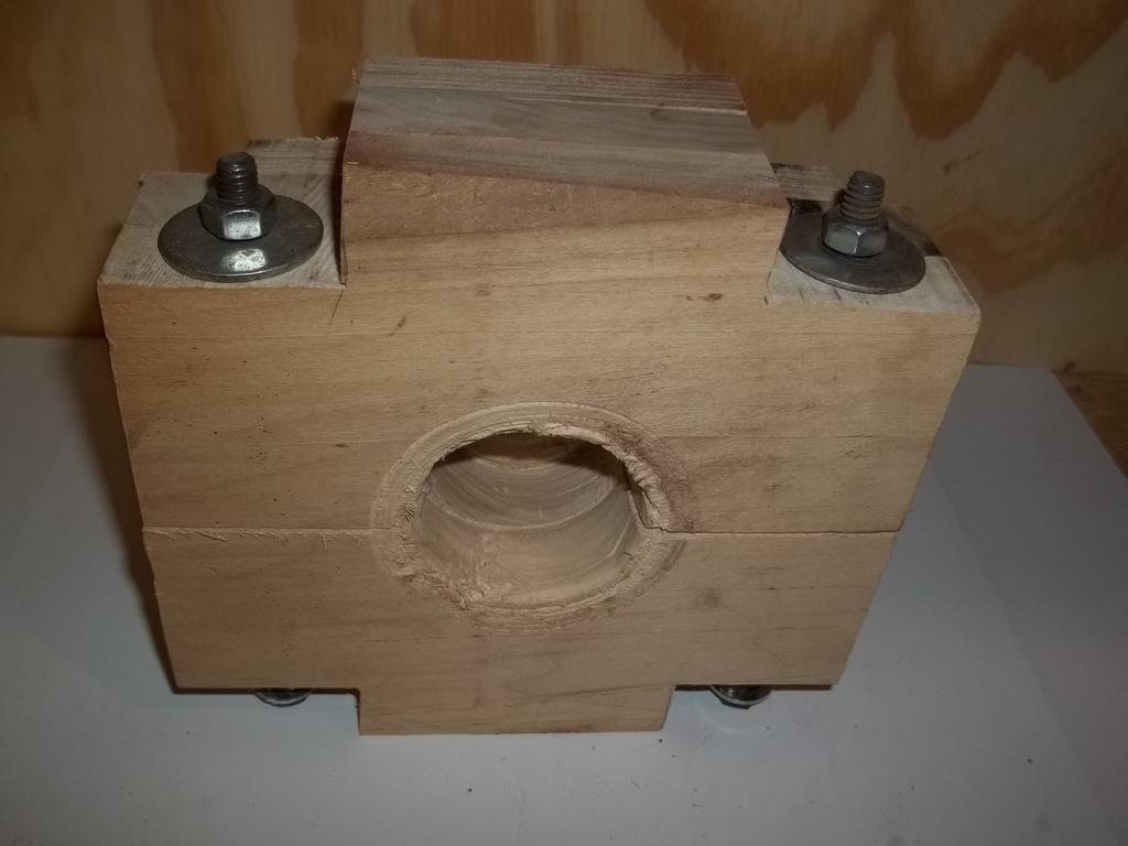

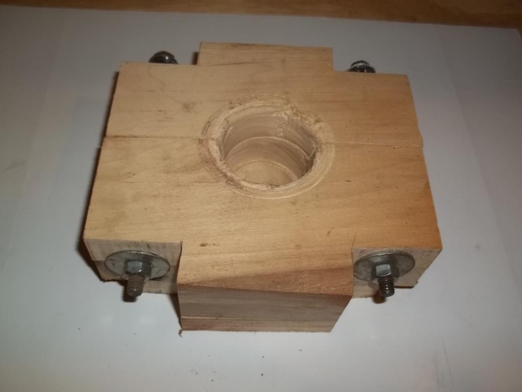

953 nut 69,917 #629 Posted May 17, 2019 I have one that is actually Wheel Horse related! Is that allowed? 1 1 Share this post Link to post Share on other sites

posifour11 723 #631 Posted May 17, 2019 6 minutes ago, 953 nut said: I have one that is actually Wheel Horse related! Is that allowed? Homemade bearing block? 1 1 Share this post Link to post Share on other sites
LengerichKA88 1,885 #632 Posted May 17, 2019 My grandmas 82 and used to complain about people only going 80 in the passing lane on the interstate..... or less than 5 over in town 🤷🏻♂️😂 Shes slowed down now, which keeps her with the flow of traffic most places 1 1 Share this post Link to post Share on other sites
formariz 12,381 #633 Posted May 17, 2019 (edited) 1 hour ago, posifour11 said: I have one that is actually Wheel Horse related! Is that allowed? How big is that hole? One time I thought of something similar to remove a stuck steering wheel from the shaft.Steering wheel was plastic and didn't want to damage it. Idea was to hit it from other side of block. Edited May 17, 2019 by formariz 1 1 Share this post Link to post Share on other sites
953 nut 69,917 #634 Posted May 17, 2019 3 hours ago, formariz said: How big is that hole? The hole is 1 3/4" in diameter and depth. Bottom is closed and no hammering required. Share this post Link to post Share on other sites
953 nut 69,917 #635 Posted May 17, 2019 4 hours ago, LengerichKA88 said: Shes slowed down now, which keeps her with the flow of traffic most places My mother was thirty five years old when she got her driver's license, fastest she would drive was 35 MPH. Fast forward fifty years (pun intended) and she was very comfortable driving 85 MPH. Fortunately she voluntarily surrendered her license on her ninetieth birthday. By the way, she never had an accident and never had a citation for speeding. There was a NY State Trooper that followed her into the driveway once. He had observed her exceeding the speed limit, but he then realized my mother had been his third grade teacher and he just had a nice talk with her, didn't even mention her speed! 1 2 Share this post Link to post Share on other sites
formariz 12,381 #636 Posted May 17, 2019 54 minutes ago, 953 nut said: The hole is 1 3/4" in diameter and depth. Bottom is closed and no hammering required. Silly me I should have seen that. Is it a jig to accomplish something or sort of an implement or accessory? 1 Share this post Link to post Share on other sites
LengerichKA88 1,885 #637 Posted May 17, 2019 An extremely bulky gas cap? 1 Share this post Link to post Share on other sites
953 nut 69,917 #638 Posted May 17, 2019 6 minutes ago, formariz said: a jig to accomplish something Yes it is. The 1 3/4" hole was turned prior to cutting it in half. What part on a is 1 3/4" diameter? Share this post Link to post Share on other sites
formariz 12,381 #639 Posted May 17, 2019 31 minutes ago, 953 nut said: The 1 3/4" hole was turned prior to cutting it in half So its designed to tighten around something to remove it? 1 Share this post Link to post Share on other sites
953 nut 69,917 #640 Posted May 18, 2019 1 hour ago, formariz said: So its designed to tighten around something to remove it? Not Quite. The 1 3/4" gear shift knobs that Glenn Pettet sells are threaded for a 3/8" shift lever which fits everything but my beloved 953/1054 models which are a 1/2-13 thread. I needed something to securely hold the knob while I drilled and tapped it for the larger thread. I turned the 1 3/4" hole so the knob fit snugly then cut it in half with a table saw. The saw kerf allows the bolts to draw it up tightly and can be clamped to the drill press without harming the knob. 6 4 Share this post Link to post Share on other sites

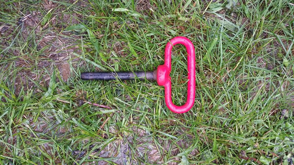

WHX?? 58,308 #643 Posted May 19, 2019 (edited) Ok I been following here and and have no idea on any of the things shown. My turn to do the stumping...whatizit... you guys will never get this one in a million. BTW this was the Dino's idea! Edited May 19, 2019 by WHX22 1 1 Share this post Link to post Share on other sites
LengerichKA88 1,885 #644 Posted May 19, 2019 Can we see the point? Is there a hole for a cotter or other pin? almost looks like a home made hitch pin for wagons/implements 1 Share this post Link to post Share on other sites
formariz 12,381 #645 Posted May 19, 2019 (edited) LOL.Its a hitch pin.I have a few of those. Sold at Loews. Dino is a funny guy. Edited May 19, 2019 by formariz 1 Share this post Link to post Share on other sites

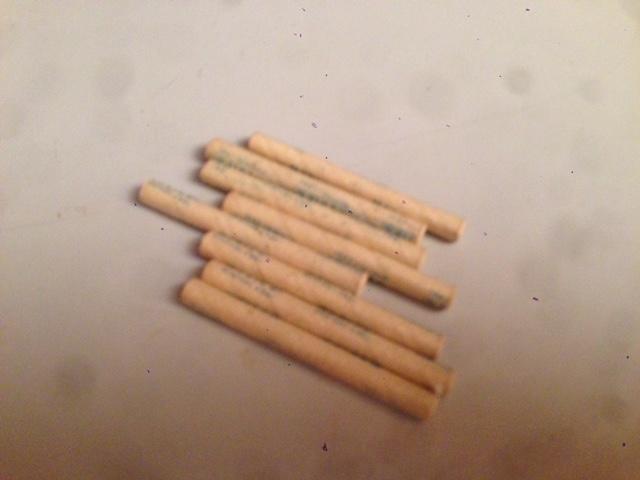

formariz 12,381 #646 Posted May 19, 2019 Anybody? Here is another photo 1 Share this post Link to post Share on other sites
953 nut 69,917 #647 Posted May 19, 2019 Is that a blasting cap fuze? 1 1 Share this post Link to post Share on other sites
LengerichKA88 1,885 #648 Posted May 19, 2019 Ear/nose hair singers? 1 1 Share this post Link to post Share on other sites
formariz 12,381 #649 Posted May 19, 2019 It does have to do with your body. Related to something Ed @Ed Kennell knows a bit about. 1 Share this post Link to post Share on other sites
LengerichKA88 1,885 #650 Posted May 19, 2019 Alum? 1 1 Share this post Link to post Share on other sites
