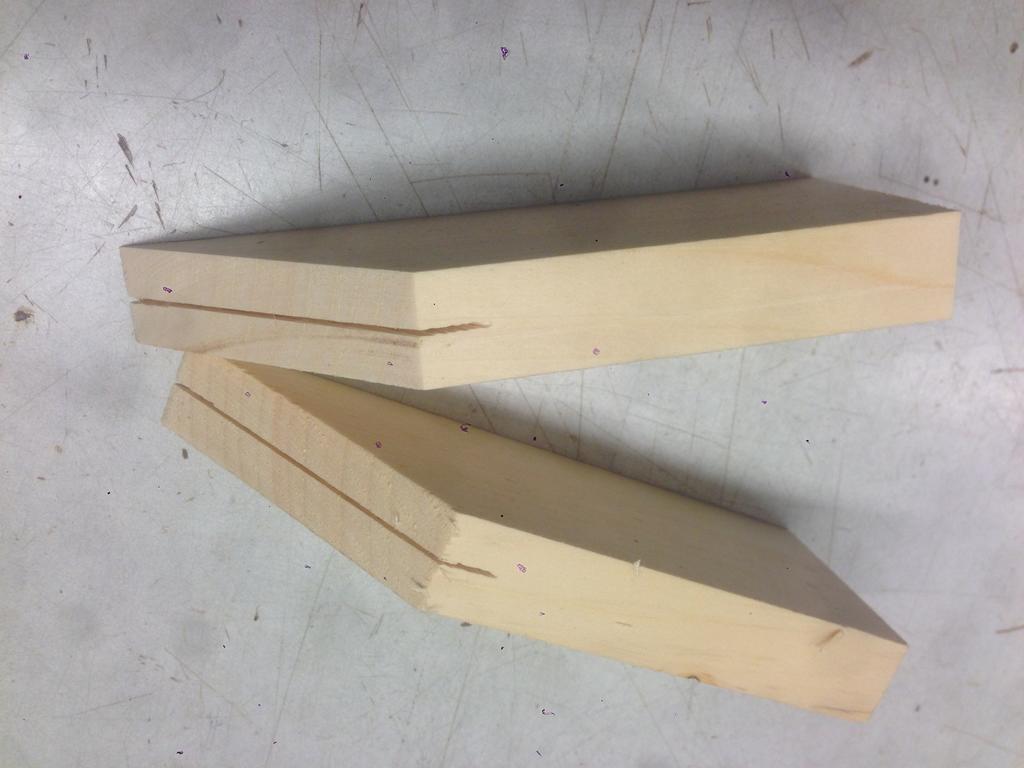

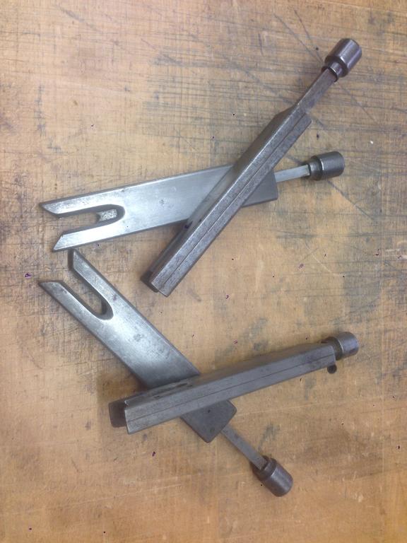

formariz 12,381 #1 Posted April 16, 2019 This may be easy for some of you. Share this post Link to post Share on other sites
WHX?? 57,869 #2 Posted April 16, 2019 Got me by the short ones.... tuning forks??? 1 Share this post Link to post Share on other sites
squonk 47,971 #3 Posted April 16, 2019 Something to make joints with. ( The wooden kind!) Don't get too excited! Share this post Link to post Share on other sites
WHX?? 57,869 #4 Posted April 16, 2019 Guess we know what generation you came from Squonk. Why am I feeling old all of a sudden? 2 Share this post Link to post Share on other sites
elcamino/wheelhorse 9,363 #5 Posted April 16, 2019 Used to make square holes for tendons , for doors, furniture , etc 1 1 Share this post Link to post Share on other sites
stevasaurus 23,808 #6 Posted April 16, 2019 Those are nice Cas... Anybody that has ever watched the New Yankee Workshop on Public TV would know what those are. Share this post Link to post Share on other sites
formariz 12,381 #7 Posted April 16, 2019 1 hour ago, squonk said: Something to make joints with. ( The wooden kind!) Don't get too excited! It does not "make" the joint. Care to elaborate? 40 minutes ago, stevasaurus said: Those are nice Cas... Anybody that has ever watched the New Yankee Workshop on Public TV would know what those are. What are they? Share this post Link to post Share on other sites
squonk 47,971 #8 Posted April 16, 2019 44 minutes ago, stevasaurus said: Those are nice Cas... Anybody that has ever watched the New Yankee Workshop on Public TV would know what those are. If Norm wasn't makin a biscuit , he had the power nailer out! 1 Share this post Link to post Share on other sites
elcamino/wheelhorse 9,363 #9 Posted April 16, 2019 Mortise Chisels ? 1 Share this post Link to post Share on other sites
Ed Kennell 47,068 #10 Posted April 17, 2019 Are the forks for positioning the cutter/punch on a round dowel or the corner of a square piece? 1 Share this post Link to post Share on other sites
Mows4three 833 #11 Posted April 17, 2019 I'd go with mortising chisels but that's too obvious. Hmmm.....It might be a set of first, second, third and fourth gear tuning forks for getting the synchromesh sine wave pattern just right on those green tractors. Cheers! Dave 2 Share this post Link to post Share on other sites
857 horse 2,588 #12 Posted April 17, 2019 you guys are a messss !!!!!!!!!! 2 4 1 Share this post Link to post Share on other sites
Ed Kennell 47,068 #13 Posted April 17, 2019 Howie's Back 3 1 Share this post Link to post Share on other sites
857 horse 2,588 #14 Posted April 17, 2019 We need a new thread......What the Big Show means to me !!!!!!!!!!!!! But where would it go,??? .???? 1 1 1 Share this post Link to post Share on other sites
elcamino/wheelhorse 9,363 #15 Posted April 17, 2019 @857 horse tattoo on @squonk forehead . How are you doing old man ? 2 2 Share this post Link to post Share on other sites
squonk 47,971 #16 Posted April 17, 2019 7 hours ago, elcamino/wheelhorse said: @857 horse tattoo on @squonk forehead . How are you doing old man ? You got your suspenders clinched too tight again there Waldo! 4 Share this post Link to post Share on other sites

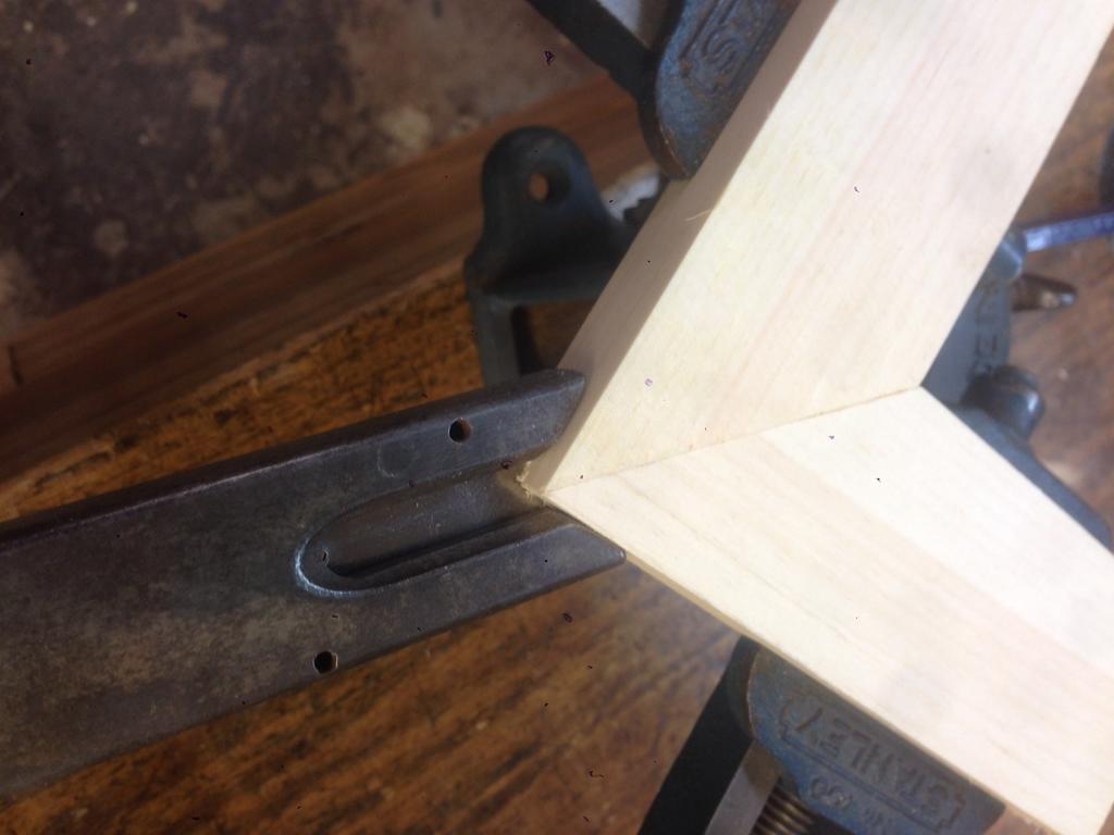

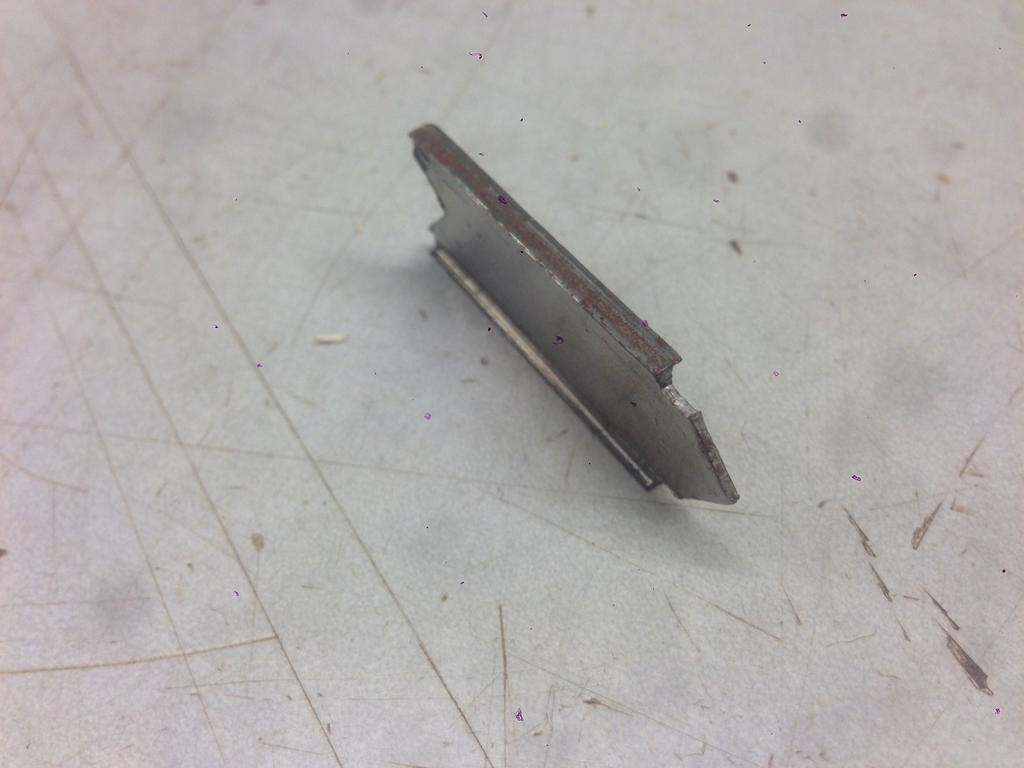

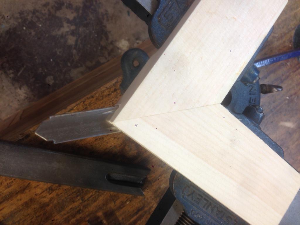

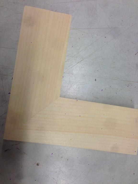

formariz 12,381 #17 Posted April 17, 2019 I knew it would be easy for some of you but I never tough it would be because it was seen on TV. I guess next time we will have to eliminate the TV factor. Although no one has named or described how it works a couple of you seem to have the general idea of it. They are Clamp Nail driving tools. These are designed specifically for miter joints. They drive a special spline (clamp nail) through a proper kerf cut into the mitered pieces which not only aligns faces but also draws pieces together. They will make a perfect miter without any glue or other fastener and joint will not pull apart. For this purpose totally superior to Lamelloes (biscuits), faster, and much cheaper to use. No specialized power tool needed.Not a very common thing today but extremely useful if you have it. Most who use the Clamp Nails use a modified pneumatic palm nailer. I assume that is what @squonk was referring to in his Norm comment. 1 2 Share this post Link to post Share on other sites
