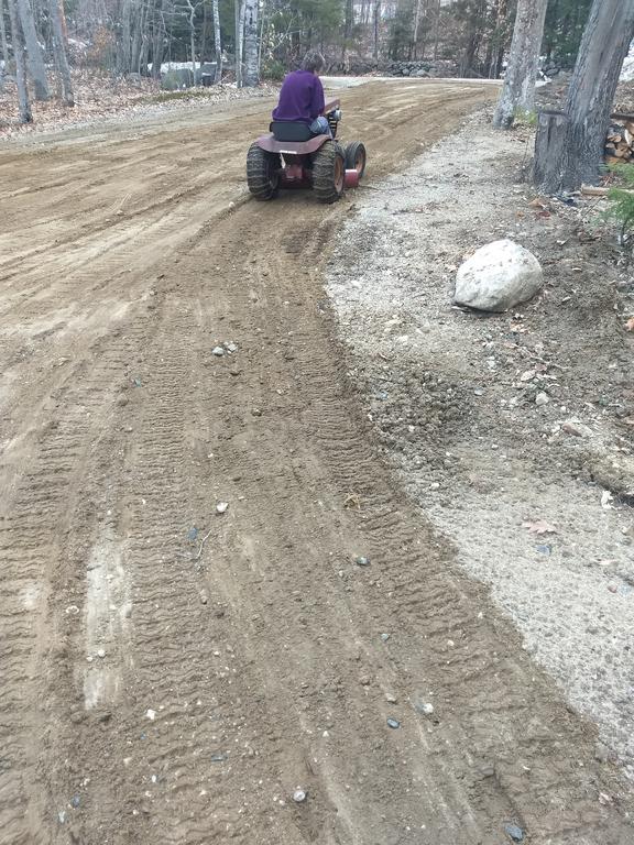

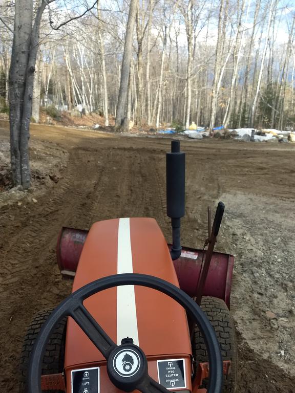

ebinmaine 80,600 #1 Posted April 6, 2019 @buckrancher and @Herder Here's the combination of Brian and Jo's tractor and Adam's generosity in helping me find this grader blade. You folks just would not believe how much fun she's having. Out here driving around on the tractor and smiling and moving dirt. 7 6 Share this post Link to post Share on other sites

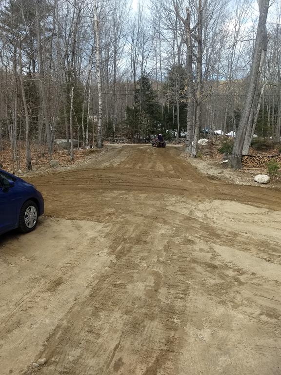

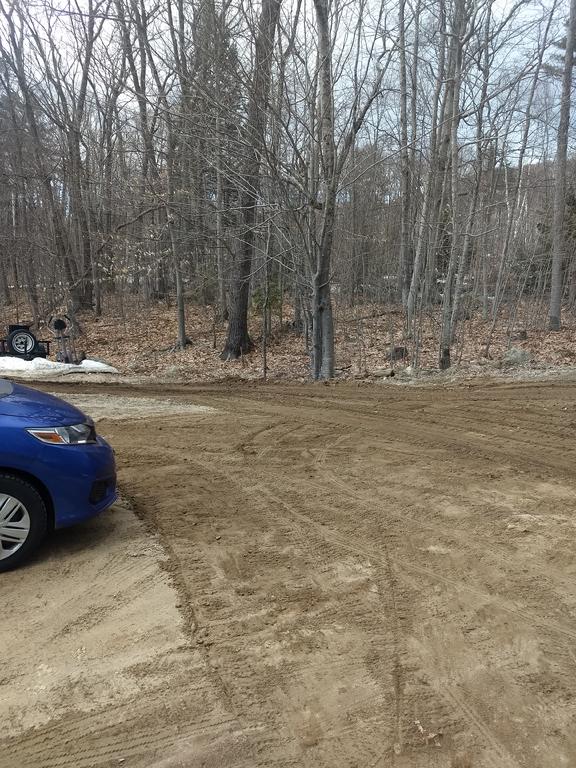

ebinmaine 80,600 #5 Posted April 6, 2019 Here's a couple shots of the driveway after she had covered most of the surface. It's a little tough to make out but there's kind of a mound of dirt just to the lower left of that big rock. She was cutting into that mound and spreading it over into the driveway. So you know.... I'm watching her do this. I took a couple pictures. We're trying to experiment with this and learn and I was throwing some rocks out of the driveway that she was digging up. I couldn't help it. I had to go get Cinnamon. I had to join in the fun. 3 3 1 Share this post Link to post Share on other sites

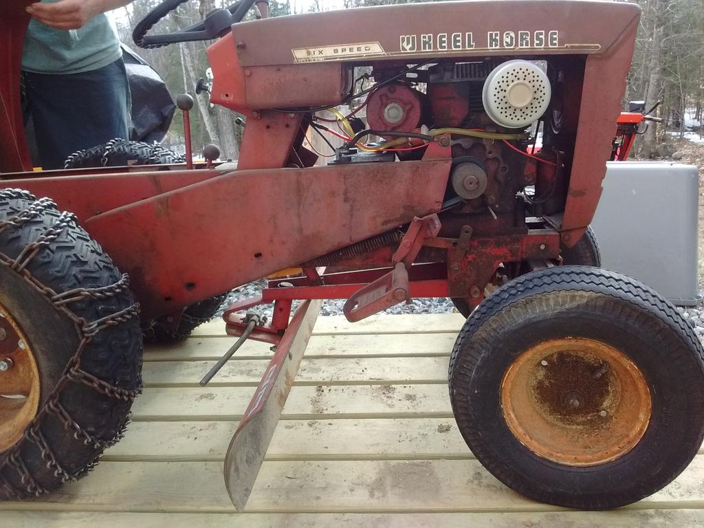

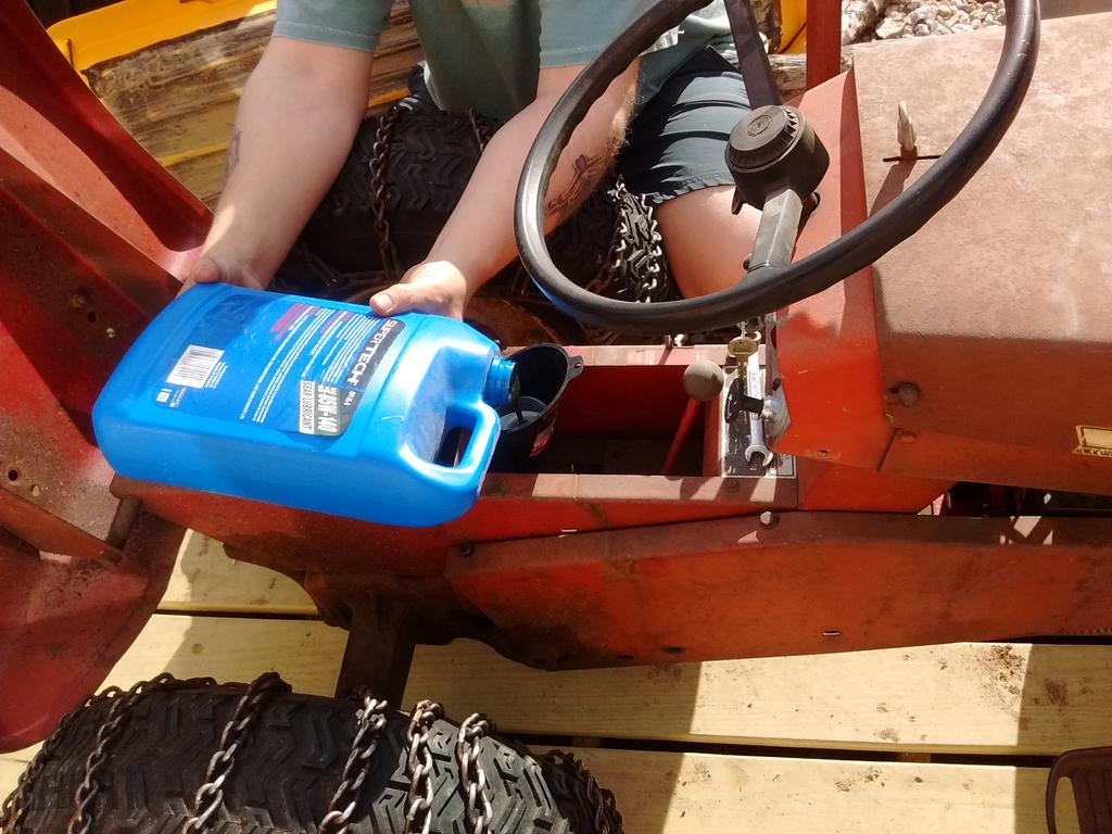

ebinmaine 80,600 #6 Posted April 6, 2019 Trina's 867 has been sitting in the cellar for a few months because we haven't been taking the time to work on it. Today we did a few things to it and got it back up and running. The fuel tank that was on it was quite full of rust and scale so I took the tank off of the 1267 and changed the fuel lines and filter over as well. Also, we had done a 6 speed transmission flush with diesel fuel a few months ago so today we finished draining that out and Trina and I latched onto the front axle of the tractor and lifted it off the ground about 25 or 30 inches to drain out the front of the transmission as well as the back. I then added two quarts of nice fresh gear oil. After all that was said and done we put the mid-mount grader blade on. 6 4 Share this post Link to post Share on other sites

Tractorhead 9,217 #10 Posted April 7, 2019 Hey Eric, Fine work on the Driveway Trina did. Think it was a good idea to refresh the Gear Oil for a longer last. good work at all. 1 Share this post Link to post Share on other sites

ebinmaine 80,600 #12 Posted April 7, 2019 18 minutes ago, pullstart said: Am I totally oblivious to another build, or was this mainly complete as a project, or am I shooting in left field here? Either way, it’s looking good! Nice driveway! This is the one that Brian and his wife brought out to us last fall. He had rebuilt the carb and fuel pump already. A few months ago we did a refresher to it including all new wiring and a general tune up. New oil. Replaced all transmission seals and added later model HD hubs. New fuel filter and lines.. Etc... It had a fair amount of rust in the fuel lines so we parked it til yesterday. Share this post Link to post Share on other sites
