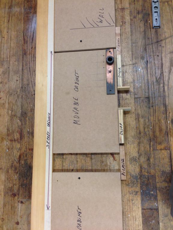

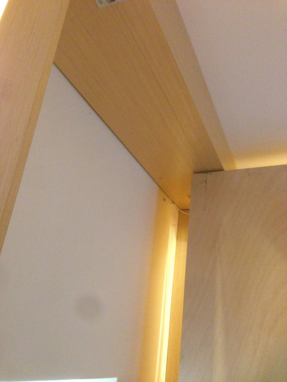

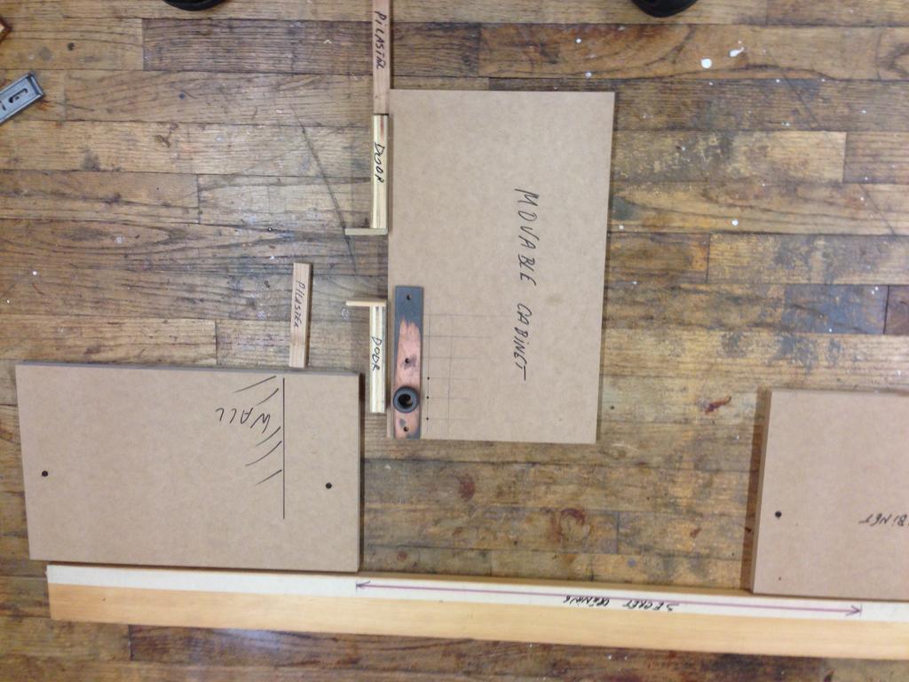

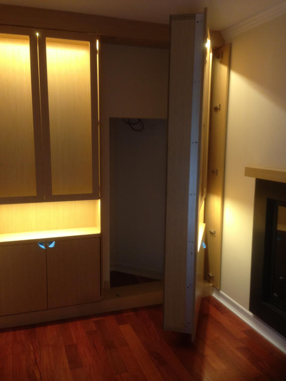

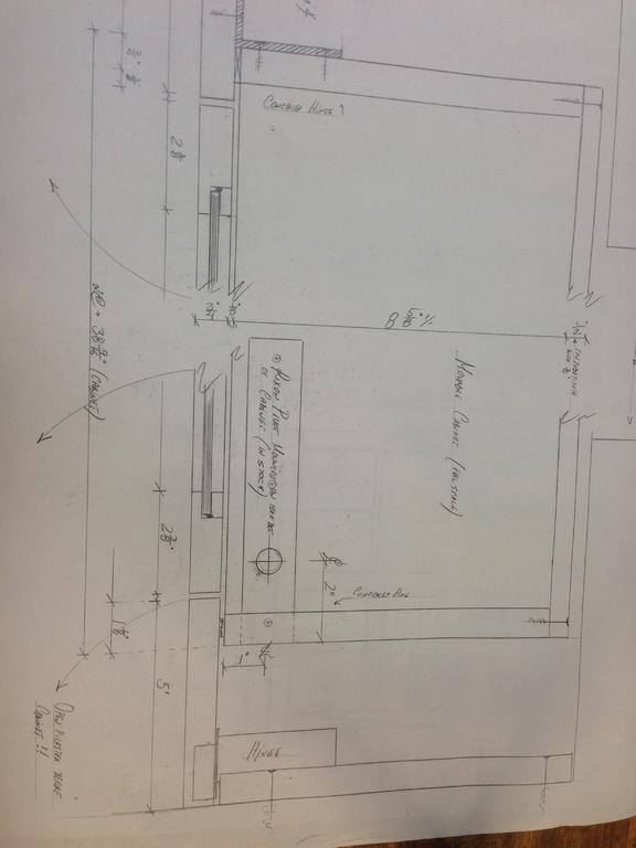

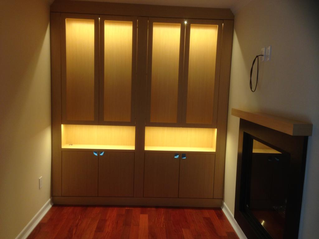

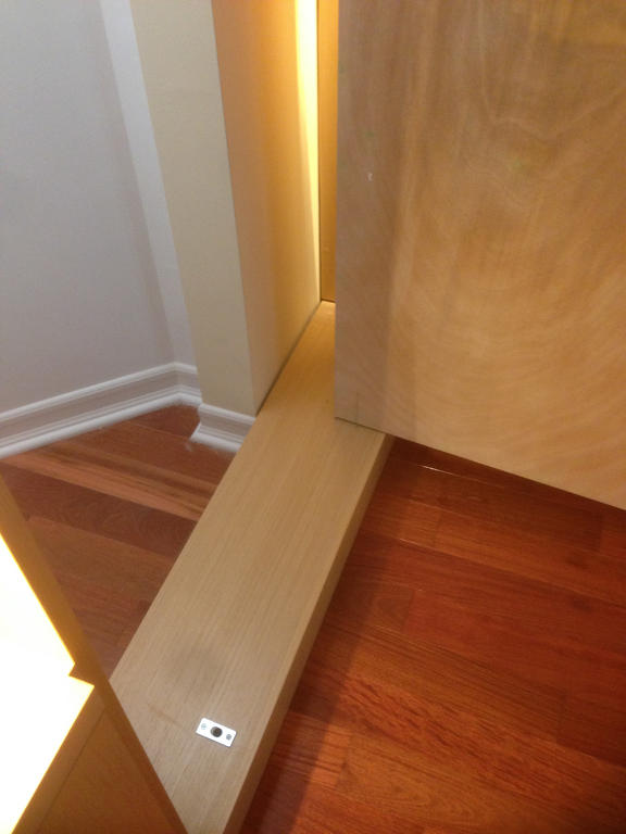

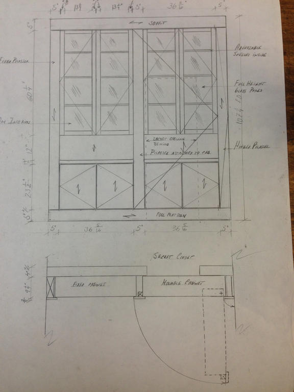

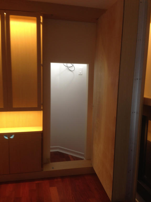

formariz 12,381 #1 Posted April 1, 2019 (edited) Many times I am commissioned for job that is a little more challenging and interesting than usual and this was one of them. So I have this client that has a collection of some very expensive and rare artifacts. He wanted me to make him a modern style display unit for some of them in a small TV room he has in his bedroom. He also had the concern that when he goes on vacation he always removes what he has on display and places them in a large safe. He was concerned about the large safe being very obvious and easily found. So, I came up with the solution of building a large “closet” all the way across end of room where display unit was to go and then the display unit over that wall with a secret movable cabinet that when open will allow him to walk into hidden room where safe will be. He will also have much more space for additional artifacts there. Cabinet is nearly impossible to detect that is it movable (one would have to know it) and it is also alarmed. Cabinet is anigre with glass shelves, weighs nearly 400Lbs, swings on a single pivot and can be opened and closed with one finger. As much fun this one was I am kind of glad it is over.Installation on this one was not easy. Edited April 1, 2019 by formariz 9 7 Share this post Link to post Share on other sites

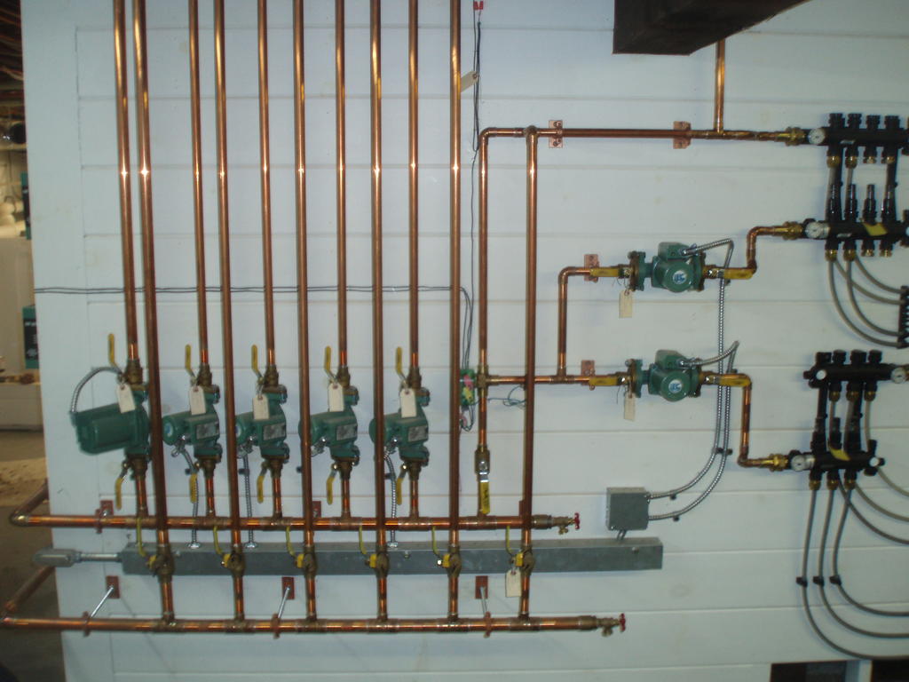

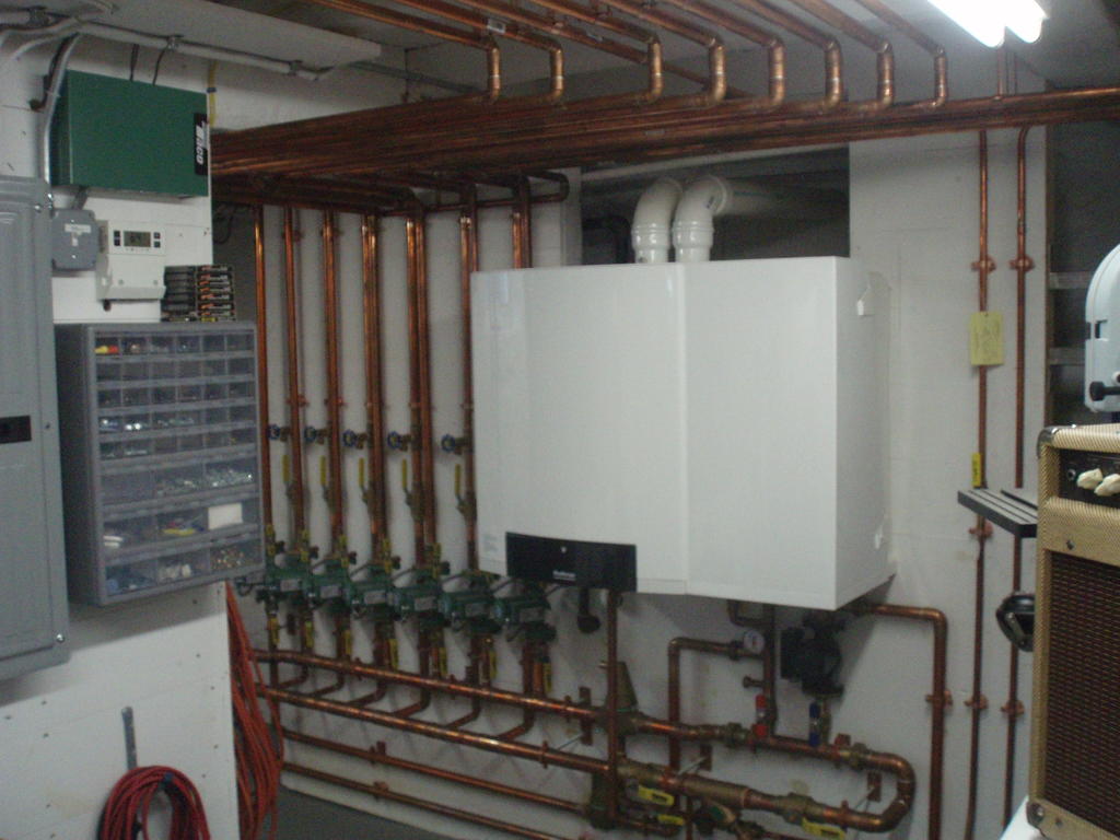

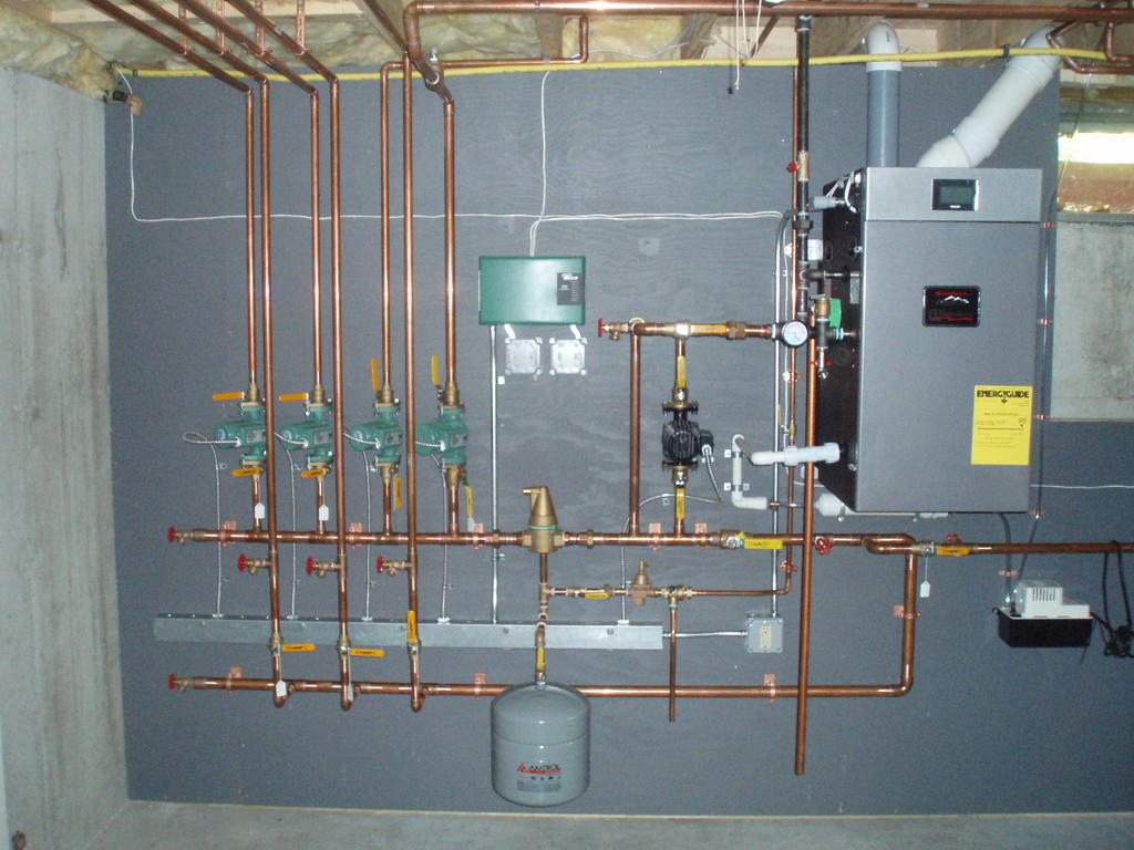

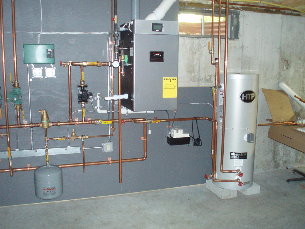

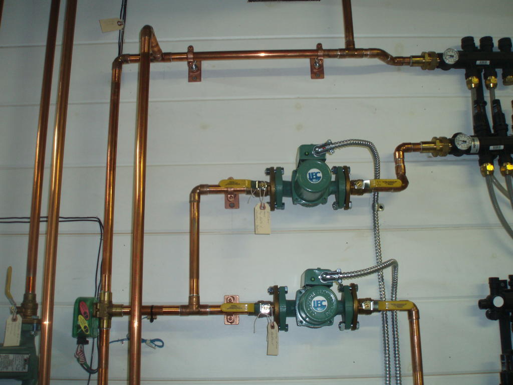

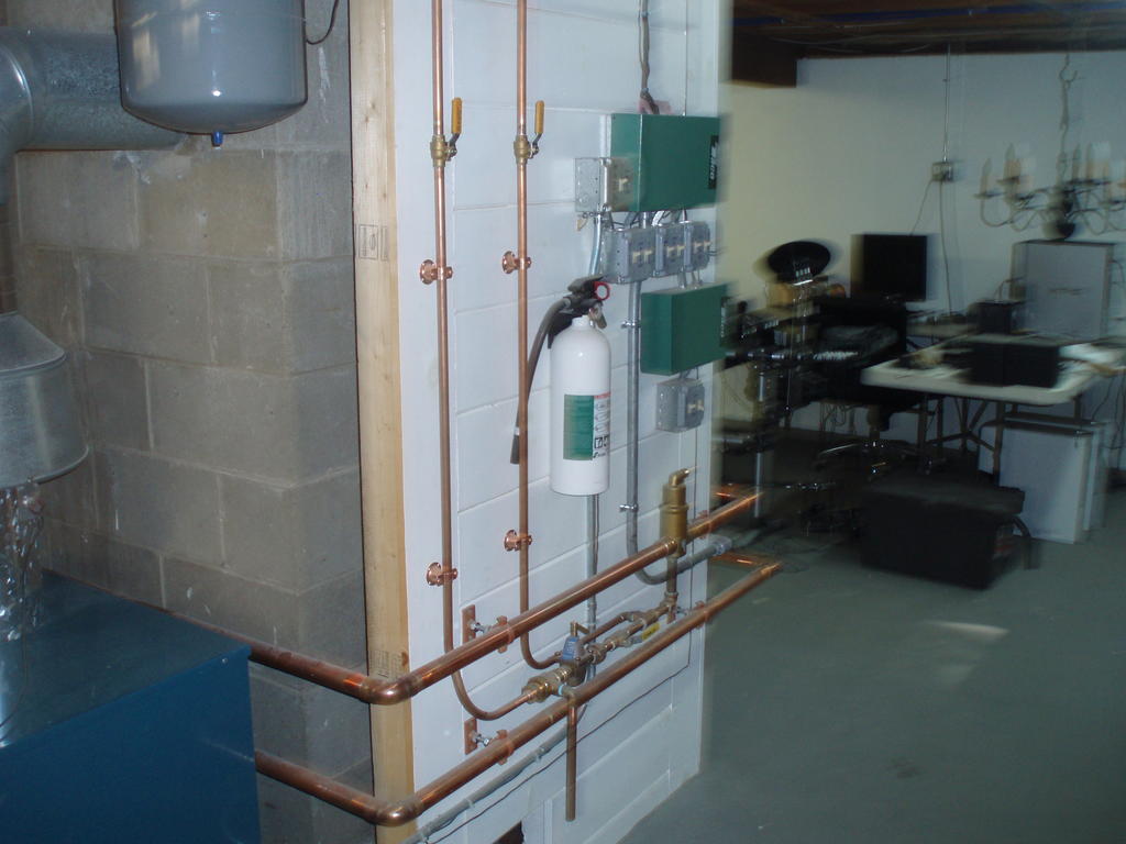

JCM 11,419 #13 Posted April 1, 2019 @formariz After checking out your fine carpentry skills I thought I would post some older pics of 2 Boiler Installs & 1 Boiler Repipe.I have worked alone for most of my career so I can't take on emergency work but these 3 jobs, nowadays like most of them it takes what it takes to bring them to completion. I smiled when I read your comment about no competitive bidding, 90% of my work is when complete, send an invoice and get paid. Naturally when a lot of material is required deposits are needed.It is nice to have that type of customer base, but takes time to build that type of relationship. 1 6 Share this post Link to post Share on other sites

formariz 12,381 #15 Posted April 1, 2019 @JCM That is absolutely beautiful work. One never gets tired of looking at workmanship like that. It is kind of sad that today its all about hurrying up and getting paid, without any pride. Unfortunately also many clients are not educated on how something should look and wouldn't appreciate it anyway. I guess we are fortunate that we have the right type of clients. 2 Share this post Link to post Share on other sites
WHX?? 58,308 #16 Posted April 2, 2019 (edited) Saaaweet JCM! Looks like yer a Taco fan but on the fence about your choice of boilers. Truth be told they're all junk just some better junk than others! You getting perks from Webstone tho? ...you should be Couple of nice primary/secondary loops going on ther. I did notice sweat fittings... why no press? We have quite a few jobs out ther like that but sadly I don't take pics... camera too full of tractors I guess! Tell you what guy we could have a conversation and a half about this work! I am really impressed about the electrical work! Edited April 2, 2019 by WHX22 1 1 Share this post Link to post Share on other sites
JCM 11,419 #17 Posted April 2, 2019 @WHX22 You are right, they are all junk;the boiler in my own house is an old school cast iron Burnham ESC with 80 feet of cast iron baseboard heat, those boilers pictured were customer supplied because they changed from oil to gas because the utility companies said they would give them a free boiler if they converted, yea right, free boiler, now they are tied into a major gas supplier instead of their choice of any oil company. Never got into press on the copper fittings, I still do a lot of sweating, kinda on the downside of my years in the trade , but still need to work, glad you liked the pics. Jim 1 Share this post Link to post Share on other sites
WHX?? 58,308 #18 Posted April 2, 2019 Actually quite the opposite in this neck of the woods Jim..utilities won't give you the time of day to switch from oil to gas no less than some pos modcon boiler we are suposed to support? The boiler alone is a pretty good chunk of coin right ther. I would have a real hard time in your neck of the woods where oil is still the queen. 1 Share this post Link to post Share on other sites
