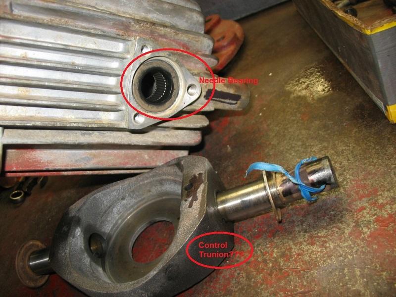

daveoman1966 3,884 #2 Posted February 23, 2019 Is this the 'Control Trunion Shaft bearing" you refer to? If so, there are two of the same size. 1 Share this post Link to post Share on other sites
gt14rider 1,283 #3 Posted February 23, 2019 Yes , that's the one, Torrington b1210 , is that the right bearing? Also what bearing do you use for the pump shaft Share this post Link to post Share on other sites
pfrederi 21,274 #4 Posted February 23, 2019 (edited) You will not get it from Toro. Are you sure you read teh bearing # correctly could it be 304. Any bearing place should be able to help you out. 304K would be the open version. 52mm x 20mm x 15mm or you could contact LJ Fluid power. If it is 204 just take it to a bearing place they will be able to measure it up. 204 would be 47mm x 20mm x14mm Edited February 23, 2019 by pfrederi 2 Share this post Link to post Share on other sites

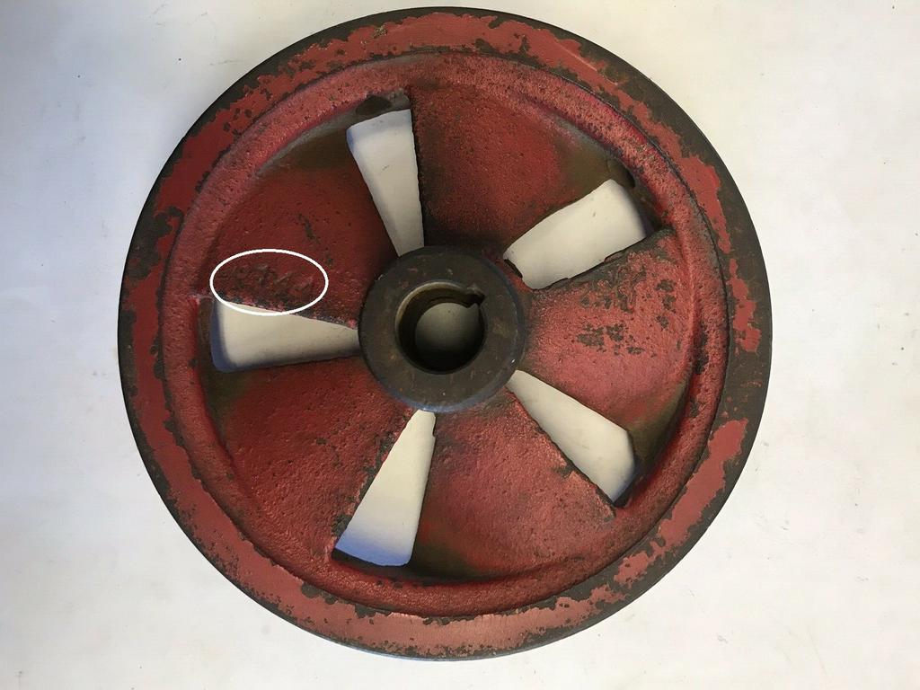

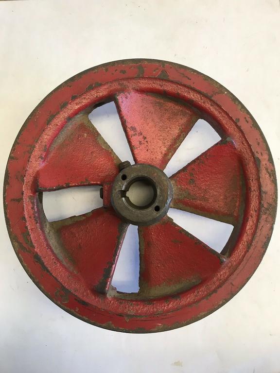

ztnoo 2,302 #21 Posted February 25, 2019 A 8144 pulley is keyed. @oldredrider it should have the casting number on one of the pulley blades. * @gt14rider, take note: Share this post Link to post Share on other sites

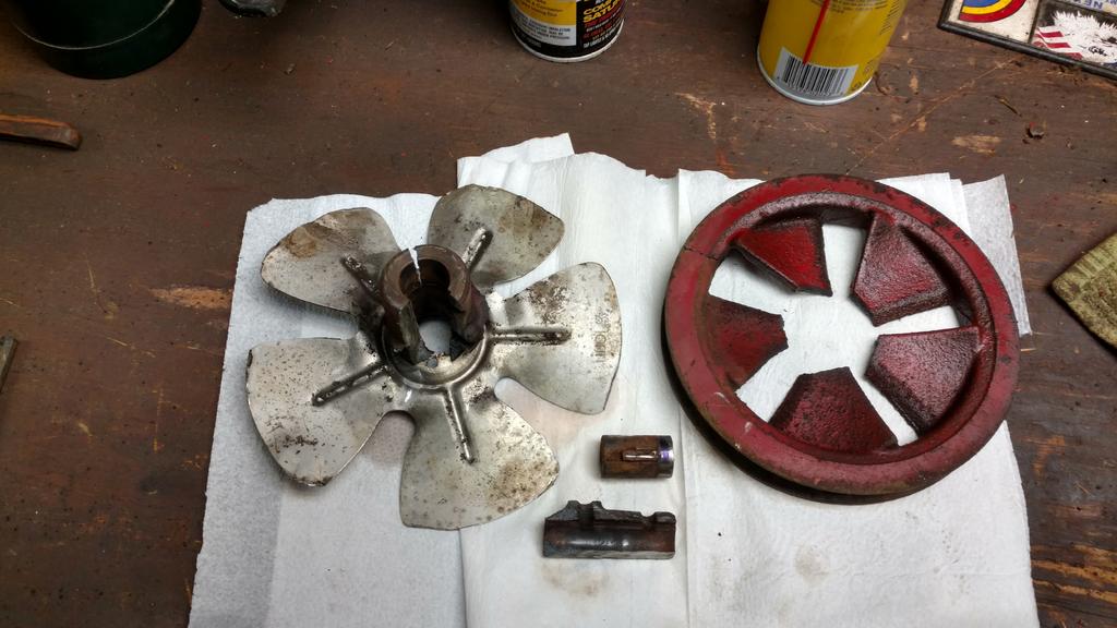

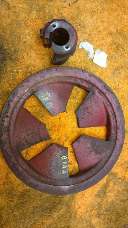

gt14rider 1,283 #22 Posted February 25, 2019 It is a 8144 back of pulley has two holes for the fan Share this post Link to post Share on other sites
ztnoo 2,302 #23 Posted February 25, 2019 @gt14rider, Sounds like we just need to hear from @oldredrider about verifying the part number. You might send him a PM, just in case he doesn't get back to the thread quickly. Not sure, but I think this was a GT 14 specific pulley. Share this post Link to post Share on other sites
gt14rider 1,283 #24 Posted February 25, 2019 I have talked to oldredrider, and pulley will not work on a gt14 Share this post Link to post Share on other sites
oldredrider 2,554 #25 Posted February 26, 2019 I have the one you need. #8144. Check you messages Share this post Link to post Share on other sites
