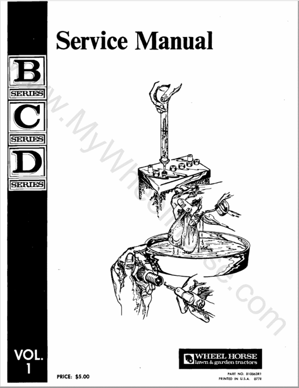

gwest_ca-(File Mod) 11,846 #11 Posted February 15, 2019 8 hours ago, HappyHillbilly said: Multiple replies.... Thanks for the welcome! I couldn't tell ya for sure if there was such a place here - I've been here for 25yrs and don't recall it. I'll ask some of the locals. Thank you for that info! That helps a lot. As for the tractor - I'm glad to hear it's a good one. My dad had it running before he passed away about 8yrs ago and it's been sitting since. Thanks for that link! I'll place my order for that harness & a switch tomorrow. Thank you! I missed a few of those last night after you directed me here. By the way - I've got a 1978 Service Manual for B, C & D series in PDF that my cousin, who's a small engine mechanic, sent me. I looked in the Manuals section and didn't see one there, If you'd like to have it to post it I'll send it to ya. Here's a screenshot of the first page: We do have that manual and it is likely the first tractor service manual they ever published. Turns out it covers most years and models is some respects because the same design and parts were used. Here is one on the 103990 ignition switch. Click on the picture Here is a link to one of many online Toro dealers for your model. The parts that are still available from any Toro dealer are priced. https://www.partstree.com/parts/toro/mowers-lawn-garden-tractor/61-16ks01-c-160-toro-c-160-automatic-tractor-1976/ Garry 2 Share this post Link to post Share on other sites
