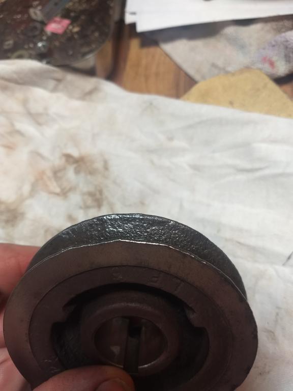

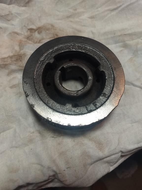

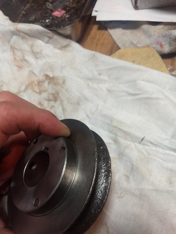

ebinmaine 80,770 #15 Posted February 9, 2019 1 hour ago, Whnewone said: @ebinmaine let me rephrase that do you have a pic of your pulley for us it might help 2 Share this post Link to post Share on other sites

Sarge 3,473 #17 Posted February 10, 2019 Uh, I'd replace that one for sure - not much left of it and the surface is gone too deep with pitting. It would be a belt-eating animal at best. Sarge 3 Share this post Link to post Share on other sites
pfrederi 21,184 #18 Posted February 10, 2019 I am with Sarge I wouldn't waste my time on that i didn't realize it was that bad. Its not like it is rare. Belts get to be expensive. 1 Share this post Link to post Share on other sites
ztnoo 2,302 #19 Posted February 10, 2019 27 minutes ago, pfrederi said: I am with Sarge I wouldn't waste my time on that i didn't realize it was that bad. Yep. In Hoosier speak, I'd say "its a goner" or "seen better days". Much more heavily pitted than I imagined....... Probably would make decent paperweight. Share this post Link to post Share on other sites
Tractorhead 9,217 #20 Posted February 10, 2019 Think i would try to rework it on a lathe. it seems to me there is enough Material in spare to being carefully reworked. hope, the pictures don't decieve me that much. Share this post Link to post Share on other sites
ebinmaine 80,770 #21 Posted February 11, 2019 7 hours ago, ztnoo said: Probably would make decent paperweight That's a plus at least. 1 Share this post Link to post Share on other sites
953 nut 69,560 #22 Posted February 11, 2019 I would replace it too. By time you filled the deep pits with JB Weld and sanded it smooth you would have more time in it than it is worth. Share this post Link to post Share on other sites

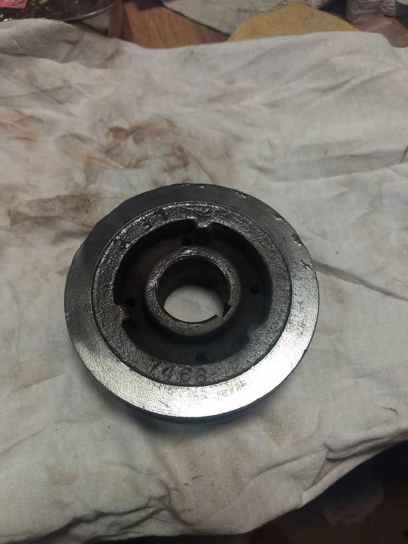

ztnoo 2,302 #24 Posted February 11, 2019 Eric, Is that C-100 an 8 speed? The reason I ask, is because there were 4 speed C-100s, but I haven't been able to identity the engine pulley for that set up. May be different, maybe not. Don't know. Does the pulley that came off the tractor say 7466? That's what I get viewing your pic. Share this post Link to post Share on other sites
ebinmaine 80,770 #25 Posted February 11, 2019 1 minute ago, ztnoo said: Eric, Is that C-100 an 8 speed? The reason I ask, is because there were 4 speed C-100s, but I haven't been able to identity the engine pulley for that set up. May be different, maybe not. Don't know. Does the pulley that came off the tractor say 7466? That's what I get viewing your pic. It is a 7466 That's the number Lincoln gave me as well. That C100 is currently a 4 but was an 8. Share this post Link to post Share on other sites
