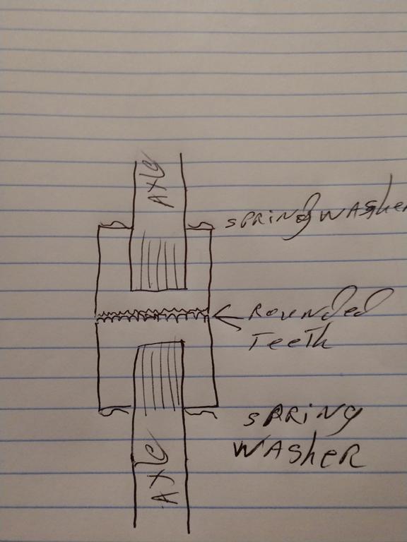

Cetan08 311 #26 Posted December 27, 2018 Very ruff drawing here. These units would slip on the ends of each axle with interlocking rounded teeth . Behind each of these would be a spring washer that would allow the teeth to slip when turning. 1 Share this post Link to post Share on other sites

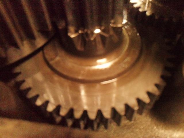

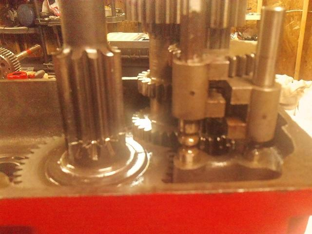

953 nut 70,661 #27 Posted December 27, 2018 1 hour ago, stevasaurus said: My question would be if you had a 2 piece mushroom gear or the 1 piece. If you are talking about what you usually call the 44-11 gear ( manual calls it Gear-Brake Shaft) it is a one piece unit 1 hour ago, stevasaurus said: in those pictures you could see where the chipping resulted. What chipping do you see? Share this post Link to post Share on other sites

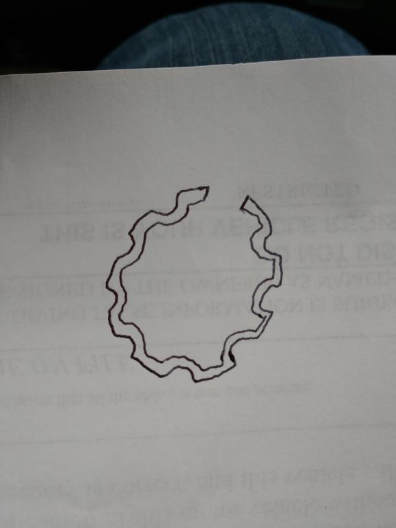

Cetan08 311 #30 Posted December 28, 2018 How about a spring shaped like this rather than a round one. The pinion gears set in the dips in the spring. The dips are set to match all eight pinions. I agree Skipper. Making it like an auto locker would be cost prohibited. I was thinking more in the lines of creating some sort of friction plates between the ends of the axles. One of those things where I can see the picture in my mind but just cannot put it clearly into words. Share this post Link to post Share on other sites
stevasaurus 23,892 #31 Posted December 28, 2018 While all this fabrication is interesting, this is not what this thread is all about. I don't think we are trying to build or fabricate a Limited Slip Deferential. It was stated that you could take the cylindrical spring from a 10 pinion differential...put it into an 8 pinion differential and make that a Limited Slip. That's it. Somebody that is opening an 8 pinion differential needs to put the spring in there...put the trans back together...put the nose of the horse against a tree (with the horse on snow or ice)...put it in gear and take a video of both wheels going in the same direction. Boom-Sha-Ka-La-Ka. When that doesn't work, we can start rebuilding the differential. LOL Richard, here are the pictures of the chipped mushroom gear / 11-44 toothed gear / or what ever else you want to call it. I'm thinking you don't have this problem with the 2 piece 11/44 gear. 1 Share this post Link to post Share on other sites

953 nut 70,661 #34 Posted December 28, 2018 55 minutes ago, stevasaurus said: here are the pictures of the chipped mushroom gear / 11-44 toothed gear / or what ever else you want to call it. I'm thinking you don't have this problem with the 2 piece 11/44 gear. Steve, thanks for posting this picture. Looking at the picture it is obvious to me that the differential was put in upside down. The long end of the differential should be down which provides ample room between the Bull gear and the mushroom gear. Regardless of what differential you are installing the long end will need to face the 44 tooth gear. I too have the one piece "Mushroom gear" and here are a couple of pictures to compare. The top one is the one you sent where the bull gear had been cut to clear the 11 tooth gear. The second one is my tenpinion with the long side of the differential down toward the 44 tooth gear. As you can see the teeth in my differential line up where the teeth of the 953 bull gear had been riding. The picture below is from your thread on the 5060 ten pinion 6 Speed and the differential is riding the same way as mine is. This reinforces my suspicion that the whole problem that others have encountered boils down to the differential being installed backward resulting in gears clashing. Take a look and see what you think. Share this post Link to post Share on other sites
