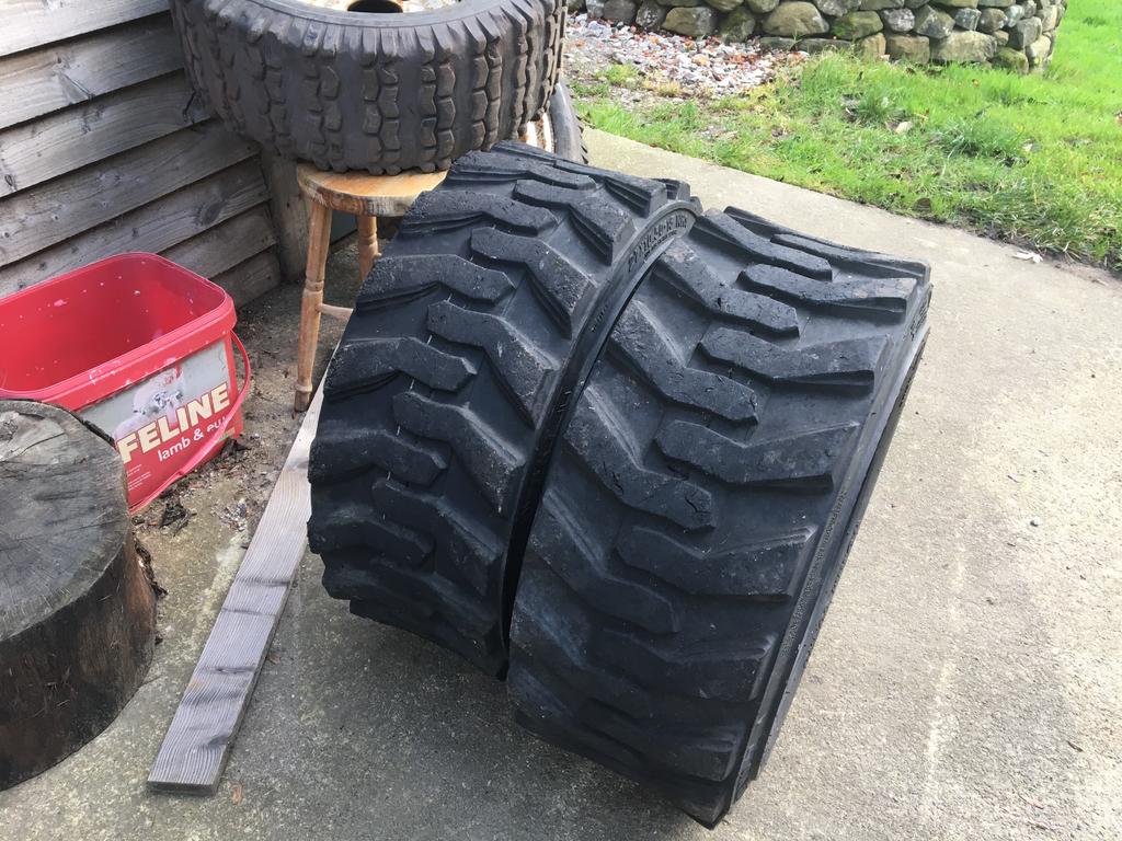

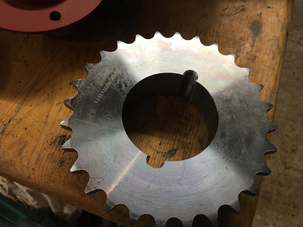

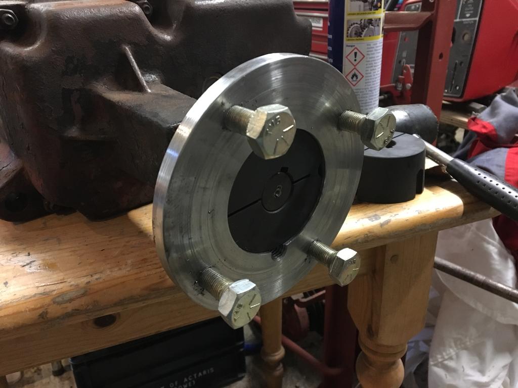

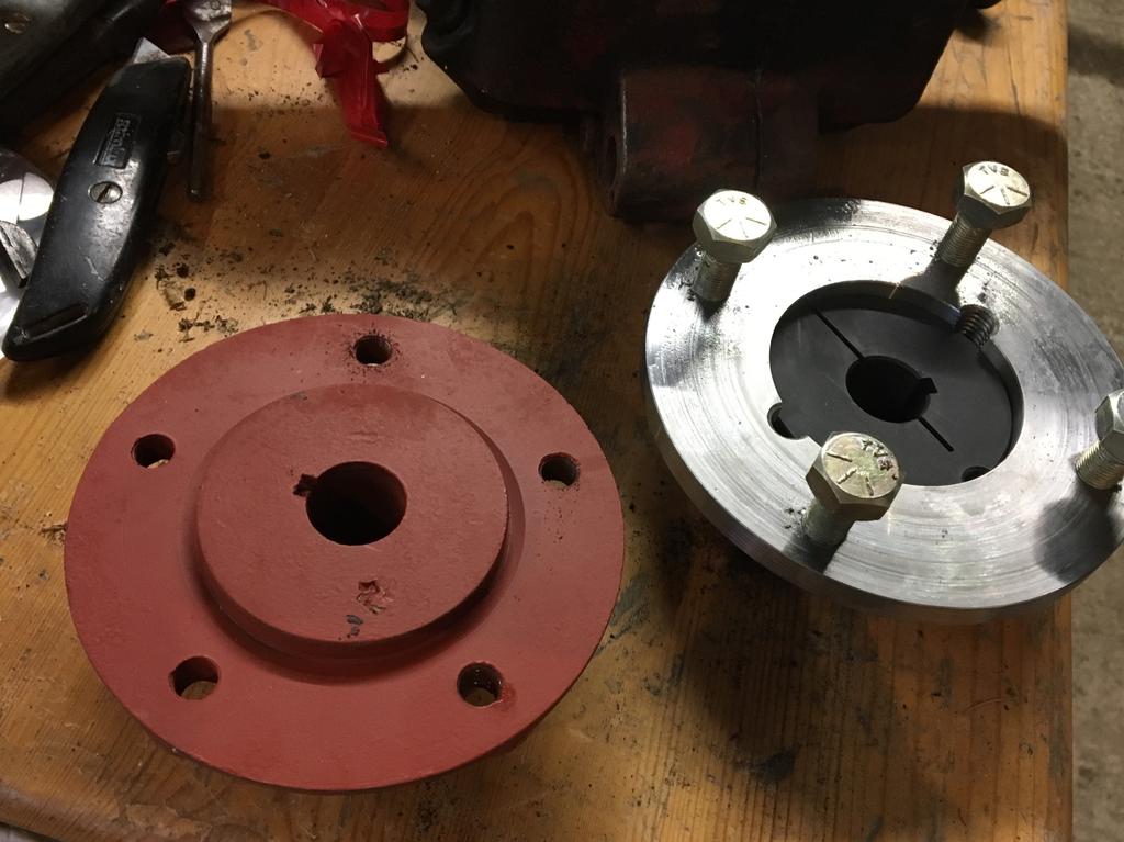

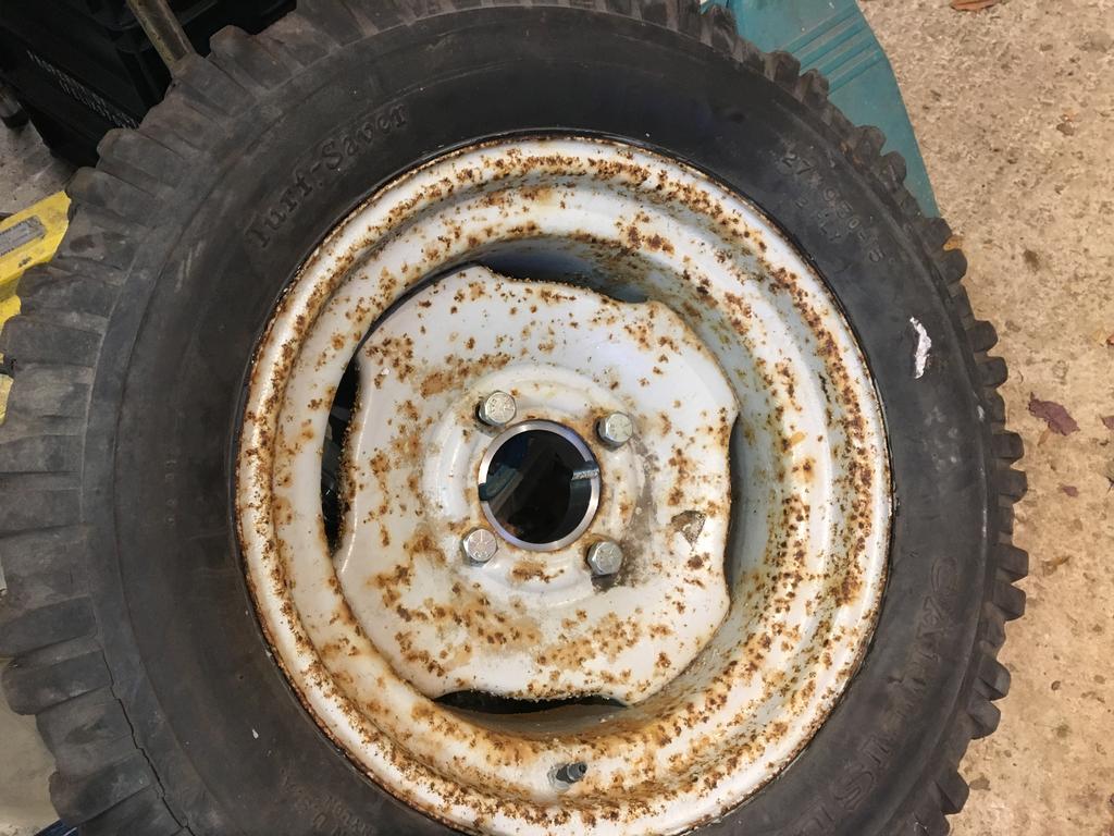

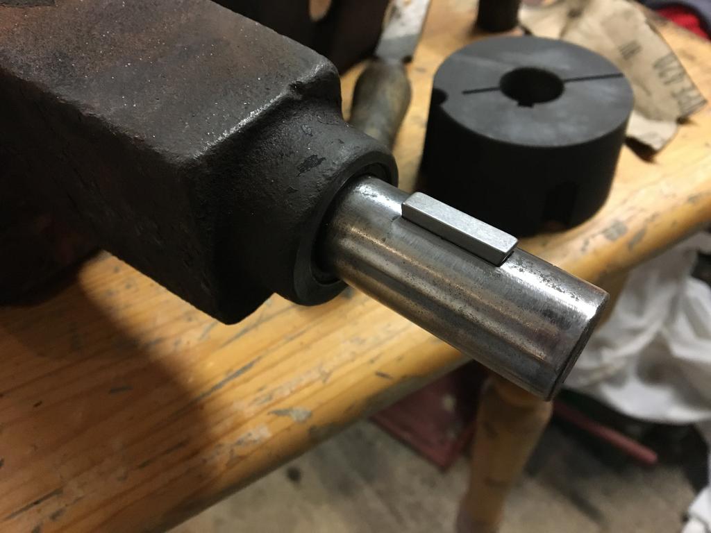

meadowfield 3,191 #1 Posted November 18, 2018 (edited) Title says it all, building up another horse - but trying to make it a little special... so bought these bad boys! 27x10.50-15 BKT skid power HD - hoping I can squeeze them onto a set of GT14 wheels. so I set about making an adapter from 5 stud to 4 stud, but the pcd is close and the holes clash- so it's a little tricky. so had the bright idea of making making my own hubs. Cue big taperlock sprocket! i think it was a lot easier than making the adapters and those taperlock bushes are going nowhere! Edited November 18, 2018 by meadowfield 4 12 1 Share this post Link to post Share on other sites

KC9KAS 4,746 #3 Posted November 18, 2018 @meadowfield. Looks good. You have your own lathe don't you? Always amazed me what a good machinist can do with their tools! Share this post Link to post Share on other sites
ronhatch 410 #4 Posted November 18, 2018 Using taperlocks is a great idea! How about putting the bolts in from the back side and buying lug nuts? It makes installing the wheels a lot easier. How are you going to level out the tractor? I made custom spindles when I fitted 14" rims on my 867 because I like the looks of a tractor that is a touch high in the front. Share this post Link to post Share on other sites
ClassicTractorProfessor 5,455 #5 Posted November 18, 2018 1 hour ago, ronhatch said: How about putting the bolts in from the back side and buying lug nuts? My thoughts too, been wanting to do the same conversion on my C125, and it's got stock wheels with loaded 23x10.50-12s on it...they are a bear to line up the holes and put the bolts in, I can only imagine how it would be putting those big skid steer tires on. Can't wait to see them on the tractor, and great job on machining the new hubs Share this post Link to post Share on other sites

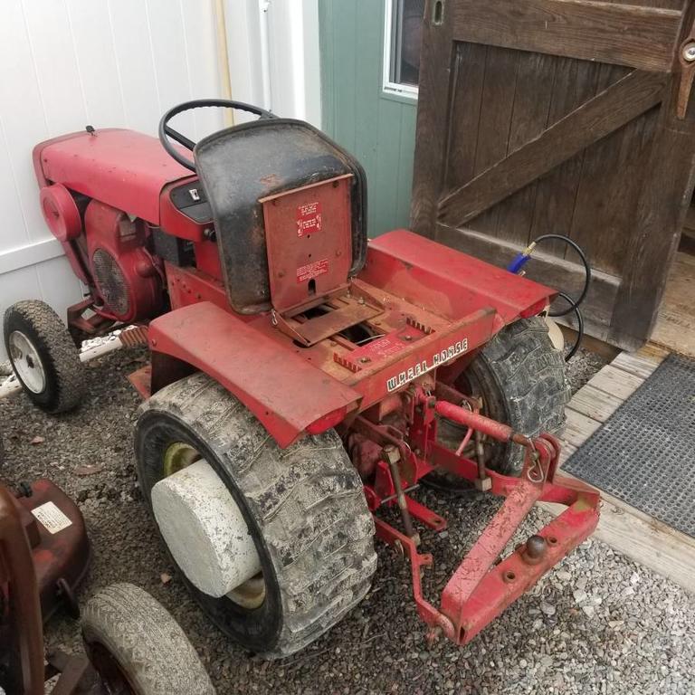

Mows4three 833 #6 Posted November 18, 2018 (edited) 2 hours ago, meadowfield said: 7x10.50-15 BKT skid power HD - hoping I can squeeze them onto a set of GT14 wheels. Hello Meadowfield: Funny, but I was just looking at an online listing where someone here in the States added a similar set of tires to their GT14. I am interested in talking to the guy that has this WH for sale but I don't know a thing about GT14 tractors. Could you kindly give me a few bullet points on the good and bad points of these tractors? From what I see in the photos posted online, this tractor has a category 0 three point hitch. Does a GT14 have down pressure on the three point hitch or is it only the weight of the ground engaging implement that provides the digging pressure? Thanks and good luck on your wheel and tire fitting project! Cheers! Dave Edited November 18, 2018 by Mows4three 1 Share this post Link to post Share on other sites
Pullstart 71,482 #7 Posted November 19, 2018 1 hour ago, Mows4three said: Hello Meadowfield: Funny, but I was just looking at an online listing where someone here in the States added a similar set of tires to their GT14. I am interested in talking to the guy that has this WH for sale but I don't know a thing about GT14 tractors. Could you kindly give me a few bullet points on the good and bad points of these tractors? From what I see in the photos posted online, this tractor has a category 0 three point hitch. Does a GT14 have down pressure on the three point hitch or is it only the weight of the ground engaging implement that provides the digging pressure? Thanks and good luck on your wheel and tire fitting project! Cheers! Dave @19richie66, @Aldon, @953 nut ? 1 Share this post Link to post Share on other sites
Pullstart 71,482 #8 Posted November 19, 2018 On 11/18/2018 at 3:55 PM, meadowfield said: Title says it all, building up another horse - but trying to make it a little special... so bought these bad boys! In the background, are those cut turf savers? How do they fare? Share this post Link to post Share on other sites
953 nut 70,072 #9 Posted November 19, 2018 1 hour ago, Mows4three said: I am interested in talking to the guy that has this WH for sale but I don't know a thing about GT14 tractors. Could you kindly give me a few bullet points on the good and bad points of these tractors? The GT-14 is a beast! The Sundstrand on the GT-14 is a fantastic transmission IF it has been maintained and not abused. The three point has great down pressure and the tractor with extra rear wheel weights is unstoppable. To test the transmission you will want to drive it around until it is warmed up and then chain it to a tree and see if the tires will dig in well. Do this in forward and reverse. 1 Share this post Link to post Share on other sites
Mows4three 833 #10 Posted November 19, 2018 35 minutes ago, 953 nut said: The GT-14 is a beast! The Sundstrand on the GT-14 is a fantastic transmission IF it has been maintained and not abused. The three point has great down pressure and the tractor with extra rear wheel weights is unstoppable. To test the transmission you will want to drive it around until it is warmed up and then chain it to a tree and see if the tires will dig in well. Do this in forward and reverse. Thanks. Appreciate the info on how to test out the transmission... If I get it, I'll let you know. Cheers, Dave 1 1 Share this post Link to post Share on other sites
meadowfield 3,191 #11 Posted November 22, 2018 On 11/18/2018 at 9:39 PM, KC9KAS said: @meadowfield. Looks good. You have your own lathe don't you? Always amazed me what a good machinist can do with their tools! thanks, yeah - have to have a lathe with projects like these 1 Share this post Link to post Share on other sites
meadowfield 3,191 #12 Posted November 22, 2018 On 11/18/2018 at 11:16 PM, Professor1990 said: My thoughts too, been wanting to do the same conversion on my C125, and it's got stock wheels with loaded 23x10.50-12s on it...they are a bear to line up the holes and put the bolts in, I can only imagine how it would be putting those big skid steer tires on. Can't wait to see them on the tractor, and great job on machining the new hubs I'm half tempted - definitely makes it easier to fit the wheels Share this post Link to post Share on other sites
meadowfield 3,191 #13 Posted November 22, 2018 On 11/19/2018 at 12:52 AM, pullstart said: In the background, are those cut turf savers? How do they fare? they are, no better really - I didn't do them they came that way 1 Share this post Link to post Share on other sites

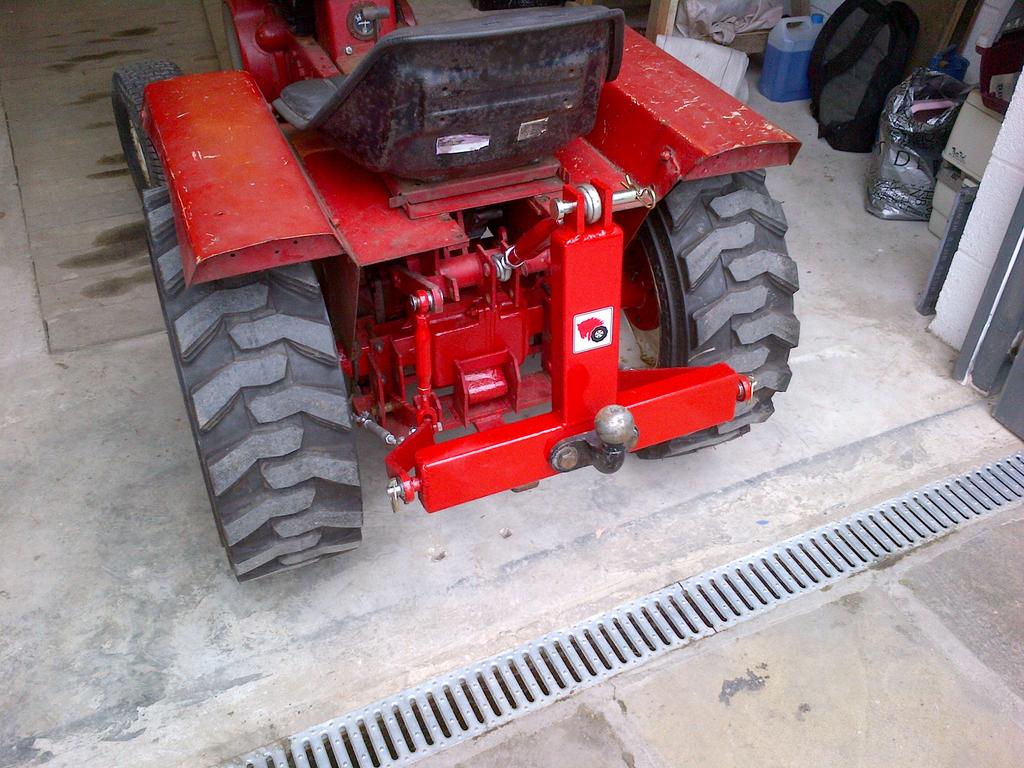

meadowfield 3,191 #14 Posted November 22, 2018 On 11/19/2018 at 12:24 AM, pullstart said: @19richie66, @Aldon, @953 nut ? I think the guys have covered good and bad and how to test the trans. There is a thread on one of my GT14's on here, and that has the same BKT tyres, but in 8.50 width. 1 2 Share this post Link to post Share on other sites
ebinmaine 81,048 #15 Posted November 22, 2018 1 hour ago, meadowfield said: I'm half tempted - definitely makes it easier to fit the wheels Possibly the best modification to a Horse. The ones we've worked on and every one we ever build from now on will get rear wheel studs. 3 Share this post Link to post Share on other sites
chucksterock 15 #16 Posted November 22, 2018 Where are you getting the lug nuts from? Share this post Link to post Share on other sites
ebinmaine 81,048 #17 Posted November 22, 2018 20 minutes ago, chucksterock said: Where are you getting the lug nuts from? Pm sent Share this post Link to post Share on other sites
ronhatch 410 #18 Posted November 22, 2018 I use chrome 7/16" lugnuts from Farm and Fleet 2 Share this post Link to post Share on other sites

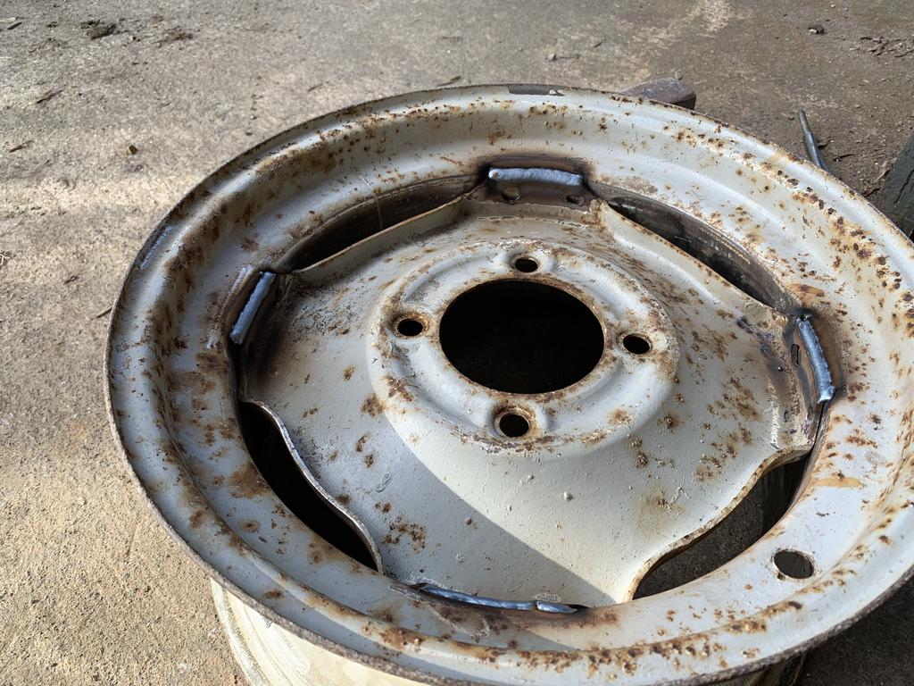

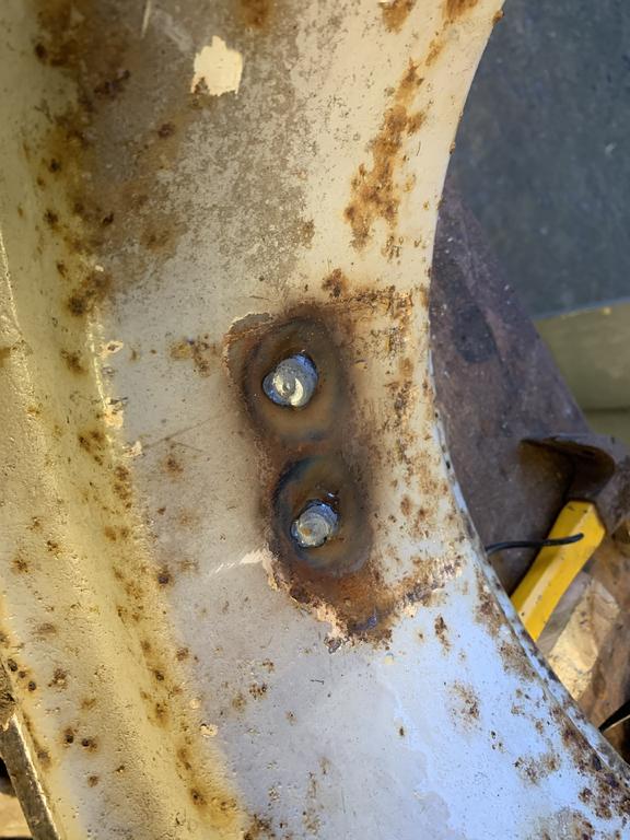

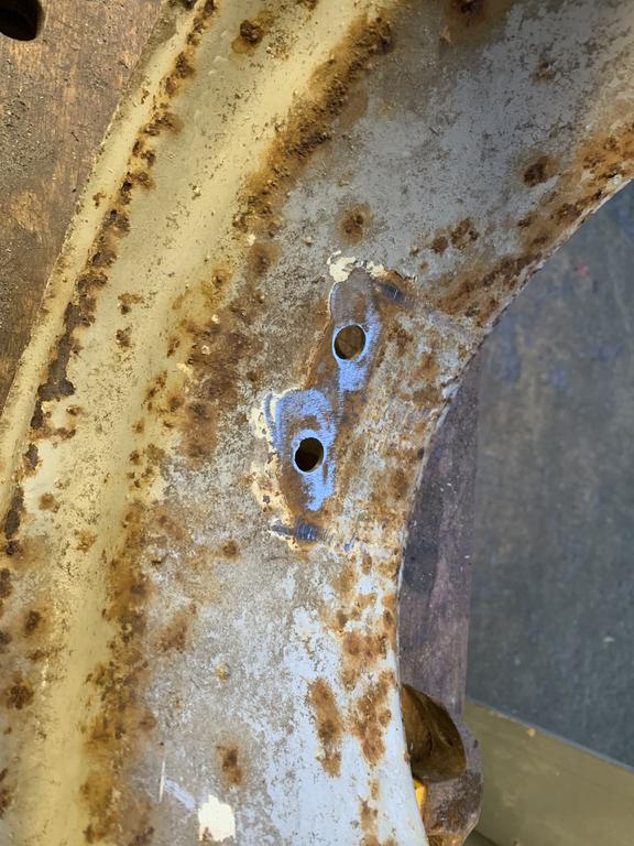

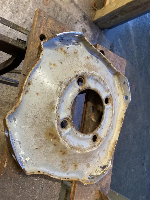

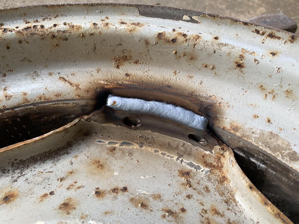

meadowfield 3,191 #19 Posted January 26, 2019 Finished both hubs and mounted the wheels, I didn’t realise how narrow it would be compared to my GT14... So left with the quandary of making bigger spacers or modifying the centres I went with the latter. I drilled the spot welds out and beat the crap out getting the first centre out. Holes welded up up ready to grind down I ran out of mig wire, so that’s it for this weekend... 4 Share this post Link to post Share on other sites

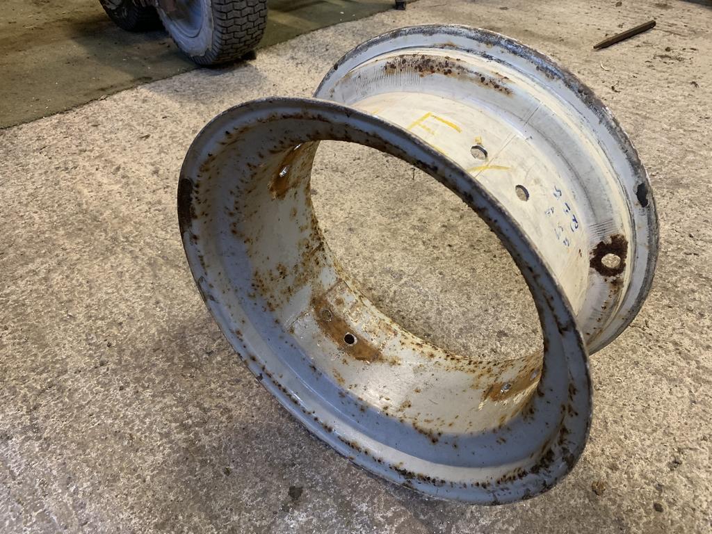

meadowfield 3,191 #21 Posted February 17, 2019 I got around to cleaning up the welds and putting the centres in. didnt get chance to mount them, but the track is now 34” just 2” more than a standard C and a few less than a GT14 6 Share this post Link to post Share on other sites
