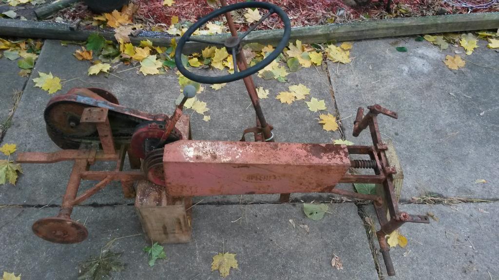

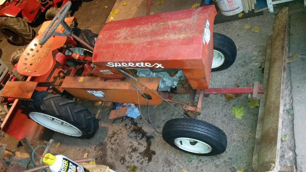

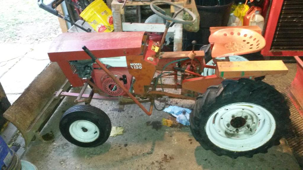

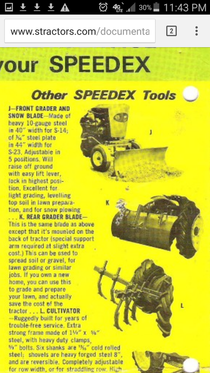

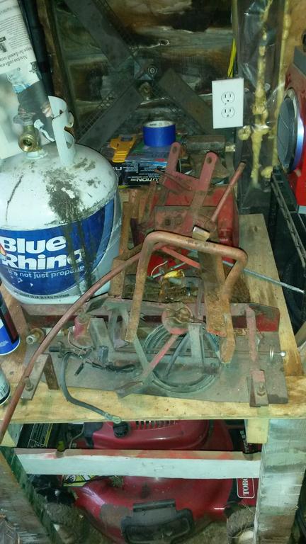

Chris G 3,385 #1 Posted November 10, 2018 (edited) So I have had several of the more rounded hood speedex tractors. They are fun, but I have always wanted one of the more squared hood speedex tractors. Well I found one. It came with a 13hp Honda engine on it. But I did get a bunch of extra parts and two 11hp Briggs engines from other speedex tractors. So I can make it original. The best part is the snow blade. I have looked for one of these for along time, they are the coolest thing to me. Because with another bracket you remove the blade and flip it upside down and then attach it to the back for a grader blade. This blade is only 40in and not the 44. But I'm OK with that, being the widest part of the wheel base is only 31 1/4 wide at the rear. So here it is and I will be working g in this for a winter project. The other tractor in pic is what's left of a 1968 speedex S-17. But there is some good parts there. Also the last pic is a photo of a advertisement for the blade, so you can see what I'm talking about with flipping it. Edited November 10, 2018 by Chris G 9 Share this post Link to post Share on other sites

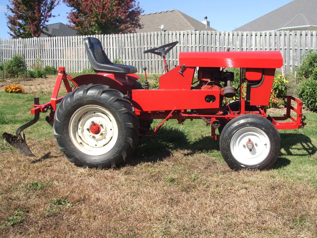

Razorback 1,370 #2 Posted November 10, 2018 Cool!!! Congratulations on finding your Speedex! They ARE fun tractors, and I like mine a LOT! I had no idea that blade could be flipped and used on the rear. Keep us posted on the work you do to yours! Here's mine........ it's amazing how much you can do with a 16hp Briggs engine and some bar stock! 5 2 Share this post Link to post Share on other sites

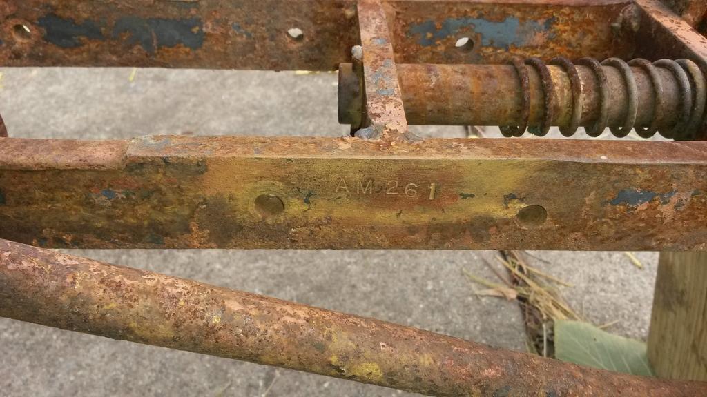

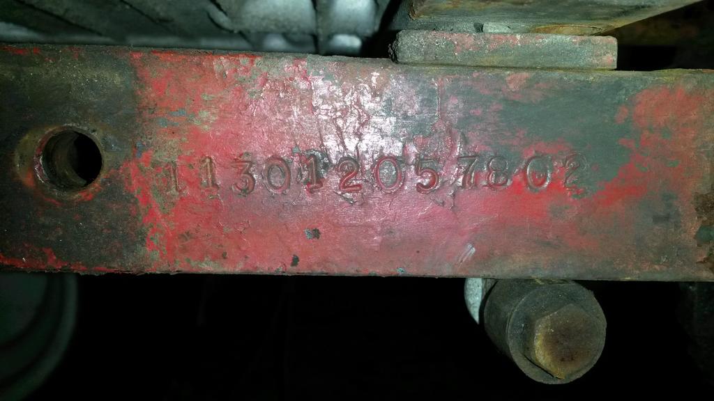

Chris G 3,385 #16 Posted November 11, 2018 (edited) I'm pretty sure the first speedex was the model B in 1938/39 and the last speedex was in 1999. The round hood style started in 1959 and went until the early seventies. Then switched to the square hood styles and a lot of them were known as the American series. But here's a chart for the S series year identification ( 1st phot below). The serial number for s series is stamped on the outside of frame under engine on the passenger side ( second photo below). And square body is same place on opposite side. The square frame usually first four digits is the model number and last four tells the year. Take the last four digits and the first 2 are the year. Like mine in last photo below is model 1130 and 78 is the year. Edited November 11, 2018 by Chris G 2 Share this post Link to post Share on other sites

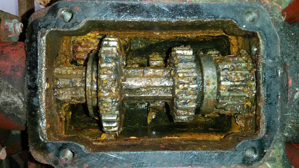

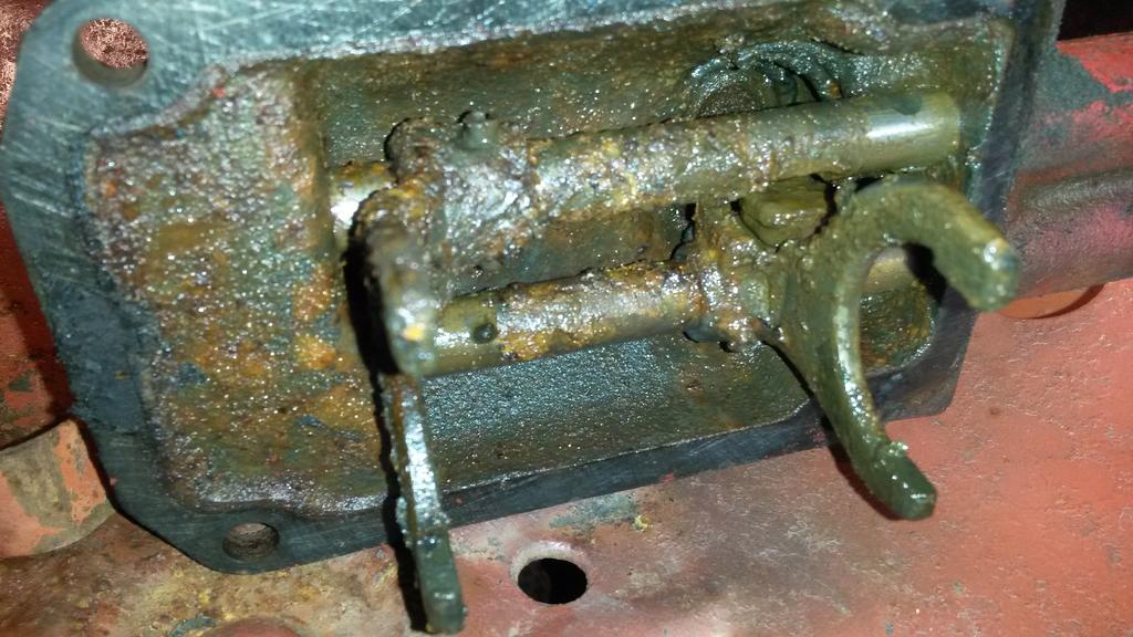

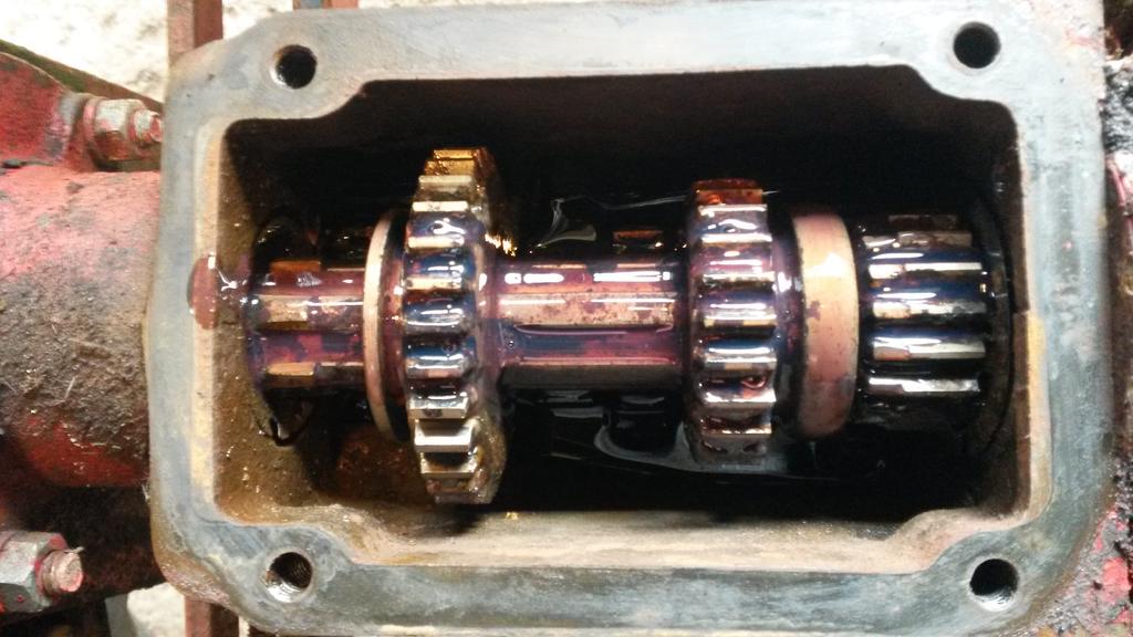

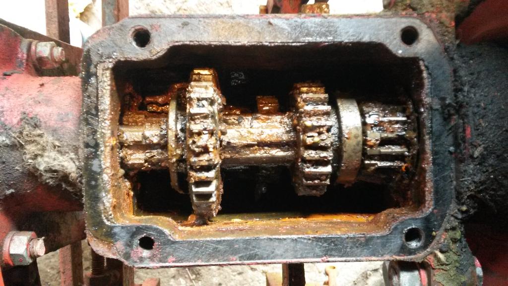

Chris G 3,385 #17 Posted November 12, 2018 (edited) Well I tore in to the transmission today. It was filled with water and all sorts of junk. So i drained it out and flushed it a few times. Then went into cleaning all the pieces and got everything back to working order. When I take the machine all apart I will fully dismantle the transmission and clean again. But for know it's all functional and has nothing binding it up and shifts smooth as can be. It's a T-92 transmission. They were used in some other machines as well, like the Jim dandys and power kings. There actually still building these transmissions as well. First three pics are when I drained it and first opened it up. Last is when I put back together with some fresh gear oil. If ya look close you can see the line were the water was sitting at. Also to refill these it's 8oz of 90 gear oil. Edited November 12, 2018 by Chris G 2 2 Share this post Link to post Share on other sites

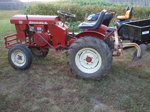

Razorback 1,370 #21 Posted November 13, 2018 3 hours ago, Chris G said: @elcamino/wheelhorse yes they did. The engine slid forward to tension the belt and back to take tension off. I know at one point they became stationary motors and then went back to the sliding motor. Our 1981 model 1631 slides on the rails to tighten the belt. It’s a real hoot! Talk about NOT over-engineered. 3 Share this post Link to post Share on other sites
