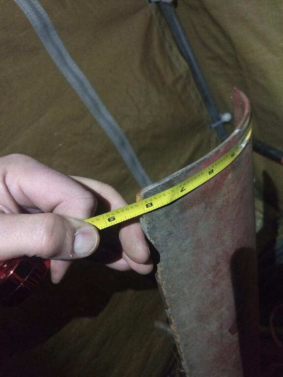

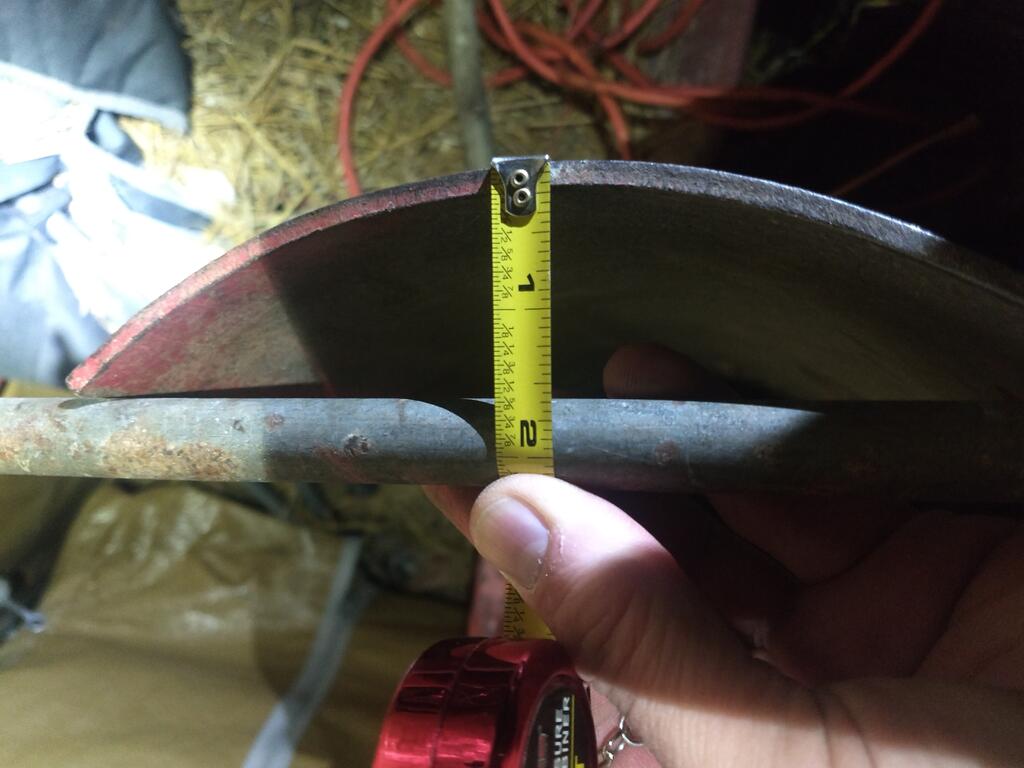

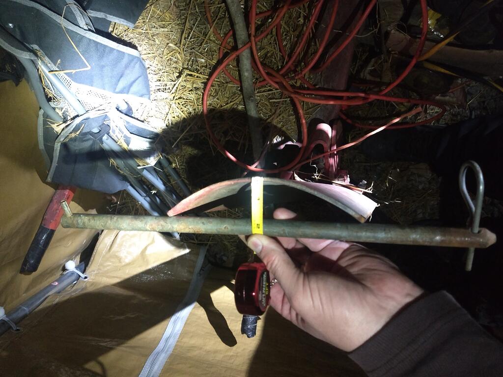

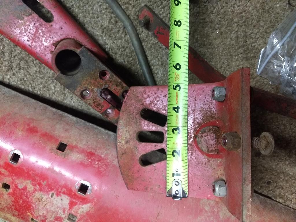

ebinmaine 78,277 #1 Posted November 8, 2018 As specially requested by @pullstart Here is a series of pictures with a tape measure showing the brackets for the mid mount grader. The grader blade itself is 40 inches wide and roughly 8 inches tall including the Curve. Please feel free to ask for specific measurements or further information. 2 11 1 Share this post Link to post Share on other sites

Lee1977 7,632 #11 Posted January 22, 2021 If your going to build a grader blade make it wider then 40". I built mine and made it 48" wide, it's great for digging in to a truck load pile of dirt or stone. The 40" don't give much blade to get into the pile. 1 1 1 Share this post Link to post Share on other sites
DennisThornton 4,773 #12 Posted January 22, 2021 20 minutes ago, Lee1977 said: If your going to build a grader blade make it wider then 40". I built mine and made it 48" wide, it's great for digging in to a truck load pile of dirt or stone. The 40" don't give much blade to get into the pile. Good tip! I'd think that if the front could handle 48" then surely the mid could. 2 Share this post Link to post Share on other sites
ebinmaine 78,277 #13 Posted January 22, 2021 22 minutes ago, Lee1977 said: If your going to build a grader blade make it wider then 40". I built mine and made it 48" wide, it's great for digging in to a truck load pile of dirt or stone. The 40" don't give much blade to get into the pile. I'd agree. Especially for a weighted machine. Share this post Link to post Share on other sites
Lee1977 7,632 #14 Posted January 22, 2021 57 minutes ago, ebinmaine said: I'd agree. Especially for a weighted machine. With a lot of weight and larger engine 54" would not be too wide. It would need to be built strong to take the extra force. 1 Share this post Link to post Share on other sites
DennisThornton 4,773 #15 Posted January 22, 2021 I've got a mid-mount for my XI but that's it, except I do have a road grader blade that's getting lonely in the metal rack. Way longer than 54"! 1 Share this post Link to post Share on other sites
Lee1977 7,632 #16 Posted January 22, 2021 3 minutes ago, DennisThornton said: I've got a mid-mount for my XI but that's it, except I do have a road grader blade that's getting lonely in the metal rack. Way longer than 54"! Mine was 60" before I cut it down. I cut it 48" because there was two existing holes that centered the blade and only had to cut one end. 3 Share this post Link to post Share on other sites
ebinmaine 78,277 #17 Posted February 28, 2021 Here's a few pictures and more measurements as requested by a member. 3 1 Share this post Link to post Share on other sites
8ntruck 8,768 #18 Posted February 1, 2022 On 2/28/2021 at 5:47 PM, ebinmaine said: Here's a few pictures and more measurements as requested by a member. Old thread, but very useful. @ebinmaine I've been doing some math and come up with a dimension of 7.11" for the edge to edge dimension across the front of the blade. Any chance you could check that against reality on your blade when you get a chance? I am working on a design for a 48" grader blade. Thanks 1 Share this post Link to post Share on other sites
ebinmaine 78,277 #19 Posted February 1, 2022 10 minutes ago, 8ntruck said: Old thread, but very useful. @ebinmaine I've been doing some math and come up with a dimension of 7.11" for the edge to edge dimension across the front of the blade. Any chance you could check that against reality on your blade when you get a chance? I am working on a design for a 48" grader blade. Thanks Absolutely. More than happy to. Share this post Link to post Share on other sites
ebinmaine 78,277 #20 Posted February 2, 2022 18 hours ago, 8ntruck said: Old thread, but very useful. @ebinmaine I've been doing some math and come up with a dimension of 7.11" for the edge to edge dimension across the front of the blade. Any chance you could check that against reality on your blade when you get a chance? I am working on a design for a 48" grader blade. Thanks Trina says that measures just less than 7-1/2". Was it me I would go a little less in this case so like you measured at 7.11 or, 7 flat. Share this post Link to post Share on other sites
8ntruck 8,768 #21 Posted February 2, 2022 1 hour ago, ebinmaine said: Trina says that measures just less than 7-1/2". Was it me I would go a little less in this case so like you measured at 7.11 or, 7 flat. Thanks for taking the time to measure. Good. Prediction confirmed by reality. I got a chance to lay it out on CAD yesterday. That checks too. One step closer to starting fabrication. 1 Share this post Link to post Share on other sites

peter lena 9,849 #24 Posted July 12, 2023 @ebinmaine was just thinking , with a same radius straight pipe , you could flame cut out a new blade if needed . think of all the steel pipe thrown away , like to have one in stainless steel , dumpster diver , pete 1 Share this post Link to post Share on other sites
