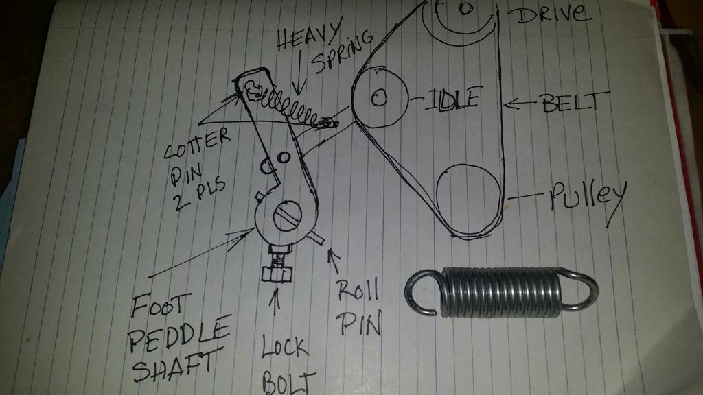

bellevillerod 836 #52 Posted November 6, 2018 Was thinking about a way to get tension on the belt. With the drive on it now what do you think of this? The foot peg already has a roll pin hole for the drive. Does this make sense to you? Or am I in left field. 1 Share this post Link to post Share on other sites
953 nut 69,411 #53 Posted November 6, 2018 You have drawn exactly what I was thinking about. One thing to keep in mind is that the PTO pulley is bigger than the old engine pulley so the blade speed on the mower will be a bit faster. Not too sure how well the old gear drive will hold up with increased RPMs. 1 Share this post Link to post Share on other sites
Pullstart 71,265 #54 Posted November 6, 2018 That looks quite a bit like the factory one, but how do you plan to engage or disengage the pto? 1 Share this post Link to post Share on other sites
953 nut 69,411 #55 Posted November 6, 2018 38 minutes ago, pullstart said: how do you plan to engage or disengage the pto? Guess he will have to use the lever! 1 1 Share this post Link to post Share on other sites
Pullstart 71,265 #56 Posted November 6, 2018 Oh, right... maybe I was trying to ninja a 1047 into the truck! 1 Share this post Link to post Share on other sites

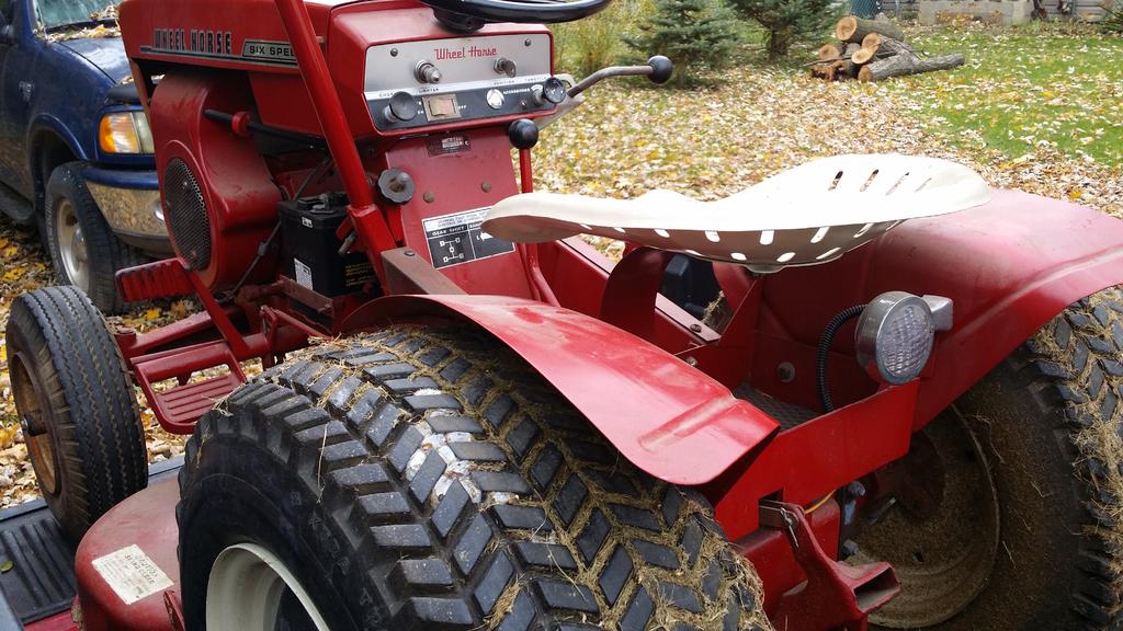

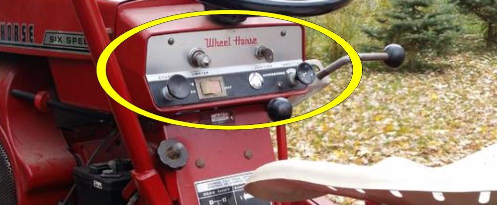

Vinylguy 4,796 #61 Posted November 6, 2018 Rare to find an original dash plate in such great condition. 4 Share this post Link to post Share on other sites

bellevillerod 836 #65 Posted November 6, 2018 Vinylguy that got me too, along with the rest of this thing. It looks almost unused, the paint on the bottom of the deck is still there. There are paper stickers with batch and lot numbers on them still in place. the latch for the hood has no wear on it. I'm when the storm passes here in Mi, getting some detail pics. But I am not an expert by any measure. And still being in the New Toy haze I may come to see that this is 12ft tractor lol. 1 Share this post Link to post Share on other sites

LengerichKA88 1,885 #67 Posted November 6, 2018 That is a sweet looking tractor... talk about right place at the right time! I’ll be following along on this one, but unless you drive it off a cliff I don’t think anyone could be disappointed in whatever direction you take it. It just got its second wind, that’s the important part! 1 1 Share this post Link to post Share on other sites

WHX?? 58,172 #69 Posted November 6, 2018 7 hours ago, Vinylguy said: Rare to find an original dash plate in such great condition. Good eye Terry... very rare 1 Share this post Link to post Share on other sites
Herder 2,356 #70 Posted November 6, 2018 9 minutes ago, WHX21 said: Good eye Terry... very rare I have a Charger that's spent it's hole life stored inside and the dash plate not nearly as nice. 1 1 Share this post Link to post Share on other sites
