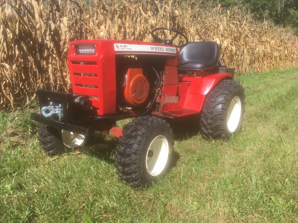

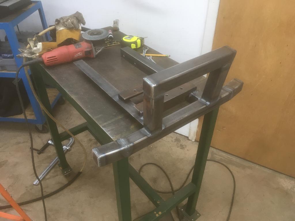

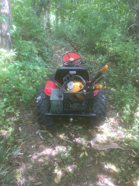

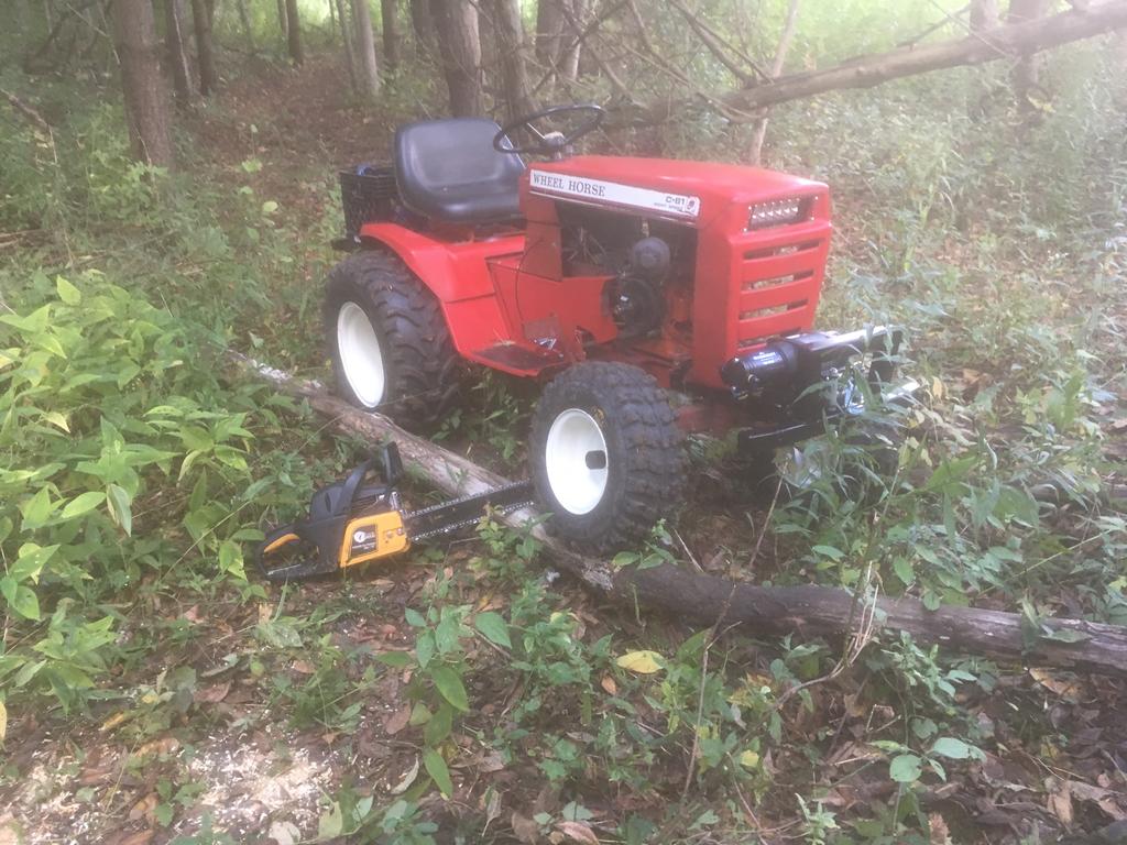

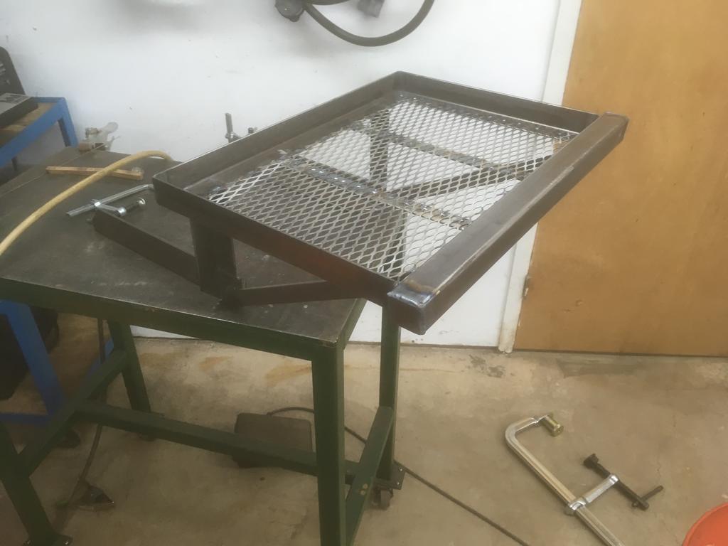

Crazy_Carl 254 #1 Posted September 29, 2018 (edited) I wanted to share with you Wheel Horse fans my latest off road upgrades I’ve done to my C-81 while trying to not butcher the original tractor. I built a bumper with a winch for the front and a rear rack too. I also made a video about it. https://youtu.be/YT_SguWXuN4 Edited September 29, 2018 by Crazy_Carl 13 9 Share this post Link to post Share on other sites

peter lena 10,103 #4 Posted September 29, 2018 good job, adapting the horse to your needs, good choice on the square tube and welding, more than enhances its working ability. having cleared a few lots , I wish I had your horse there as the power point to get things done. that winch is a great stand off puller, thank you for the pictures/ video , pete 3 Share this post Link to post Share on other sites

Crazy_Carl 254 #10 Posted September 30, 2018 (edited) Thanks everyone! I’ve put a ton of hard work into this tractor. I actually tig welded everything which takes a long time but produces beautiful strong welds. A buddy made a Wheel Horse ad from a screenshot from the video you guys will get a kick out of. The rear tires are 25x10-12 bear claws. I’m running 1.5” wheel spacers in the rear. The front tires are douglas jr xc 18x6-8. Edited September 30, 2018 by Crazy_Carl 4 8 1 Share this post Link to post Share on other sites

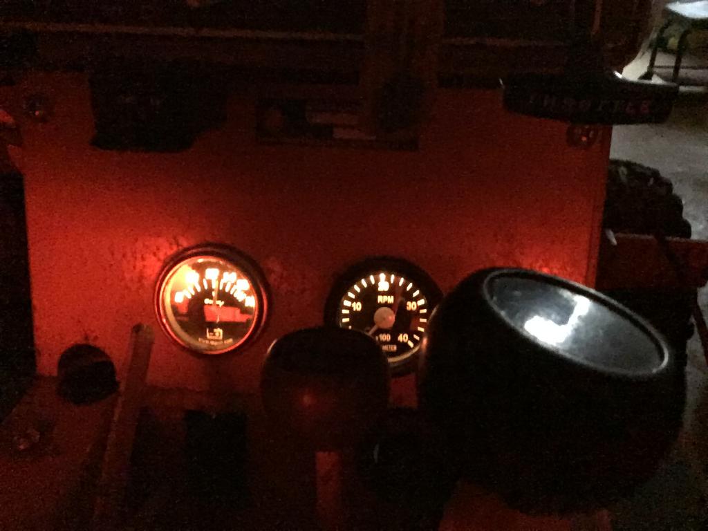

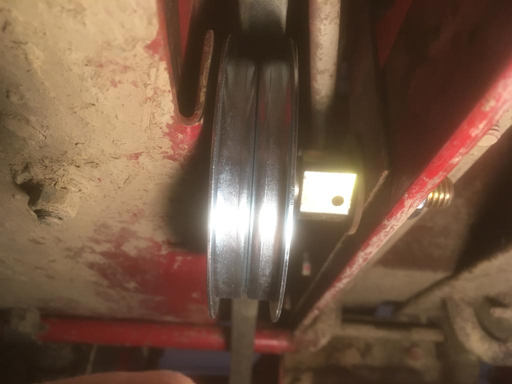

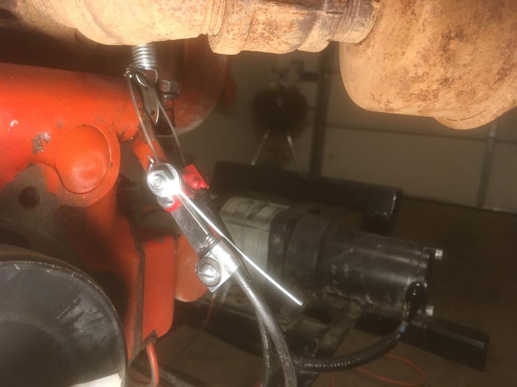

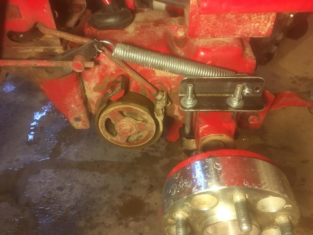

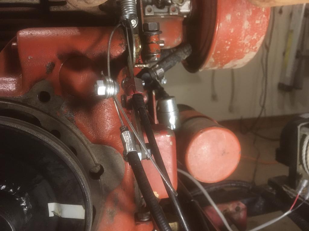

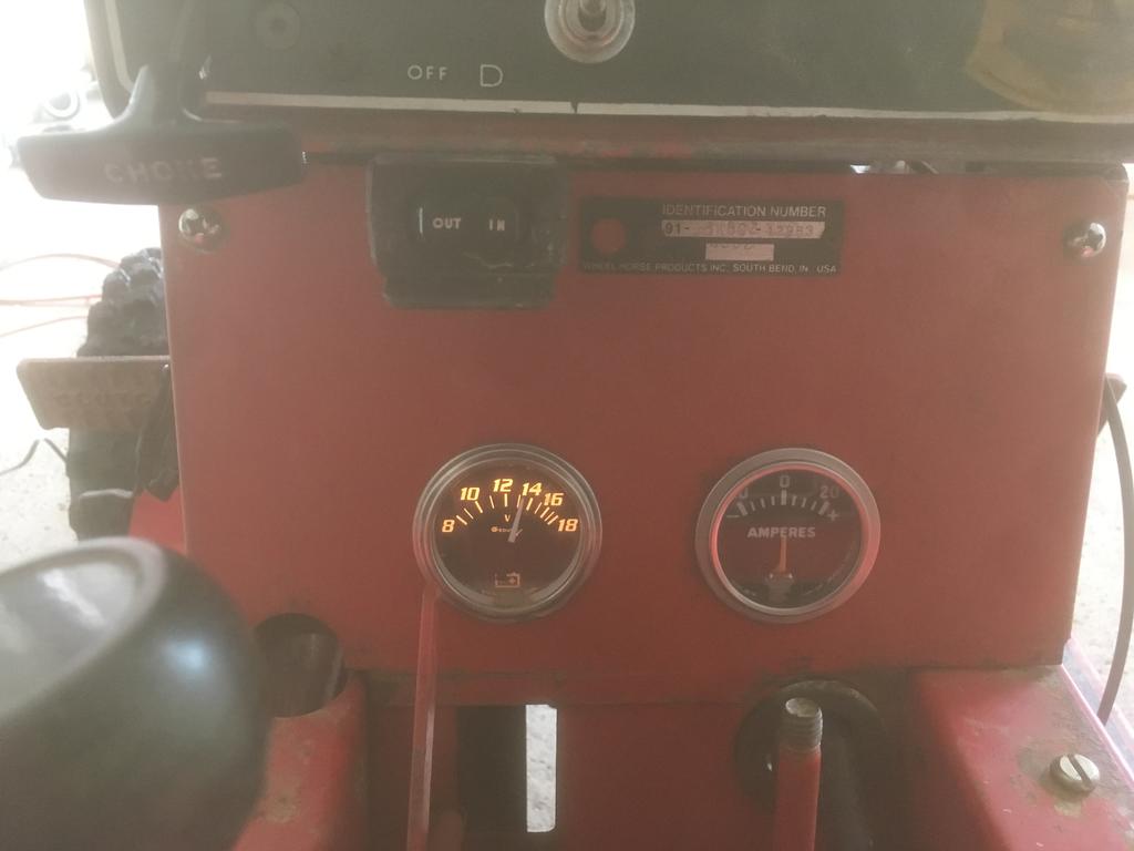

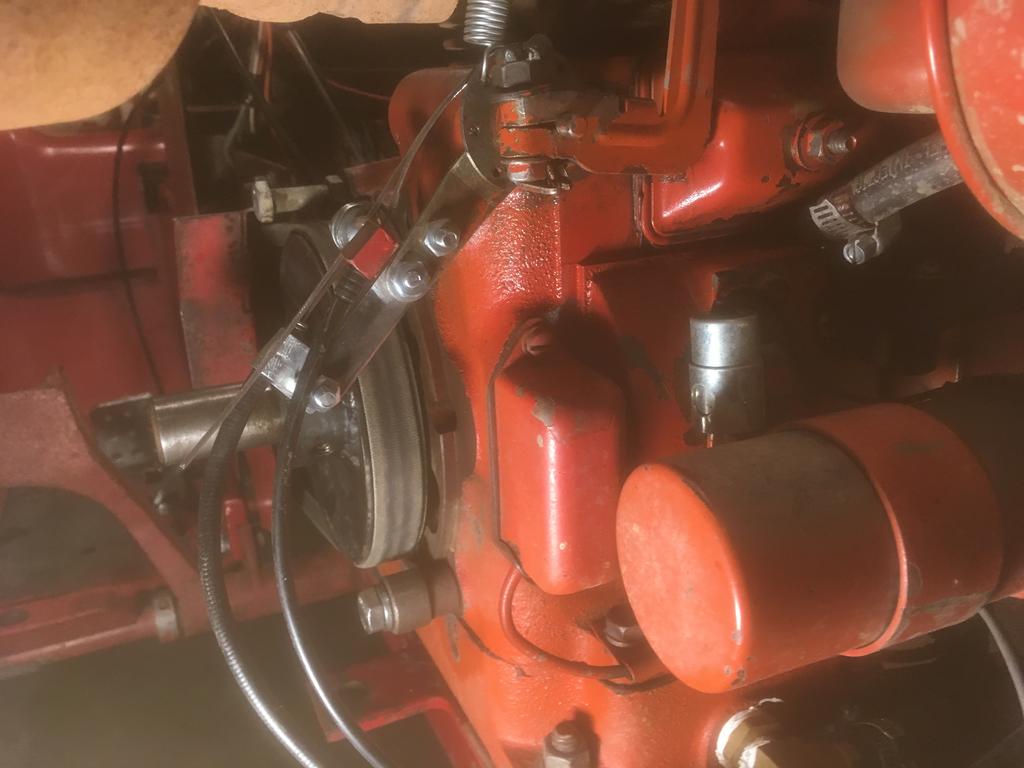

Crazy_Carl 254 #20 Posted January 22, 2019 I've had some time on my hands lately so I made some improvements to my clutch, belt drive and I installed a dual throttle on my K181. Dual throttle Youtube video So I've installed a voltmeter on this tractor next to the factory ammeter which doesn't really work. I'd like to replace the ammeter with a 2" tachometer but I'm looking for technical advice on how to do that on a K181 with a 12v coil ignition that uses points. Any advice would be greatly appreciated. Share this post Link to post Share on other sites

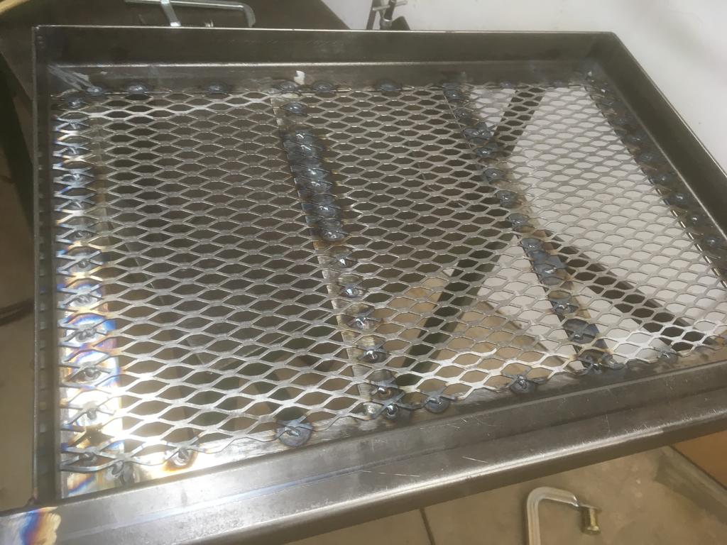

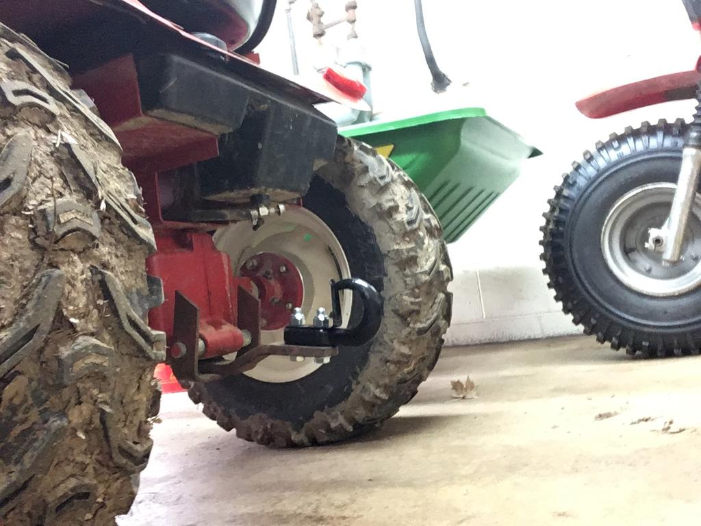

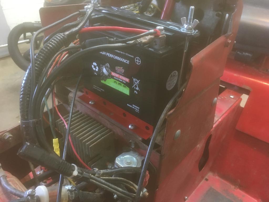

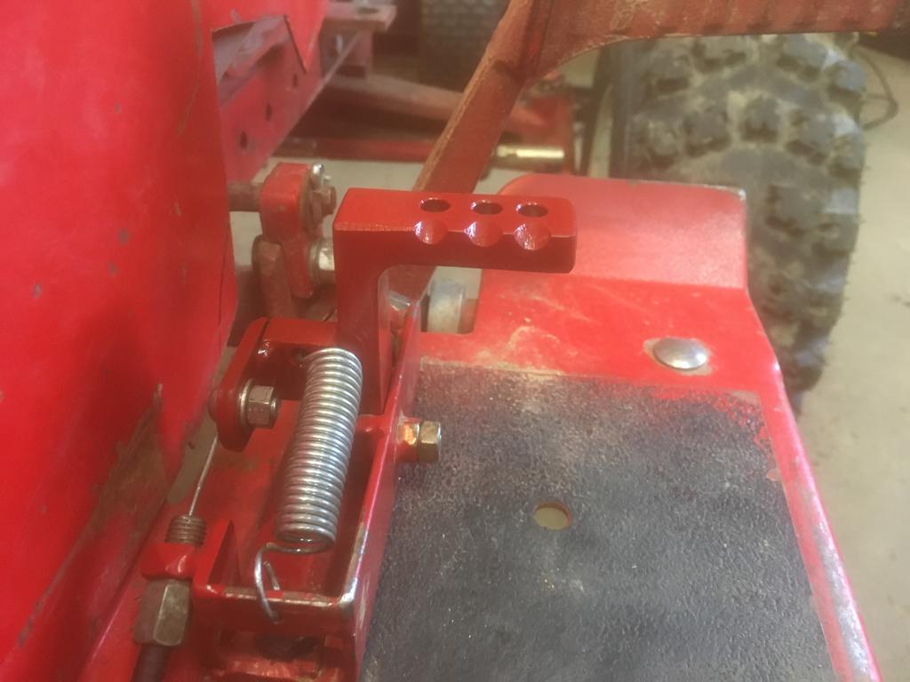

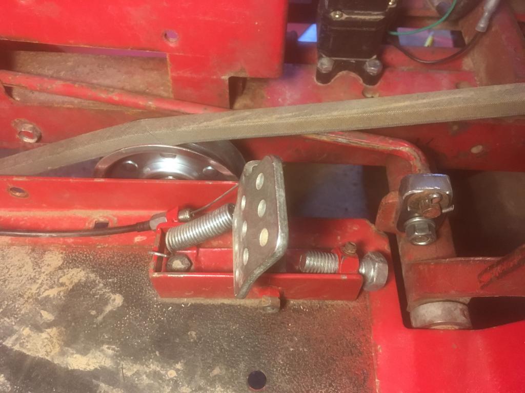

Crazy_Carl 254 #25 Posted May 9, 2019 Well I got a new tattoo as a tribute to my love of Wheel Horse tractors and especially my off road C-81. I did get my tach installed, calibrated, and after the company sent me a new backlight, it lights up too. I also fabbed up a new stronger gas pedal with some anti-slip grooves in it. I installed a harley sportster battery for more CCA in a compact package that won't spill acid when I get the tractor sideways. I also bolted a cheap $7 harbor freight tow hook to the back. Here's the latest video of me riding it with other Wheel Horses in Ohio. riding video 1 2 Share this post Link to post Share on other sites
