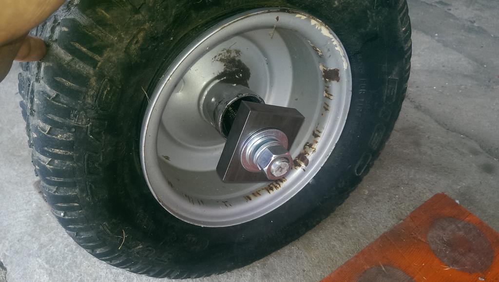

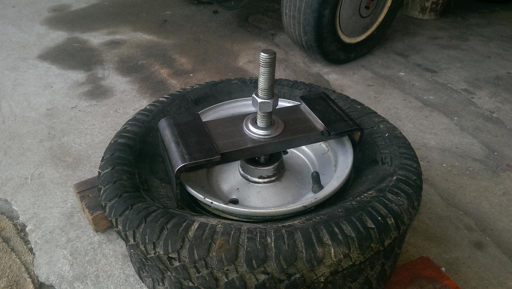

I have posted it before but I'll pop it up again my personal home made bead buster (unfortunately I welded it solid for 8" rims but it could be made to do 4",6",8",10 or 12" wheels...some angle iron, 1/2" x???  flat and 3/4-16 all thread, Jeff.

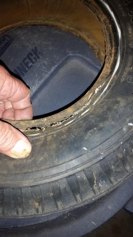

I hear ya Jason... I recently tried to bust a set of tires off cloride rims and ripped the bead to sidewall. The tires were actually in good shape and orginal 'Burb  tires. Might not have happened had I the proper tool(s). Going to try to save them anyway.
Nice Billy but on older stuff where you are trying to save a 60 year old tire or rim?? You have to go very easy. Especially if they have sat that long with the nasty in them
Sorry if going off topic here Karl, you know how we get, might be best with Craig's offer but keep the speed dial thing in mind! :lol:
