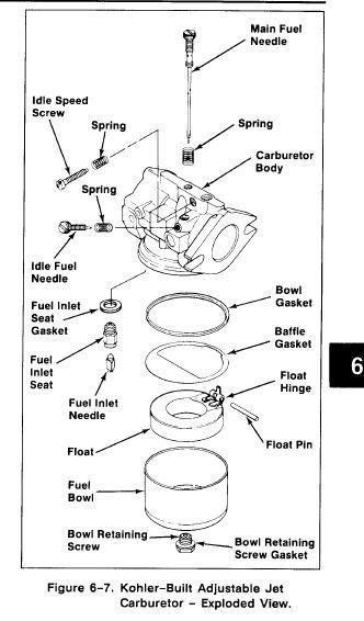

ryanmfairbank 26 #31 Posted September 26, 2018 @pfrederi okay...I just got my machine back together and I’m ready to adjust the carb...the question I have is one of terminology...I have a main fuel needle, an idle speed needle, and an idle fuel needle...the manual refers to setting low idle and high idle...what am I missing here? Share this post Link to post Share on other sites
ryanmfairbank 26 #32 Posted September 26, 2018 So, I have two separate settings...low idle and high idle....am I adjust the motor at both speeds, recording the results and then doing a final adjusment somewhere between the two? Share this post Link to post Share on other sites
pfrederi 20,668 #33 Posted September 26, 2018 High speed is the one on the top idle is the angled one on the side. idle speed setting is cross wise Share this post Link to post Share on other sites
