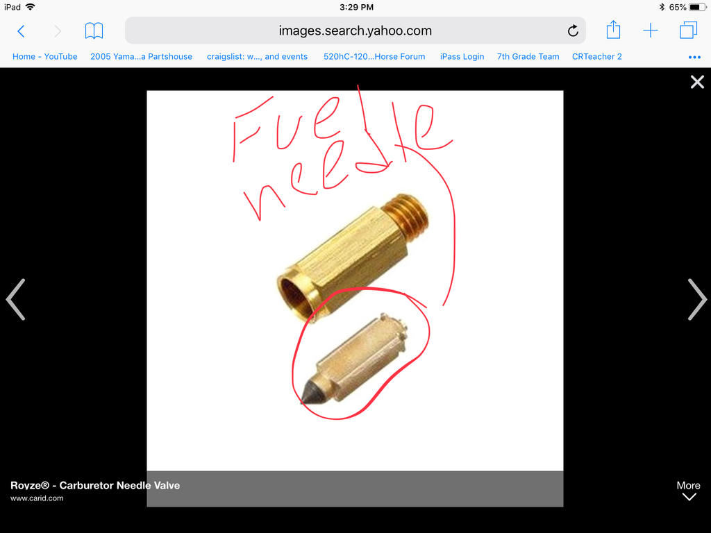

520hC-120 136 #6 Posted September 24, 2018 The float on your carb may be stuck or the needle is. First tap the bowl of the carb GENTLY. If that does not work take your carb off. I’ve found that when a new carb kit is bought the fuel needle (in pic one) is a little too big and gets caught in the seat. So if this is the problem then use your original needle to fix it. I’ve had to do this trick over 5 times! 1 Share this post Link to post Share on other sites

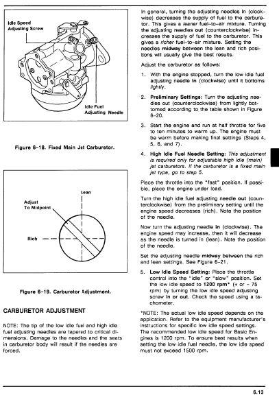

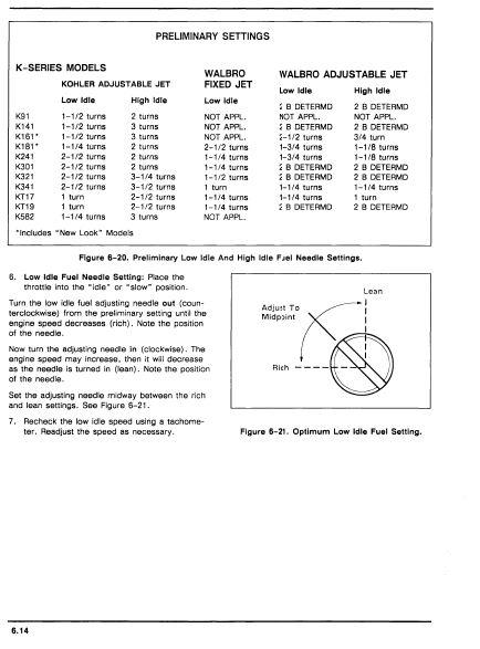

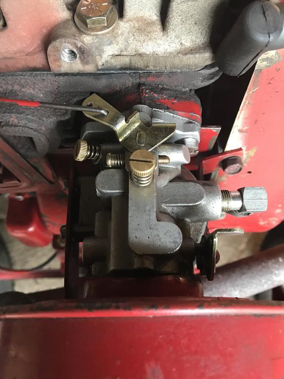

ryanmfairbank 26 #24 Posted September 25, 2018 My carb is an aftermarket carb...how do I determine which needle is which? I guess if I better understood how the carb works, I could determine this myself... Share this post Link to post Share on other sites
WH nut 553 #25 Posted September 25, 2018 Top one is the high speed jet 1 1 Share this post Link to post Share on other sites
