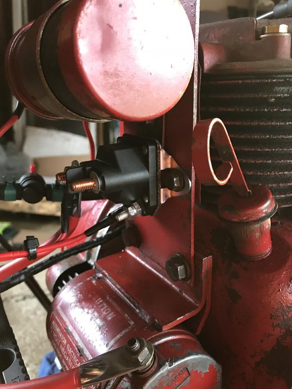

ryanmfairbank 26 #8 Posted September 24, 2018 This should be a good ground, right...does it matter if the piece that the solenoid is bolted to is in front of or behind the starter?? Share this post Link to post Share on other sites
ryanmfairbank 26 #9 Posted September 24, 2018 The cable to the large post on the solenoid was disconnected when I took the photo... Share this post Link to post Share on other sites

pfrederi 21,184 #11 Posted September 24, 2018 It must do ohms...Check from the base of the solenoid to the battery - terminal should be very little resistance 1 Share this post Link to post Share on other sites
