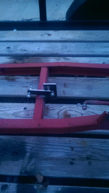

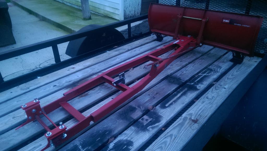

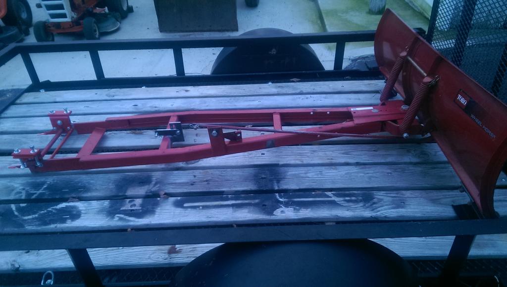

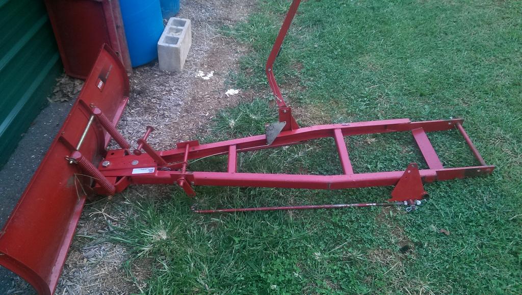

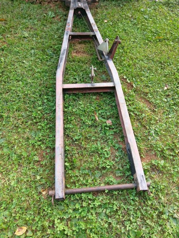

WVHillbilly520H 10,379 #5 Posted September 15, 2018 3 hours ago, gwest_ca said: No. 79252 is intended to fit the 260-Series 1986-on from this list would fit perfectly. Garry Garry is correct that's it's not intended to fit but with a little bit of fabrication it will fit just fine as I converted(removing the unneeded parts and adding center lift point) one over myself a couple years ago, if the price was right and you can weld and fabricate the needed part (basically the center lift link) then this may be feasible, 1st pic right off a 260 series, next are after I converted, and last B/C3/400 series frame, Jeff. 2 Share this post Link to post Share on other sites
