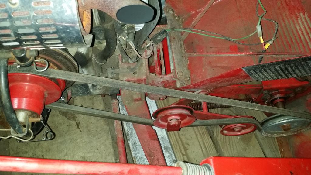

Have 520h with 42" snowblower is a way to make adjustments on it the belt to loses.

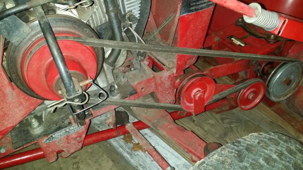

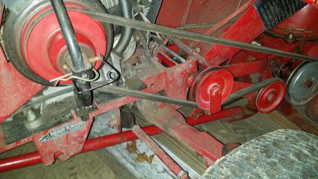

Here's my  pics

Everything looks correct in your picture.   A couple things that may cause the belt to jump off.   Vibration from an unbalanced auger, or a weak tensioner spring, or a piece of debris in one of the three VEE pulleys.    Check each Vee pulley carefully and make sure there is not something lodged in one of the Vees.

Agreed Ed, tension spring looks to be a bit unloaded tho? Too short on the belt?
Good pics Goat

Well, an unbalanced auger is usually caused by a bent auger shaft that is causing the auger to run out.   Look at the gap between the auger "paddles" and the housing as you slowly turn the auger.  If the gap is not constant, the auger is running out and could cause the vibration.       Bad bearings in the auger or jack shaft could also cause a vibration.
