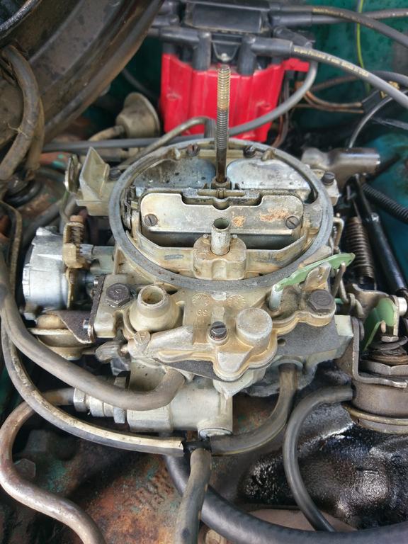

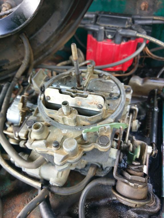

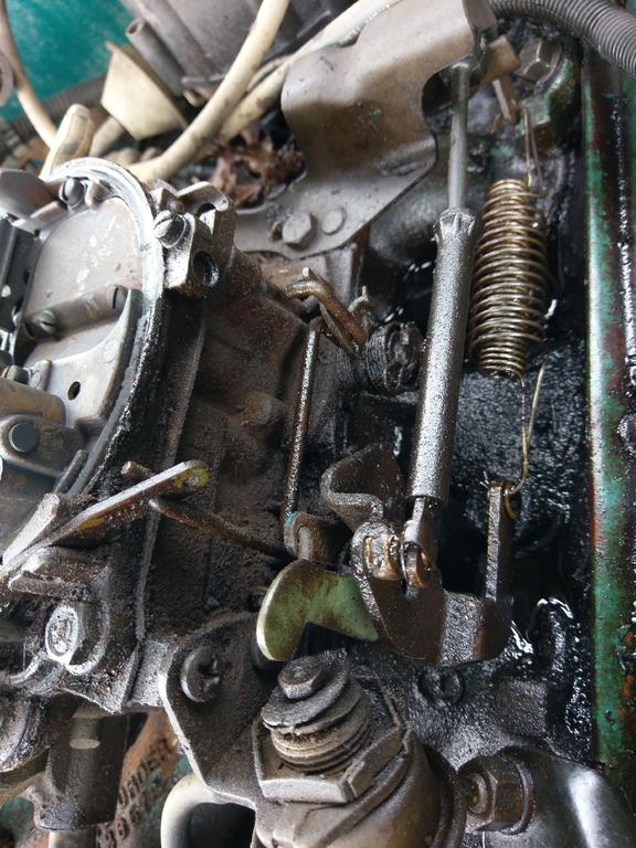

WVHillbilly520H 10,378 #26 Posted September 18, 2018 Pulled the nasty filthy leaking (from ethanol) Q-jet carb disassembled soaked and put a renew kit it and back on, also installed new plugs and wires, performance distributor cap, rotor button and coil, valve cover gaskets and removed about 50 pounds of useless A/C pump and lines, next up oil and filter change. Runs and idles so much better. 3 Share this post Link to post Share on other sites

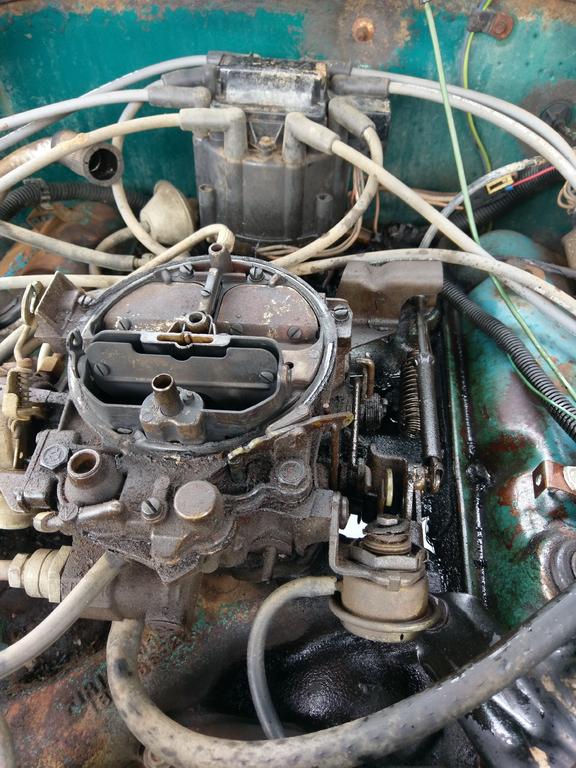

WVHillbilly520H 10,378 #27 Posted September 19, 2018 Here's the after clean rebuild pics...still the O.E. non adjustable emissions carb from '79 I need to get the pressure washer and purple power out and give it a real degreasing. 3 1 Share this post Link to post Share on other sites

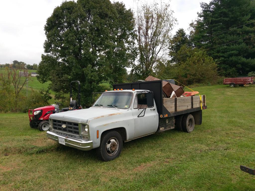

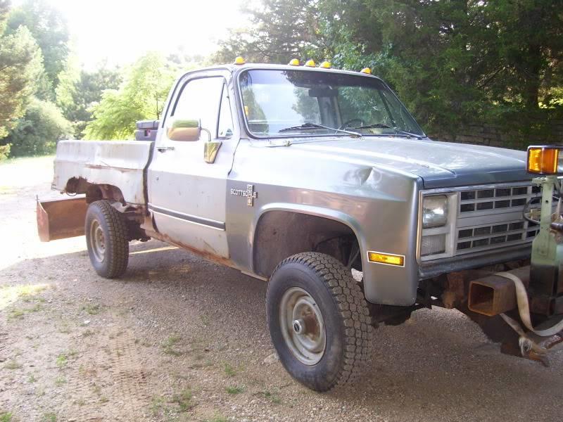

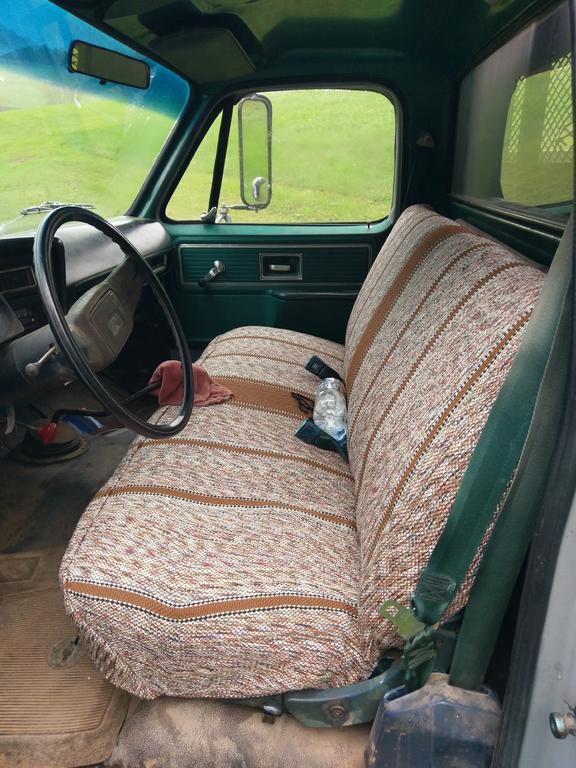

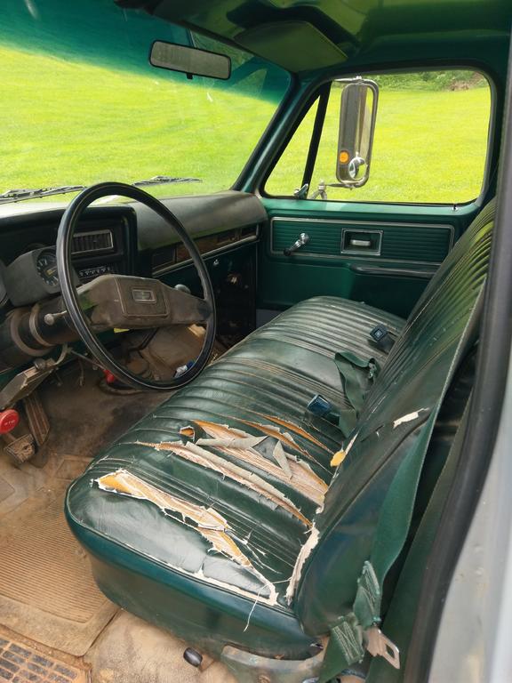

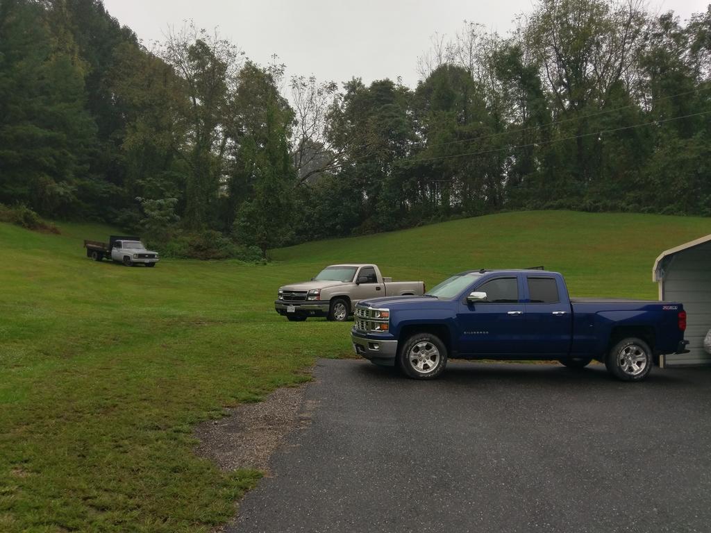

WVHillbilly520H 10,378 #28 Posted September 23, 2018 (edited) F.I.L has a couple of these square body C/K trucks and happened to have a seat cover laying around and I asked if I could put it to use, so at least now I'm not sitting on shredded vinyl anymore and picture of the "3 Amigos" plus his '79 K3500. Edited September 23, 2018 by WVHillbilly520H 2 2 Share this post Link to post Share on other sites

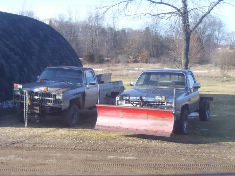

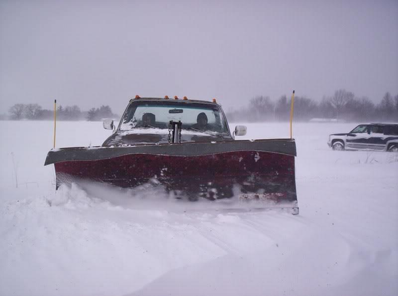

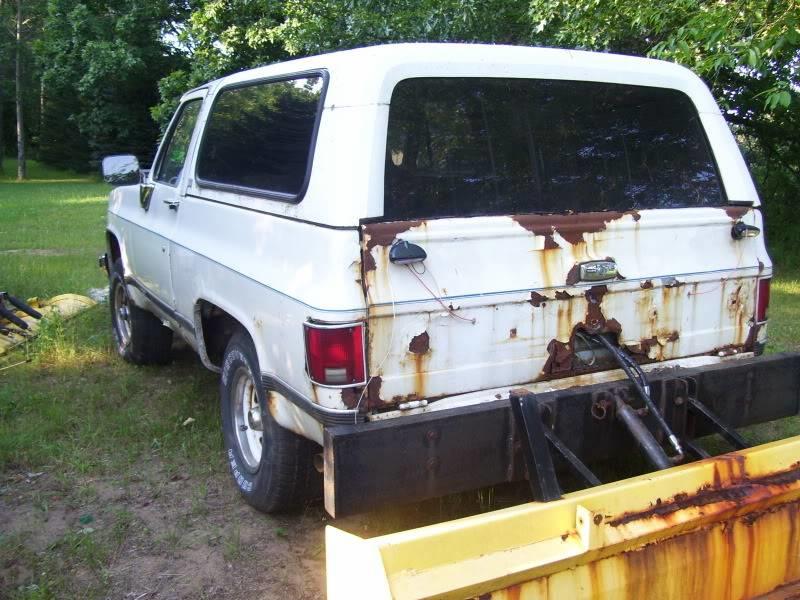

Pullstart 70,962 #29 Posted September 25, 2018 Such clean sheet metal! I’ve had a couple square bodies... or what was left of them. That ‘82 long box was a beast of a plow truck! Had long tube headers and dual purple hornies dumping straight down at about the transfercase. A bungee cord was strung behind the seat to hold the doors closed! The blazer had zero body mounts intact. Once I figured that out, I finished the plow season with it, then parted/scrapped it out. I didn’t allow any passengers, not even my 2 year old or newborn (who both frequented the truck before I knew how bad it was) 1 1 1 Share this post Link to post Share on other sites

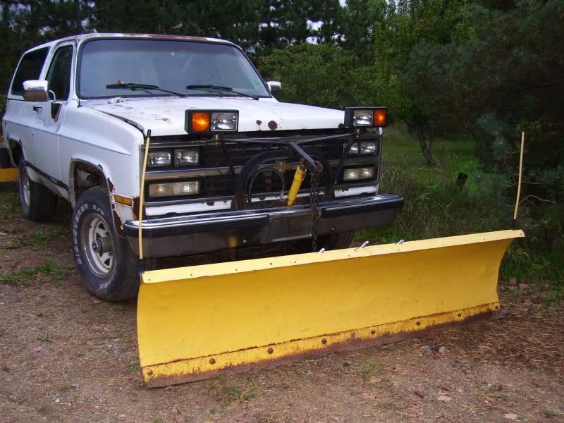

Pullstart 70,962 #31 Posted September 25, 2018 This is how I occasionally wash the ice worms out of my truck... ya know, in my best efforts to keep it clean! This super duty had 35” tires, for reference. And don’t tell anyone I used to own one of those “F” word vehicles 4 Share this post Link to post Share on other sites

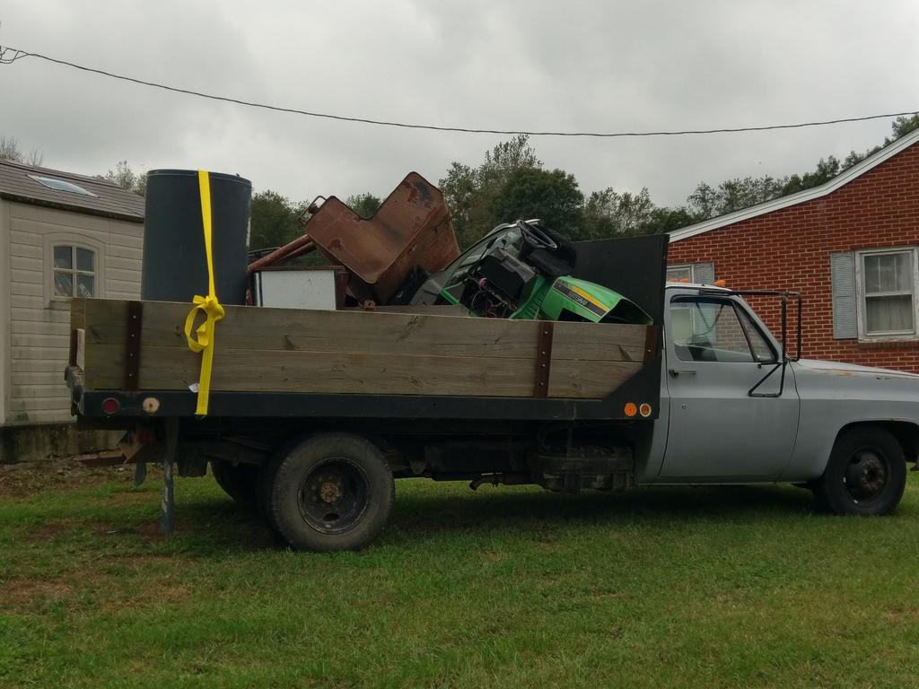

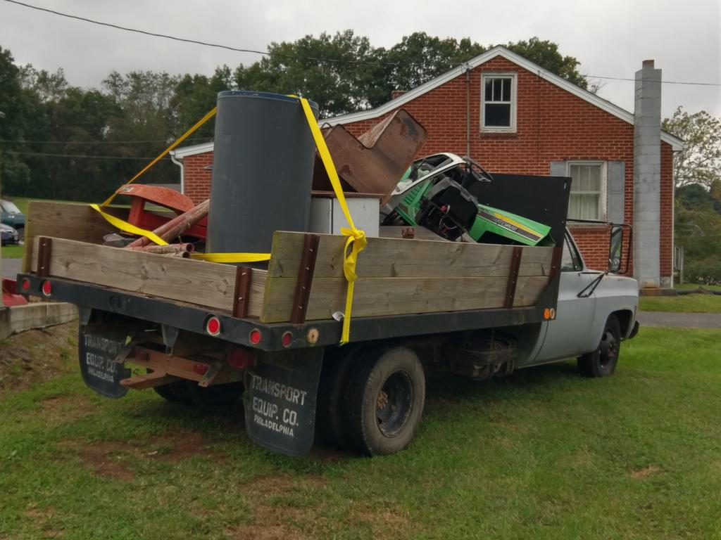

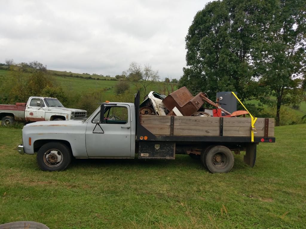

WVHillbilly520H 10,378 #39 Posted October 5, 2018 @Machineguy, @PeacemakerJack, @pullstart, @Achto, here's the first load this old fella hauled since bringing it home, 2760 pounds of junk metal and plastic the F.I.L had laying around, went across the scales loaded at 10680 total, so around 7900 "empty". 8 Share this post Link to post Share on other sites
PeacemakerJack 11,022 #40 Posted October 6, 2018 Put the old dude to work that’s what I like to see! 2 1 Share this post Link to post Share on other sites
19richie66 17,931 #41 Posted October 6, 2018 Always nice to make more room 1 1 Share this post Link to post Share on other sites
Pullstart 70,962 #42 Posted October 9, 2018 Is that all you can get in there? Sheeesh, my Colorado could tackle that haul! 5 Share this post Link to post Share on other sites
WVHillbilly520H 10,378 #43 Posted October 9, 2018 5 hours ago, pullstart said: Is that all you can get in there? Sheeesh, my Colorado could tackle that haul! I needed your guidance but you were too far away, I was going load it up over flowing, but my F.I.L was done for the day. 2 Share this post Link to post Share on other sites

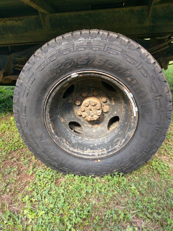

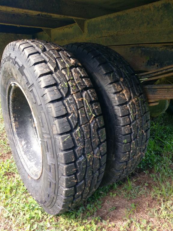

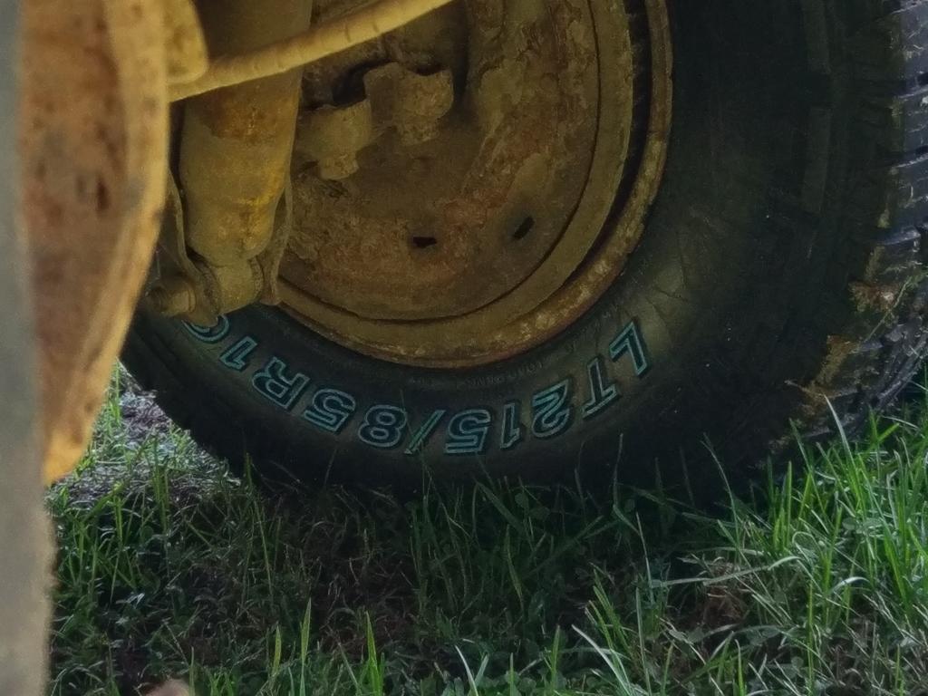

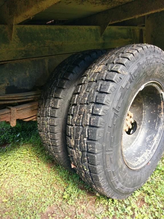

WVHillbilly520H 10,378 #44 Posted October 13, 2018 The scrap payout helped reshoe the rear axle...just got them put on this morning at our local "Wally World"...same brand as the fronts just a bit more aggressive tread. 2 Share this post Link to post Share on other sites
Pullstart 70,962 #45 Posted October 14, 2018 I love a set of 215/85’s! Grab you some tire chains and you’ve got a dozer! 1 Share this post Link to post Share on other sites
WVHillbilly520H 10,378 #46 Posted October 14, 2018 4 hours ago, pullstart said: I love a set of 215/85’s! Grab you some tire chains and you’ve got a dozer! I think I have a set of army tire chains going to see if they fit sometime soon. 2 Share this post Link to post Share on other sites
squonk 47,616 #47 Posted October 14, 2018 Didn't that Crochruster have the knock out plugs for the mixture screws? Also looks like you needed $10 worth of vacuum line. If I had a Dollar for every Q-jet I redid I'd have a bigger garage. Share this post Link to post Share on other sites
WVHillbilly520H 10,378 #48 Posted October 14, 2018 4 minutes ago, squonk said: Didn't that Crochruster have the knock out plugs for the mixture screws? Also looks like you needed $10 worth of vacuum line. If I had a Dollar for every Q-jet I redid I'd have a bigger garage. Yeah it has the aluminum welch plugs in front of the mix screws just didn't bother them this round, changed a lot of vacuum lines out while I was in there, runs much better than the day I brought it home. Share this post Link to post Share on other sites
squonk 47,616 #49 Posted October 14, 2018 How's the Quadra-Bog? I've seen guys adjust the tension on the secondary air valves way too loose thinking they'd get more power. Whilst the opposite was true. Again if I had a dollar...... Share this post Link to post Share on other sites
WVHillbilly520H 10,378 #50 Posted October 14, 2018 25 minutes ago, squonk said: How's the Quadra-Bog? I've seen guys adjust the tension on the secondary air valves way too loose thinking they'd get more power. Whilst the opposite was true. Again if I had a dollar...... No bog just a bit of a stubble and if indeed the original engine at 220k I believe it's a Cam lobe or 2 worn down, had a 79 Malibu years ago one of the best Q-jets I ever had no bog, stubble or hesitation from cold start up to running at operating temp, I am a firm believer in these old carbs when adjusted correctly on a overall good condition engine. 1 Share this post Link to post Share on other sites
