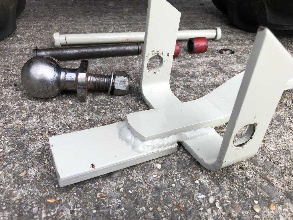

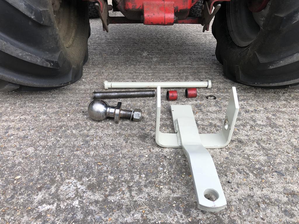

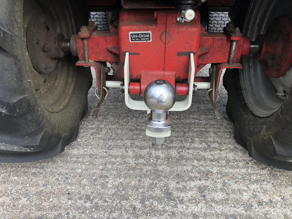

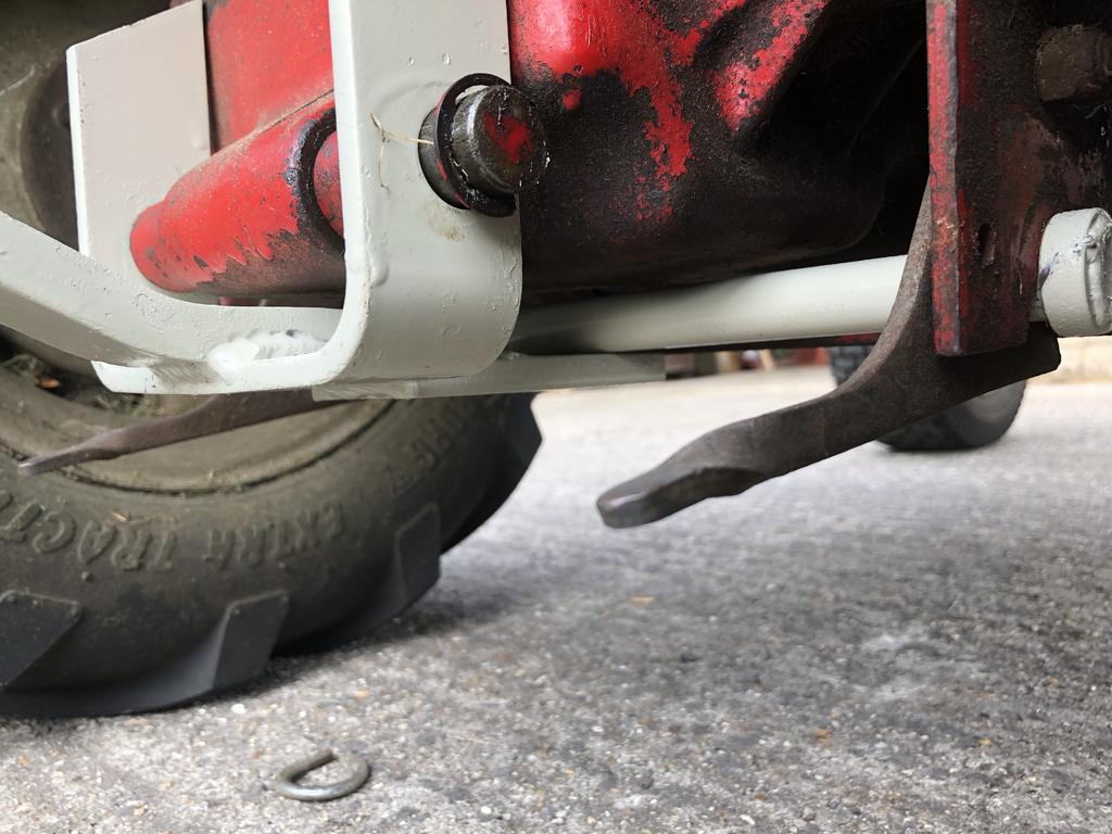

farmer 1,075 #1 Posted July 18, 2018 Bit of a misleading title for this modification, but it’s a continuation of the ‘Beefing up’ series. The standard hitch although low is pretty much good enough for most towing jobs that a garden tractor is expected to carry out. I have also seen on RS heavy duty 2” receiver hitches that are ‘bolt up’ and raise the towing height allowing car/ boat trailers to be moved. If you have the need, this type of hitch is probably be best solution. The intention of this little build is to use the standard hitch with heavier tongue weights whilst not having to worry about possible damage to the transaxle (where the hitch could crack or break up through from the bottom). The chosen tractor would also need to be fitted with the tiller/ blade rear bracket. Materials 310mm length of solid bar 19mm diameter (washers welded at the ends) 100 x 50 x 5mm flat bar. When mounted the extention on the hitch comes up against the bar and this takes all the pressure off the transaxle, there is approximately 5mm clearance between bar and axle case. Pictures express better than words. Painted off white because I seem to have quite a bit of that left over !! 7 7 Share this post Link to post Share on other sites
Tractor boy 238 #2 Posted July 18, 2018 @farmer is that white rod welded to the frame of the hitch or is it held on some other way? Share this post Link to post Share on other sites
farmer 1,075 #3 Posted July 18, 2018 Hi Tractor boy the rod is a separate part latched up in the rear bracket used normally for the blade or tiller. 2 Share this post Link to post Share on other sites
cschannuth 3,794 #4 Posted July 18, 2018 21 minutes ago, Tractor boy said: @farmer is that white rod welded to the frame of the hitch or is it held on some other way? I believe it is just inserted into the rear axle hitch where the snowplow would normally insert. Then the new hitch just rides on the bottom of the rod freely. 1 1 Share this post Link to post Share on other sites

Sarge 3,462 #8 Posted July 19, 2018 I've glued pieces of 1/4" rubber to the ends of those hitches on mine to give it a cushion to prevent possibly cracking the trans case - seems to work well but I do like your idea with steel braced to another object better. If one were to use a front blade - that modification should still work fine using the cross rod on the rear of the blade frame instead. Good job ! Sarge 2 Share this post Link to post Share on other sites
