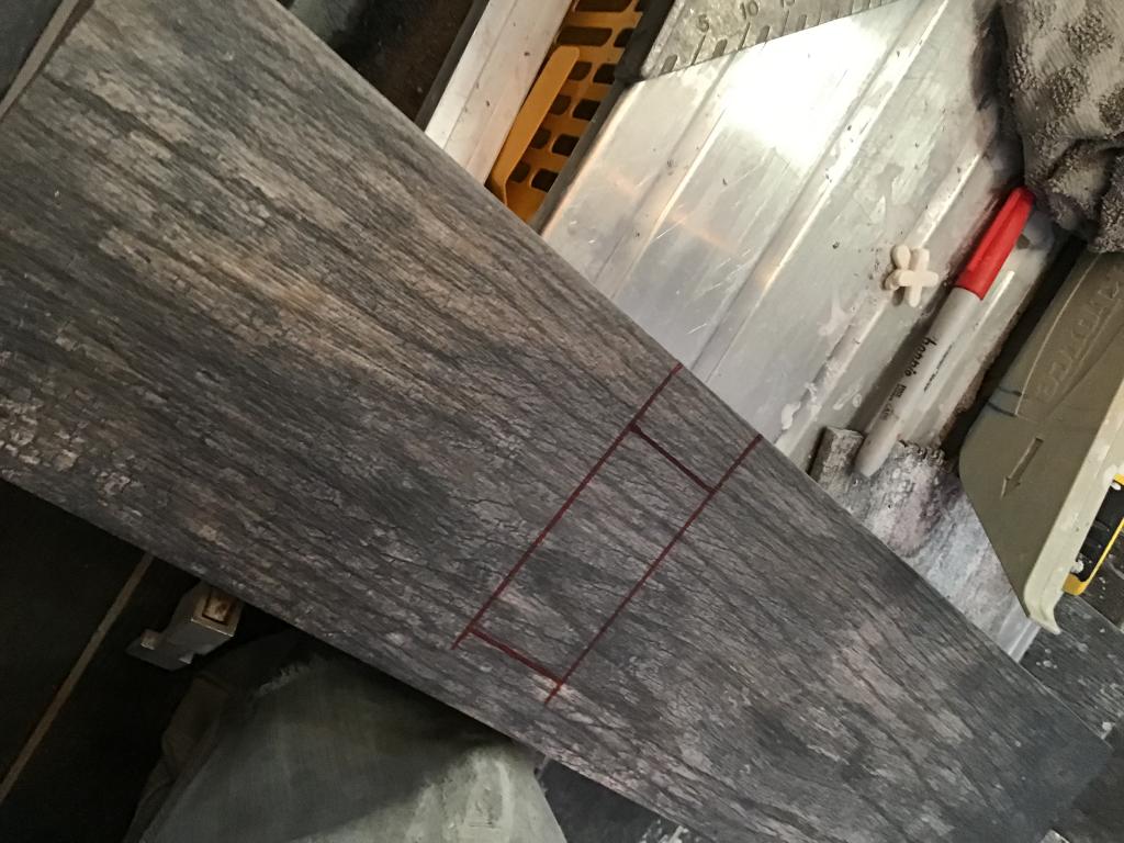

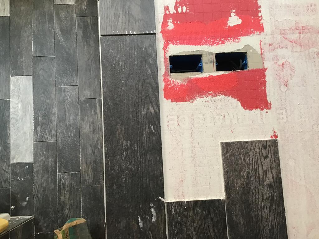

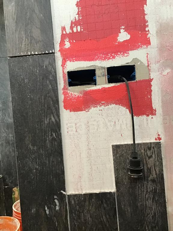

Pullstart 71,455 #226 Posted December 20, 2019 I wonder how many tiles I’ll break trying to put a square hole in one before I settle with a couple extra grout / cut lines? 1 Share this post Link to post Share on other sites

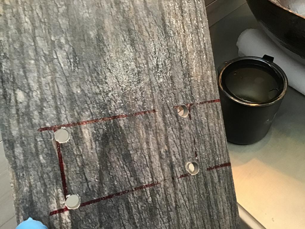

Pullstart 71,455 #227 Posted December 20, 2019 So far, so good. I drilled holes with a diamond bit. Now I’ll head to the shop for some cut off wheel action. Share this post Link to post Share on other sites
Pullstart 71,455 #228 Posted December 20, 2019 Wow, it worked! 3 1 Share this post Link to post Share on other sites

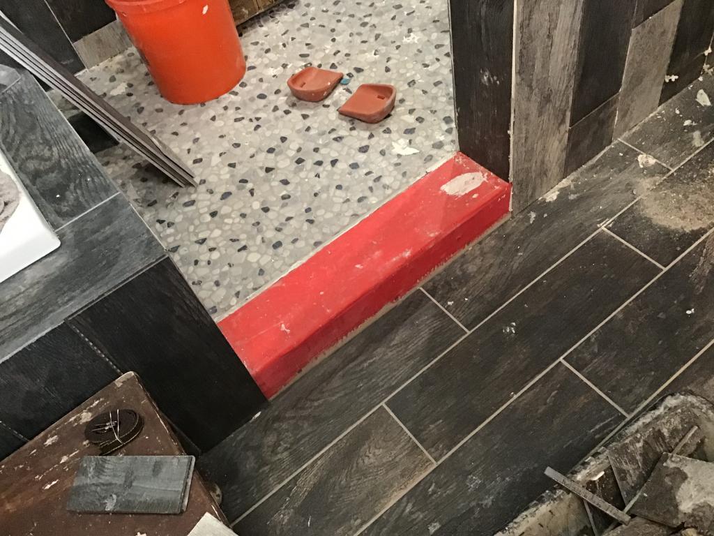

Pullstart 71,455 #241 Posted December 20, 2019 I have the step and a little corner piece to finish! 1 Share this post Link to post Share on other sites

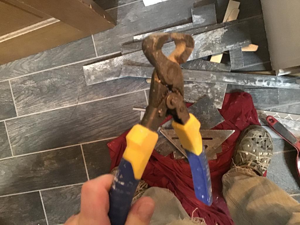

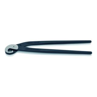

Tractorhead 9,217 #244 Posted December 20, 2019 Cool! btw. To cut out tiles, there are tile pliers available. Here is a pic about what i meant. Round holes are a way easyer to make. but on rect holes i would also do it like you buddy - predrill, but i would cut the parts with a bigger border and finalize later with a tile pliers or a reworked (smaller flexed) pincers in smaller steps to its final measure. That takes more time, but saves some tiles. a bit of loss is normally, i have heard.. 😂 Share this post Link to post Share on other sites
Pullstart 71,455 #245 Posted December 20, 2019 These are here on loan from my mother in law, but I don’t use the. Too much... just little trimming. 1 1 Share this post Link to post Share on other sites

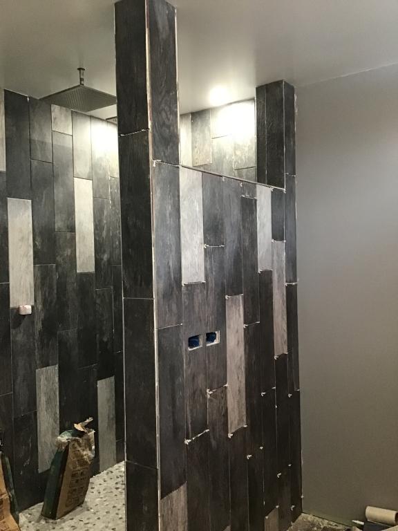

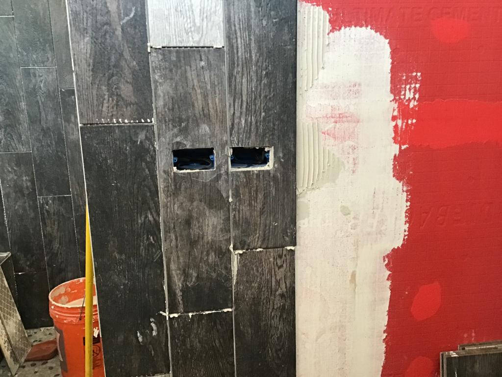

Pullstart 71,455 #247 Posted December 20, 2019 My tiles are laid! It’s time to head to my brother’s place for a Christmas overnighter and let this all cure for a day or two! 1 6 Share this post Link to post Share on other sites

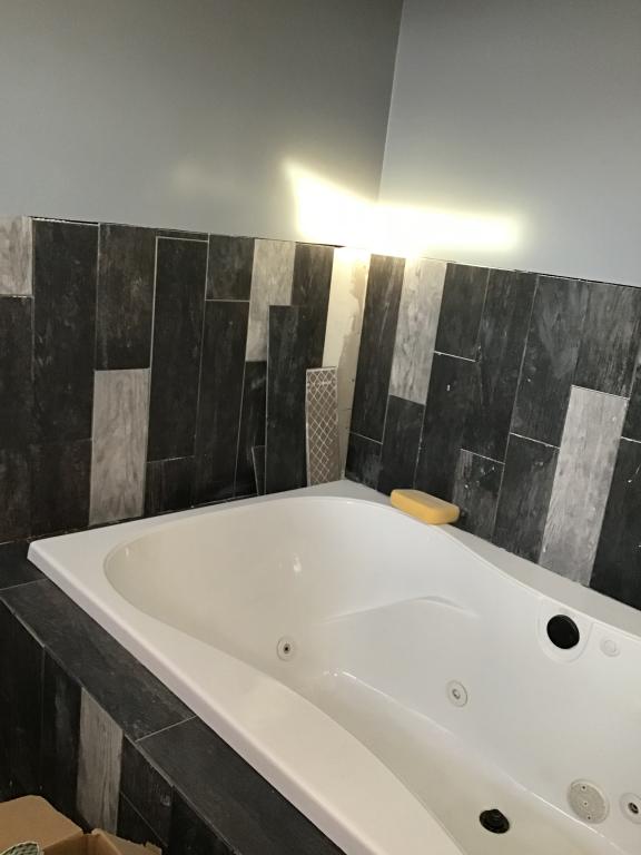

Pullstart 71,455 #248 Posted December 28, 2019 Pushing again after some rest to get this finished up. I am using some old sanding pads to wet sand the haze from the stones. The dark ones are really starting to pop now, but I’ve worn my sanding pads smooth. I’ll pick some more up in town tomorrow morning. 1 3 Share this post Link to post Share on other sites
Achto 32,862 #249 Posted December 28, 2019 It looks like your getting close to finishing. This would be about where most contractors would leave this job site & move on to start another job. Knowing this, it might be a good time to break off now and start on a project. 4 Share this post Link to post Share on other sites
