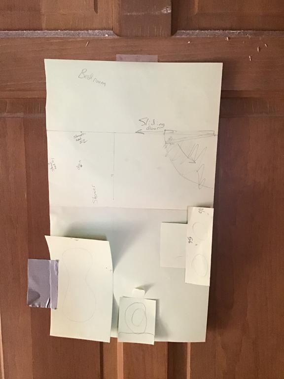

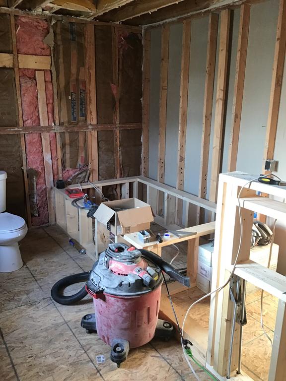

Pullstart 70,146 #1 Posted July 14, 2018 Couple shots of what’s keeeping me from more horsin’ around... The window is being replaced by two daylight windows 50” x 12” on either side of the vanity. The vanity is a 1930’s dresser with copper vessel sinks and I’m building the shower myself. Tub is a 6’ soaker/jet tub. This bath is getting its own water heater and will be tied into the wood boiler for those winter months. Theres room in the corner for a urinal, but I haven’t figured if I’ll fab or buy one. We’ll have in floor heat too. 5 Share this post Link to post Share on other sites

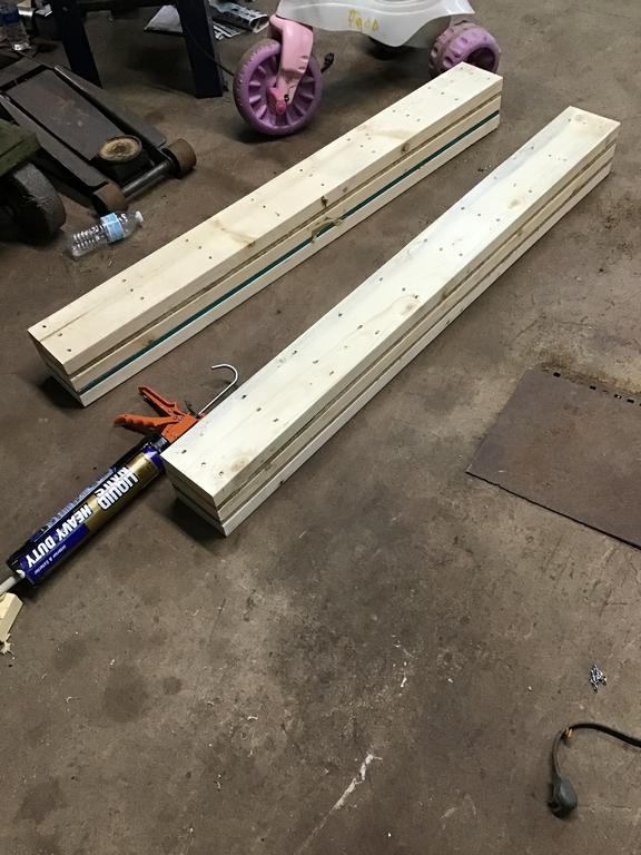

Pullstart 70,146 #3 Posted July 14, 2018 This’ll be the second master she’s let me do it in! BEST. WIFE. EVER. got the headers cut, glued and nailed under the newly LED lit shop. 4 Share this post Link to post Share on other sites

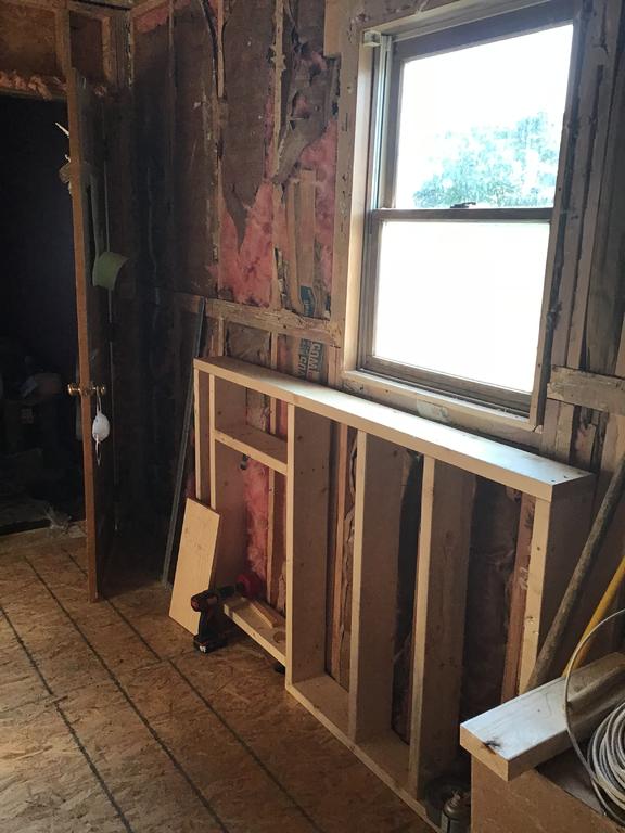

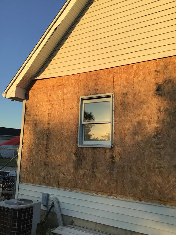

Pullstart 70,146 #20 Posted July 17, 2018 Back at the housework, prepping for some stud work to change the windows around. And apparently add some house wrap! 1 Share this post Link to post Share on other sites
stevebo-(Moderator) 8,681 #21 Posted July 17, 2018 Looks like fun.... lol Share this post Link to post Share on other sites

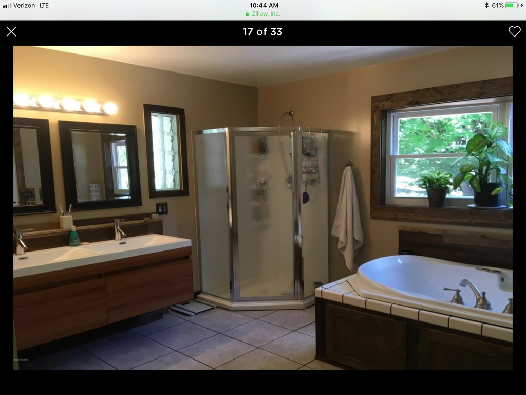

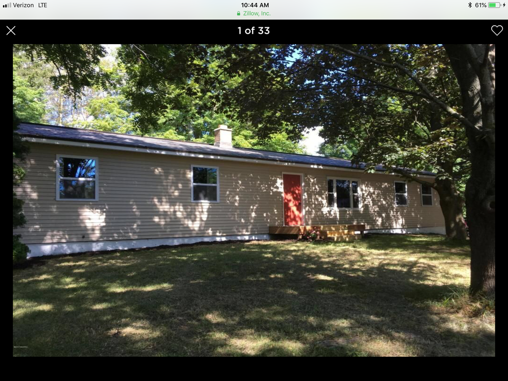

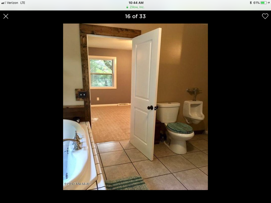

Pullstart 70,146 #22 Posted July 17, 2018 Here you go @19richie66 and @AMC RULES... I pulled these from our old Zillow listing... I did pretty much the whole house. Steel shingle roof, new construction windows, extra foam board insulation, full house wrap, new siding, etc. and of course, a urinal! The bathroom used to be a family room, that big 70” bay window I hoisted up with a home built wooden scaffold and my floor jack. 2 6 Share this post Link to post Share on other sites
19richie66 17,893 #23 Posted July 17, 2018 Nice job brother! 3 1 Share this post Link to post Share on other sites

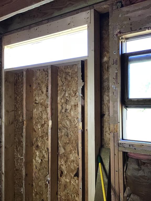

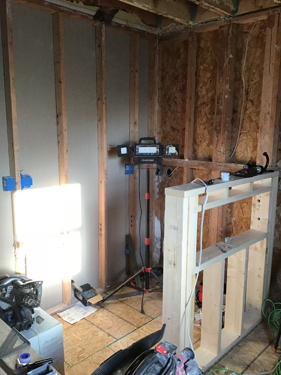

Pullstart 70,146 #24 Posted July 17, 2018 Getting some framing done today! The house is a modular, so their construction style is kind of odd. All north/south walls are non-load bearing, even the exterior walls! It’s like a hallway, with walls stabbed wherever. Need to duplicate this on the other end of the wall, then I’ll knock. The window out and reframe that. 2 2 Share this post Link to post Share on other sites
ebinmaine 79,243 #25 Posted July 17, 2018 Looking good Kev! Share this post Link to post Share on other sites
